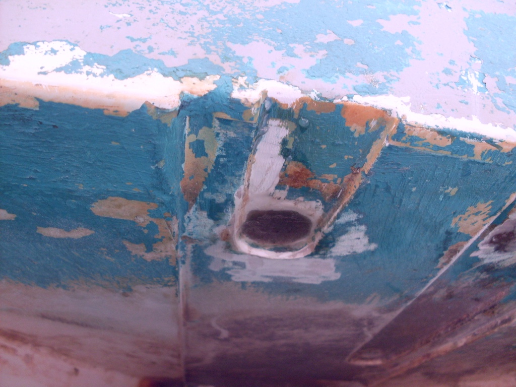

1.) The labor was for machining new bushing's for the centerboard and glassing them in place as well as mechining a new delrin sheave for the housing as well as machining new pivot pins for the board, and CB bracket sheave , installing the board with new uphaul lines etc. Also repairing the centerboard trumk damage by glassing over the five inch hole created when the board broke off, new bottom paint,shipping charge's for the new board from Fla. to Massachusetts etc.

Here is a photo of the nice clean hole caused by the center board pivot pin dislodging. The pin was found inside the hole. There was another 5 inch hole in the hull where the front of the trunk meets the hull.
