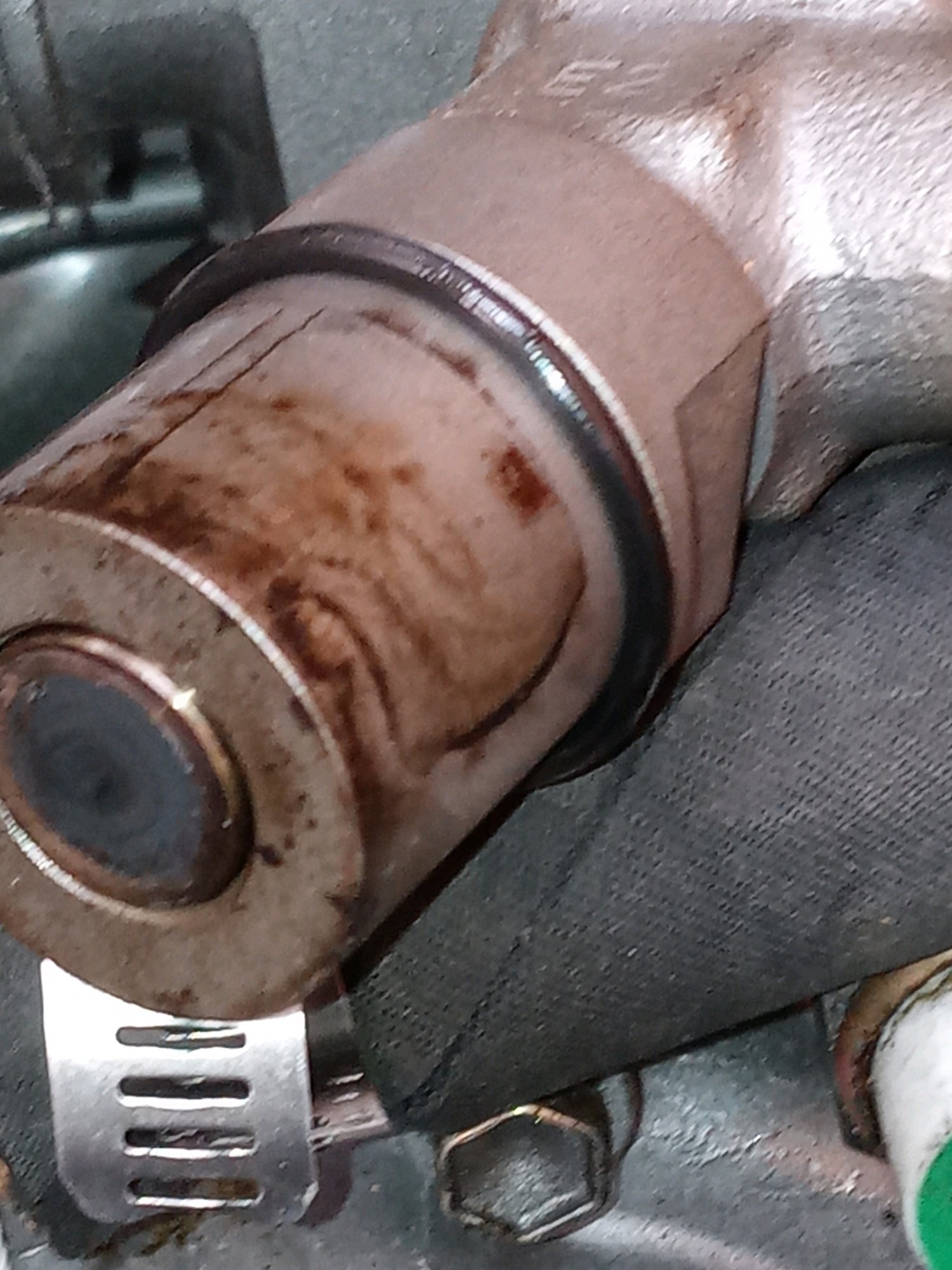

As promised, some follow-up: My mechanic did a thorough inspection last week and found several problems. In order of the attached images, he found:
-what appears to be long-standing leaking around one of the head bolts;
-fuel leaking from the injector holder (or case? not sure what it's called)
-fuel leaking from the bottom of the fuel pump, which was replaced about a year ago.
In addition to fixing these issues, he still thinks the piston rings need to be looked at and I agreed. So tomorrow the engine will be pulled and taken to his shop. As I said before he's a honest guy, he's not charging me for any of the work he's done so far...the clock starts tomorrow when he lifts the engine. So I suppose it could be worse.....
