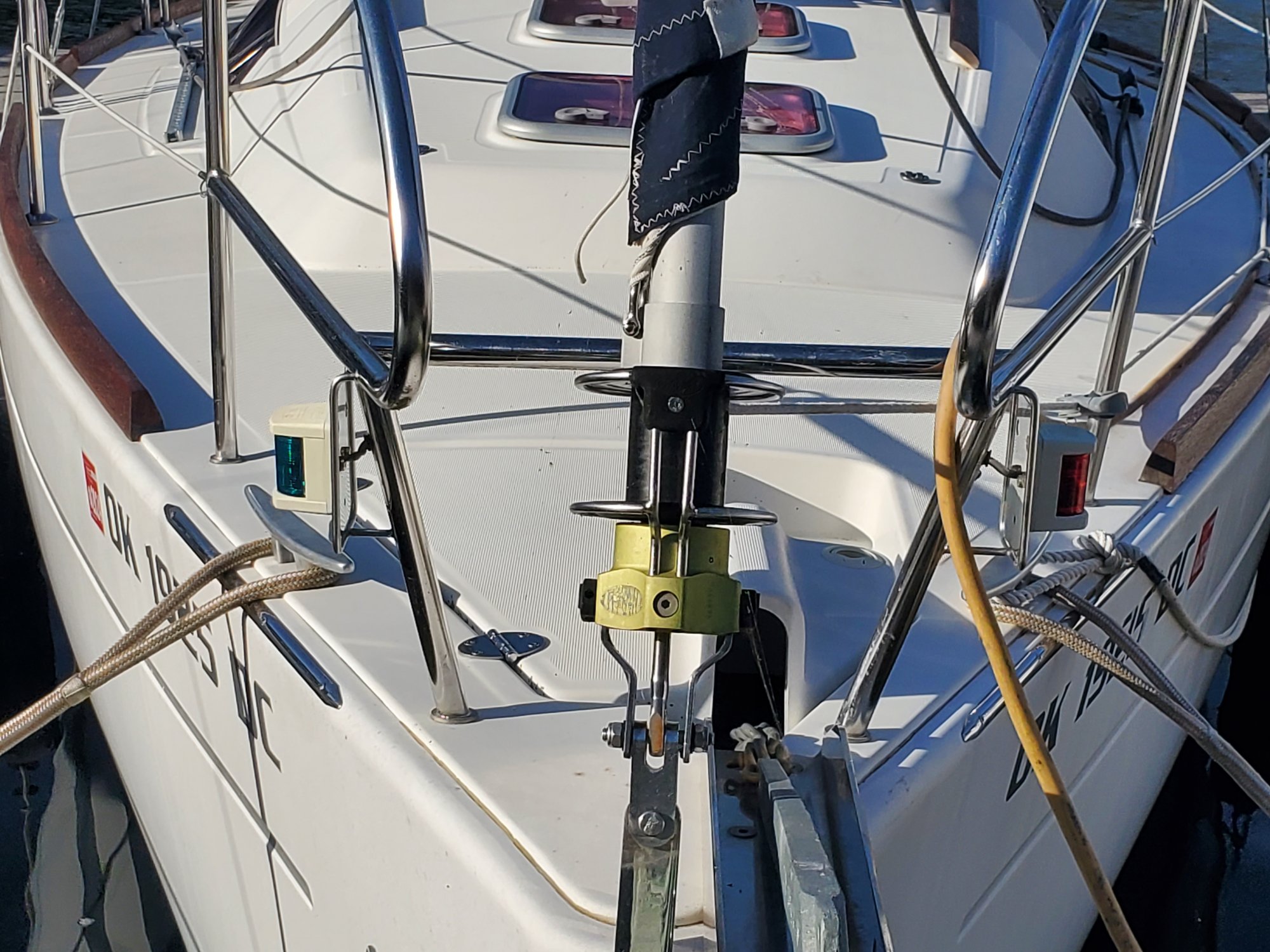

May 17, 2004
6,216
Red light on the 37 is in the top left of this picture. Green one is on the opposite side. Sorry I don’t have any pictures from deck level.
