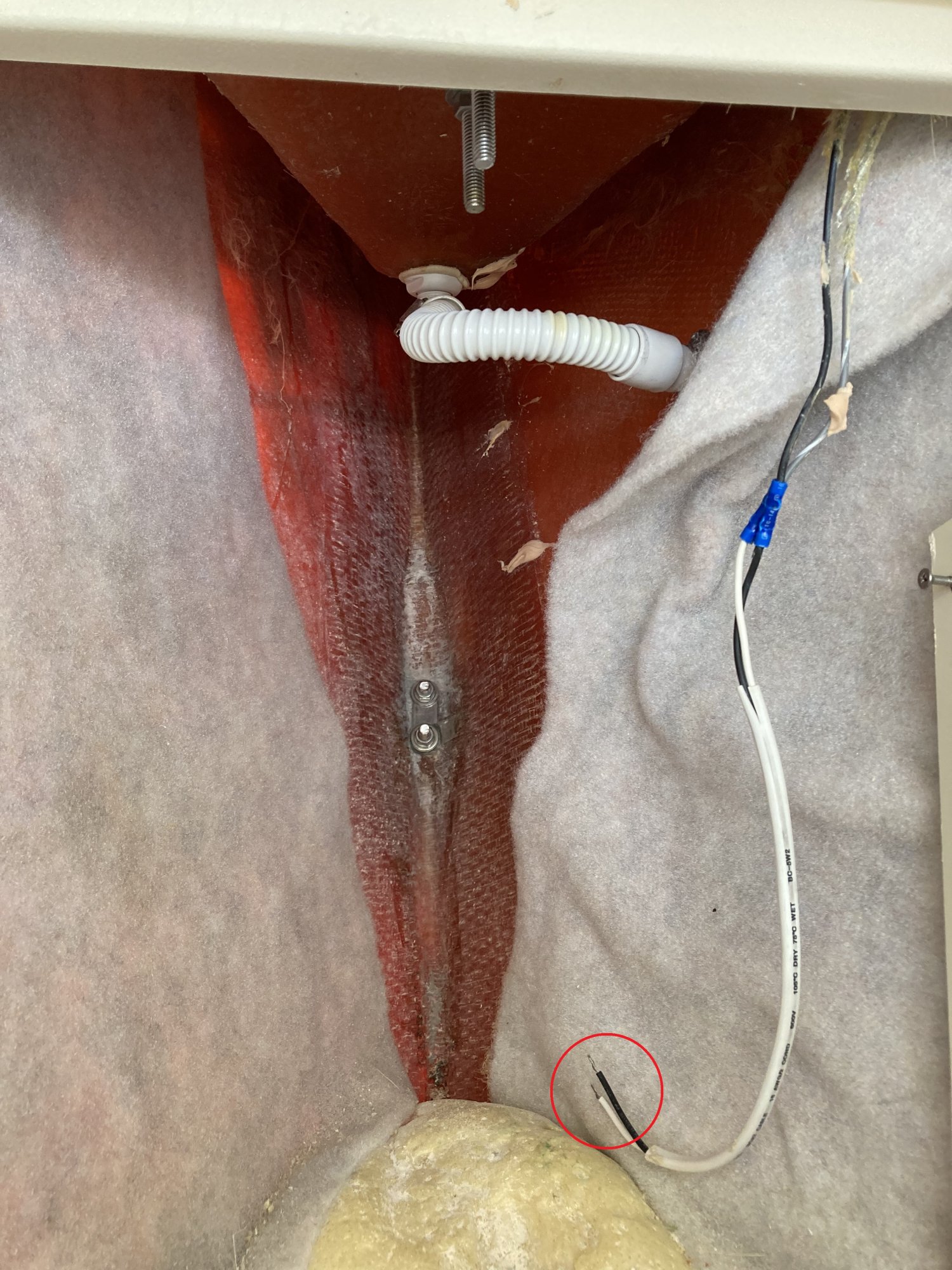

UPDATE

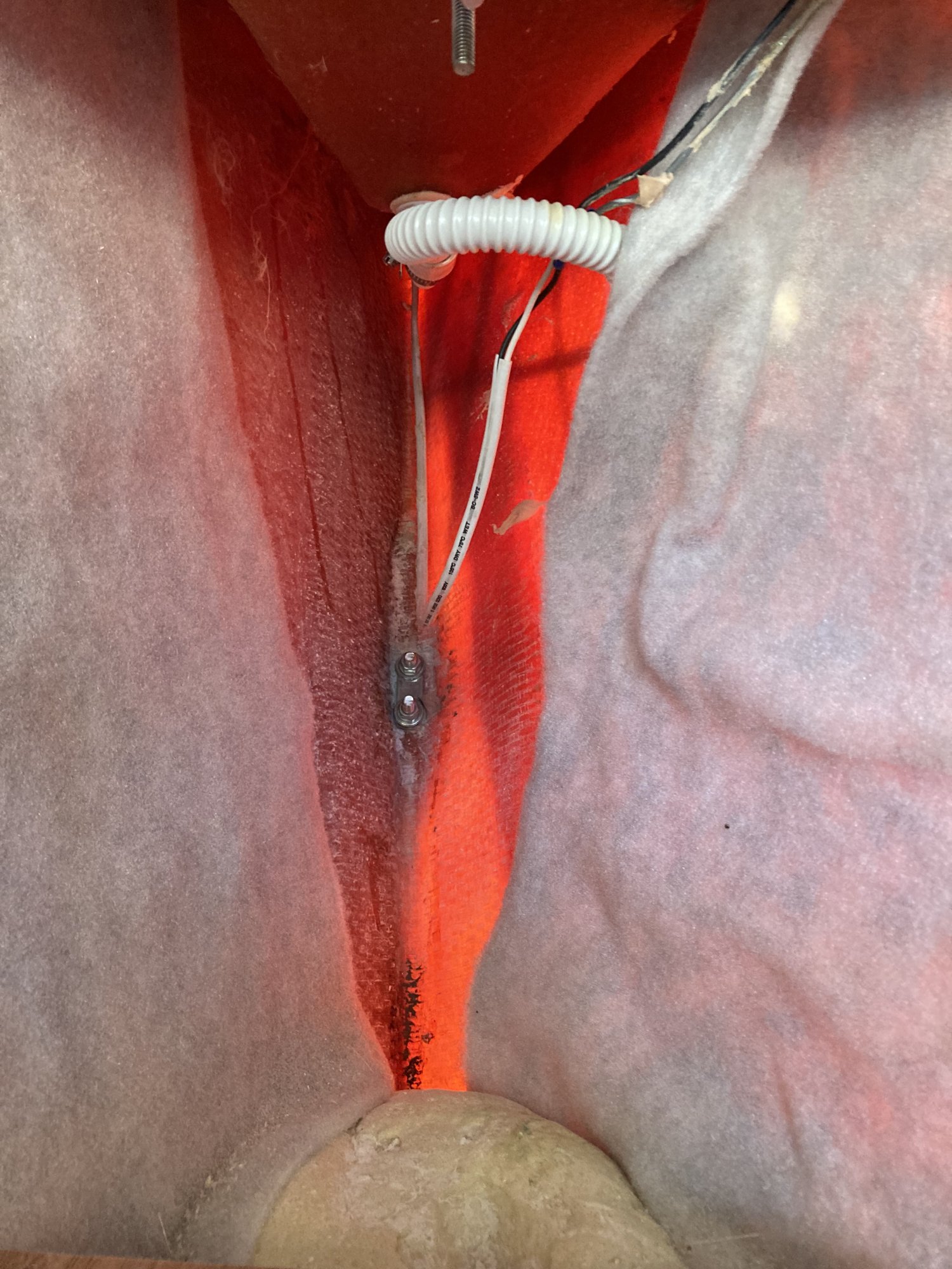

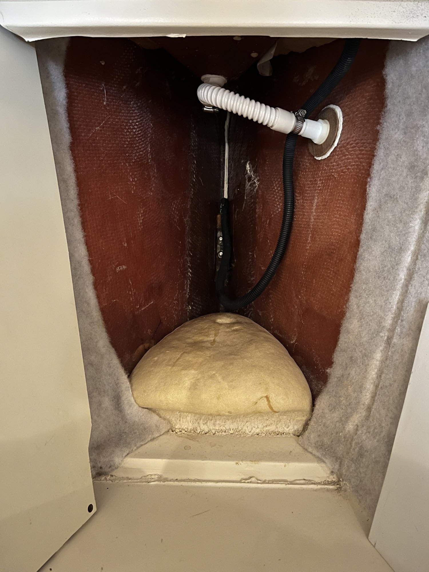

Please help me solve this mystery. I made some progress. Thanks to @GL-WindPower I knew I should be able to find the bow light wire behind the v-berth panel. It was there.
It pokes straight up through the deck right where the front middle tube is for the pulpit. My suspicion was there was a problem with the wire in that tube. (see original post)
I cut the wire. When I flip on the "navigation lights" switch, the wire is hot (circled).

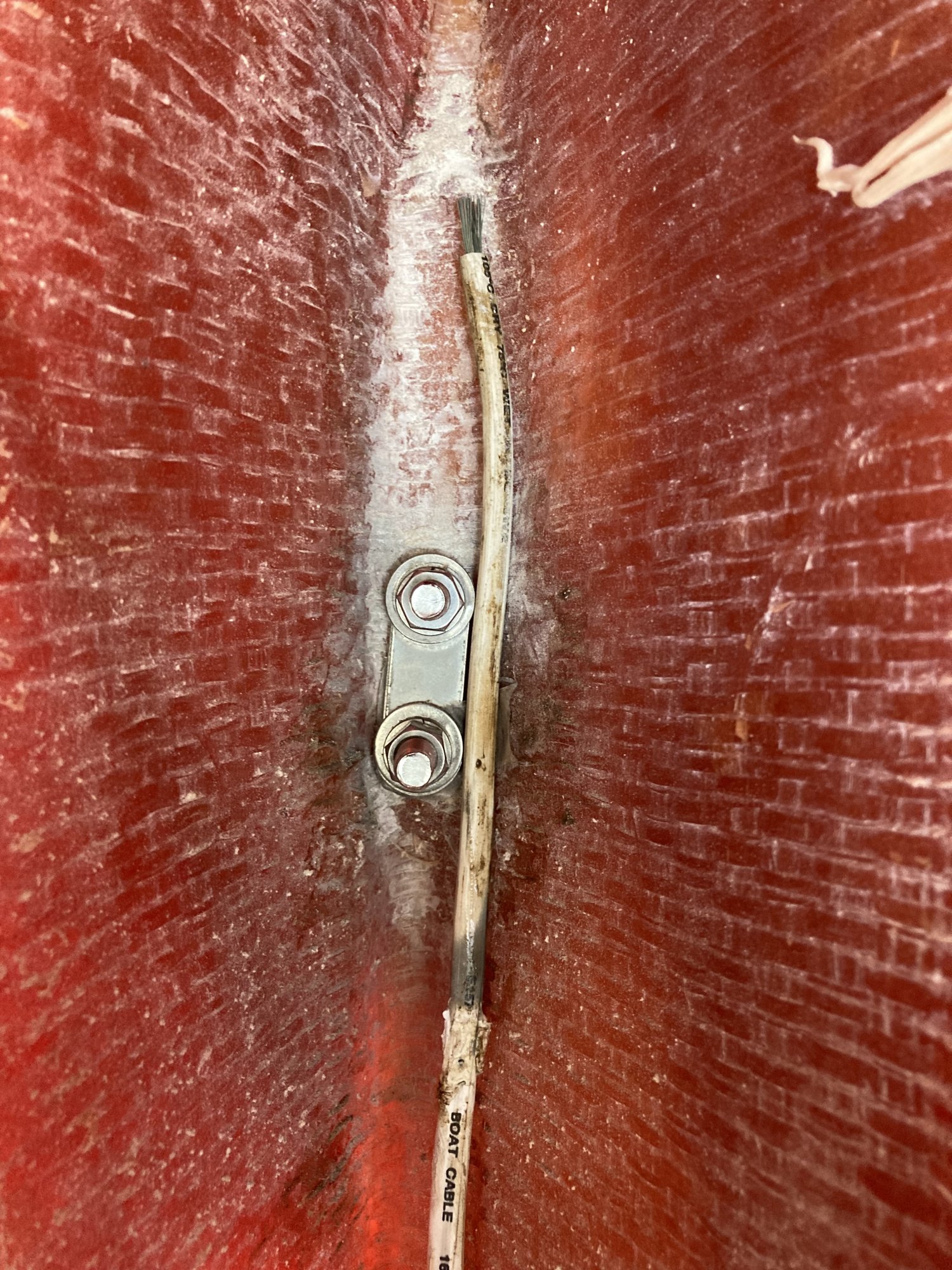

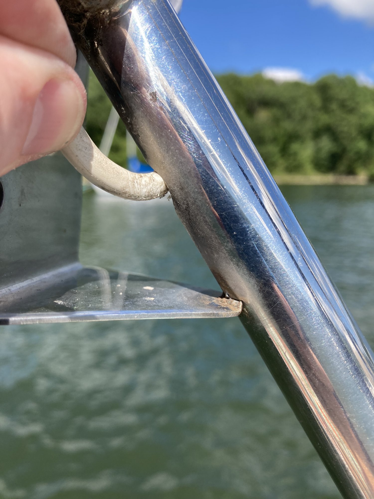

Perfect! My hunch was correct. I have some 16 awg marine wire and heat shrink butt splices. My plan was to pull new wire down from the fixture side using the old wire. But, the wire at the fixture appears to go UP into the pulpit and wouldn't budge. Confused, I pulled down on the wire remnant from inside and 8 inches of wire pulled straight down with clean stripped ends.
I still can't budge the wire at the fixture. I have no idea what's going on.
