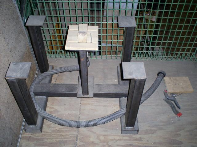

I vacuum form 1/8" ABS in my kitchen oven. This is a jig that sits on the floor and has a vacuum hose hooked up to the bottom. I took the oven rack that came with the stove(my wife loved that) and cut out the middle and welded on angle iron so I could clamp a 12"X15" piece of 1/8" ABS in it. I slide that in the oven at 325 degrees F, for 10 minutes and then turn the vacuum on, pull out the rack and drop it on the jig in the picture. The hot plastic immediately sucks down to the shape of the wood jig head. I then let it cool and trim it with a router with another jig.
The finished product is similar to the platic piece covering that pulley with the cable coming out of the bottom.
