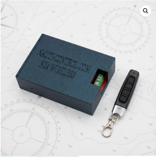

I have been watching eBay and elsewhere for a long time looking for a wireless remote for my Raymarine autopilot. The listings I've seen have always been for more than I wanted to pay so when a post popped up on FaceBook about an open source wireless remote popped up it piqued my interest. I ended up buying the N2K version of Nauti-Control from the company rather than downloading the source code and the PCB design file. I also bought a 6-button 433MHz remote from AliExpress to work with it. The first photo below is the Nauti-Control box itself. It contains an ESP32 system-on-a-chip that has WiFi and a CAN bus controller to interact with the SeaTalkNG or NMEA 2000 network. The board also contains a 433MHZ receiver. When ordering, there are several choices of remote available. I chose the small 4-button remote also shown in the photo.
