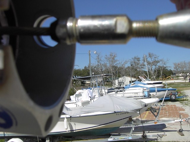

I am replacing my headstay on my Hunter 26 that was installed by the previous owner. The stay has a swaged T-ball terminal fitting on top and a swageless stud terminal on the bottom. It doesn't have any brand stamped on the fitting. Does anyone recognize what brand fitting this is so I can get the right cone replacement? I think I know, but would feel better with a little backup. Thanks, BrianW
Edited: CalebD correctly identified the swageless terminal as a terminal stud instead of an eye as my original post stated. Thanks, CalebD

Isn't what is pictured called a swageless stud? http://www.defender.com/product.jsp?path=-1|118|107602|297595|312099&id=136088
That is the turnbuckle body beginning on the right side of the picture, no?
As for the brand, I am no expert but it may just be old enough to be hard to get the exact replacement. You might just think about replacing the entire turnbuckle and fittings (jaw/eye etc). Norseman is pretty easy to use but yours looks a bit more like a Sta-lok fitting: http://www.defender.com/product.jsp?path=-1|118|107602|297595|312099&id=205152

You can take the old one off, and send it to any local rigger; if you don't have one, send it to Cliff, at West Marine rigging Seattle. I'm not a West Marine booster by any account, but Cliff does a great job.

Yes, the swageless terminal stud is connected to a turnbuckle on the right. I believe the fitting is less than 5 years old. (I posted a long sad story about a month ago on why I had to replace a forestay when it was only 3 years old. Thread name:"Forestay Woes"). Thanks, BrianW

If the fittings are about 5 years old then they can likely be reused with the caveat that SD mentions that a trailerable boat (ie., rigging set up and taken down more frequently) may suffer more abuse to these fittings/parts then a boat where the mast is left up.
If the Sta-Lok is like Norseman then it should be able to be unscrewed (there may be some 3M 4200 in there) but you should likely consider getting a new jaw or jamb piece from Sta-Lok (they will likely want you to buy a new everything though).
