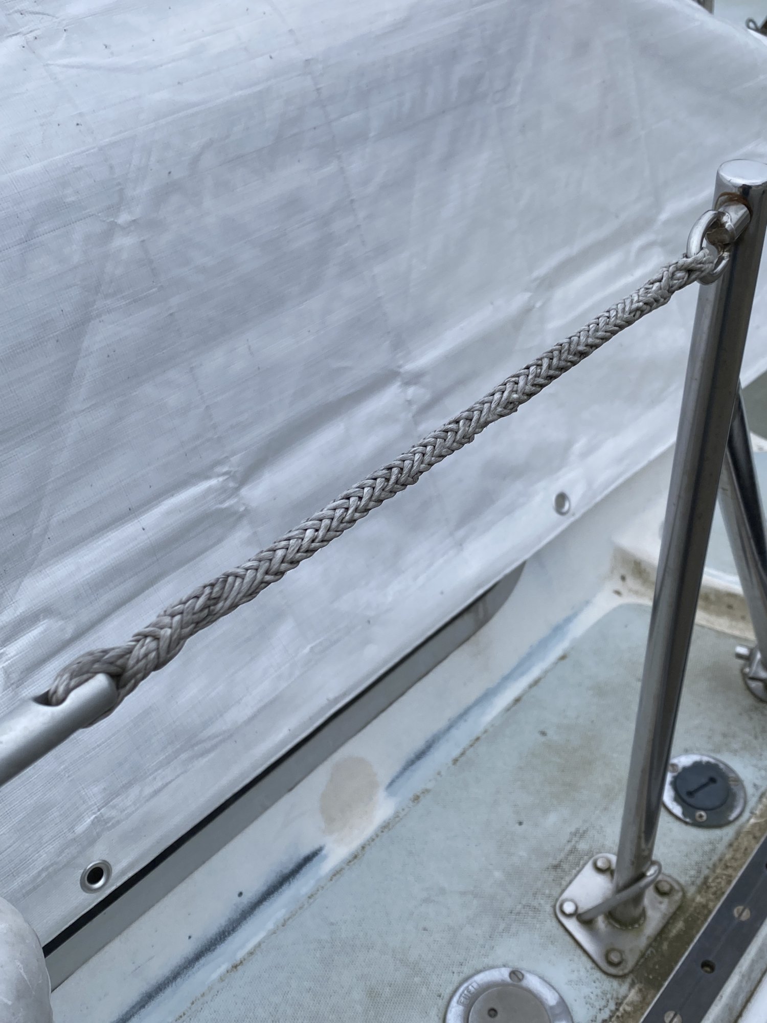

24,745
I installed dyneema gates on Hadley in 2015. They are 1/4 inch diameter line with the ends long buried. They are holding up well for 10 years exposure.
Love the way they hang down along the stanchion when the gate is open.
