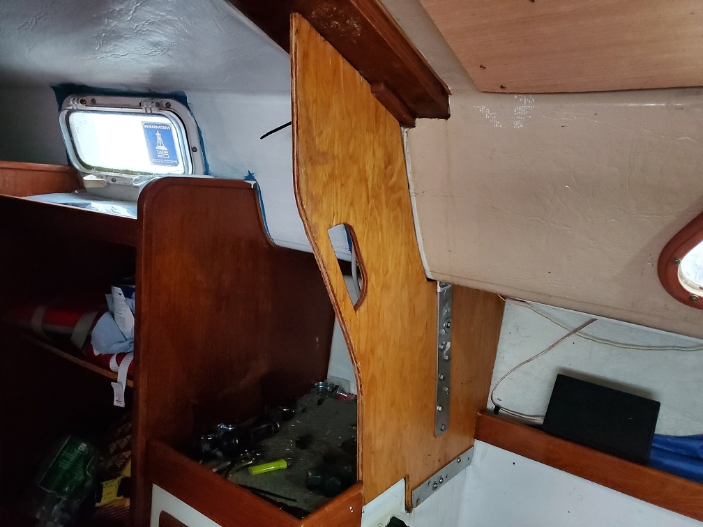

Still no launch for me, for a few reasons. First, I found the starboard bulkhead had rotted, due to failing sealing around the chainplate over winter. I went up this weekend and planned on replacing it with 1/2" marine ply sealed with Epoxy. It appears the original was 7/16 instead (is that even a thing? but that's what it measured, and the the new is definitely a tighter fit). However, as I let it sit over night to soak in and cure, it started pouring again, so I didn't get a chance to do anything else on my list - like run new halyards and cut other pieces into new companionway boards, and maybe a new table. But can't really cut things out in the rain.

This weekend, and next week off, I should at least be able to touch up the bottom paint, get the chainplate sealed with the bulkhead bolted tight, halyards changed over, last stanchion placed, maybe get the bow pulpit repaired, interior repainted. Without being in the water, I'll have plenty of time to work on things.

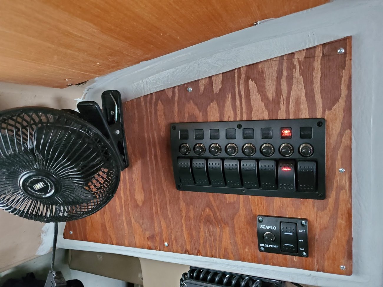

I got the battery situation figured out now, as far as mounting goes, which will be done in another week or two. They're temporarily in place in the meantime, and the panel hooked back up sitting in the cockpit. And the fun part is I found a Schulink Wireless Battery Monitor at Wal-Mart on clearance that I wanted to try. It hooks up to the marina's WiFi network, and allows me to monitor it from anywhere via an app. I figured a) for 20 bucks why not, and b) even if just a rough idea, it's still a way to monitor the boat from 3 hours away. I figured out the anchor roller too. I'll be removing the starboard bow chock off the rail, and glassing the anchor locker lid in place, and over. A small opening cut in the rear for access, and a hawse for the rode, and then I can mount the roller there for the Rocna to sit on. A plan for warmer weather, at least.
