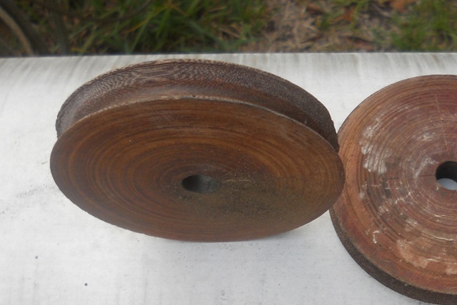

The original sheaves are this style (not mine exactly, but the same kind):

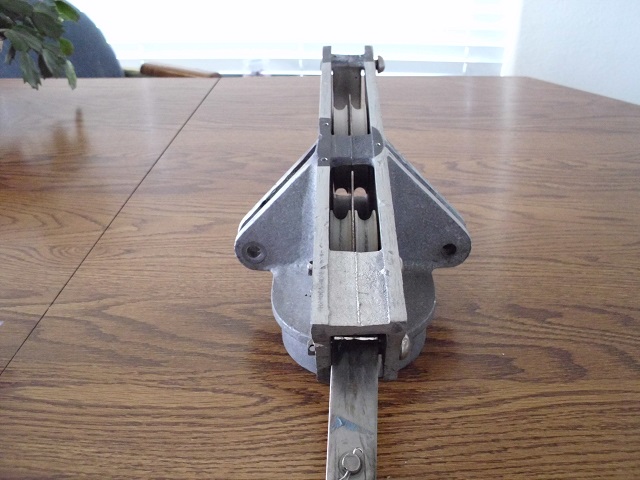

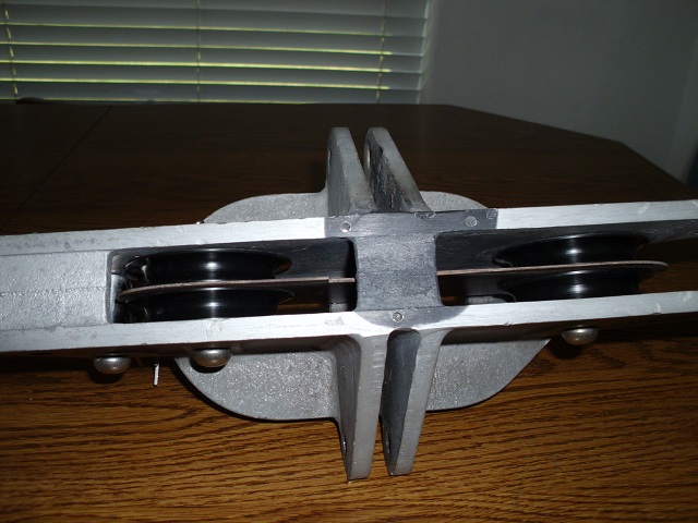

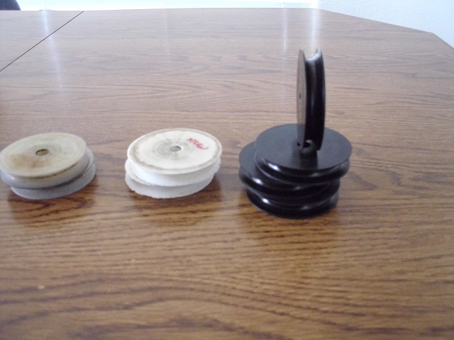

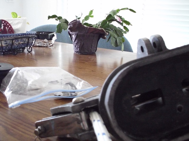

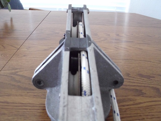

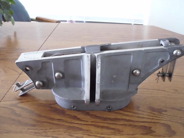

I had looked at Zephyr's sheaves, and if I did not have the old 9x20 lathe, I probably would have bought them from them. As it is, there are a few differences between your mast head and mine. Where your mast head fits inside your mast, mine fits over the outside of the mast. Otherwise, the mast heads appear the same. I do not know if you have a larger size mast than I do, or its a different model mast head, but they are different.

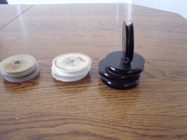

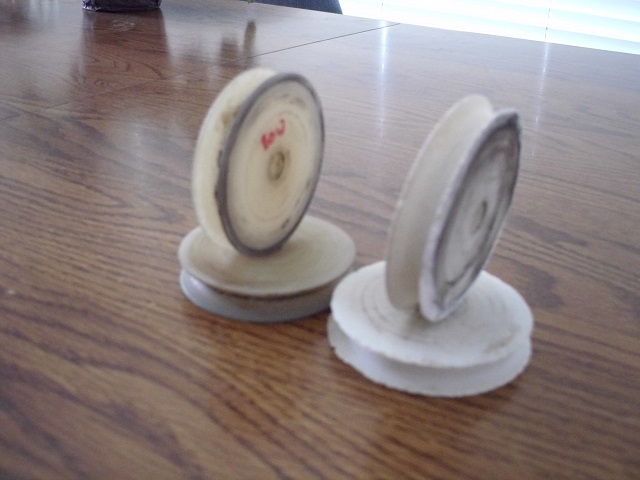

Now the sheaves are and interesting situation. I had two different size sheaves (fore and aft), they were made from different materials, and the grooves were cut differently. The fore sheaves appeared to be made for either a cable of a smaller line and were 2.76" diameter. The rear sheaves were cut for 3/8 line and were a larger diameter, almost 3". Anyway, I determined that 2.75" would be a good workable size and grooves .3" deep. Not exactly what a rope sheave should be, but due to the thickness, it worked out ok. The other thing I have discovered, is that I need to cut the grooves in the front sheaves about 0.1" deeper. The reason is that the line rubs on the middle top webbing, and still rubs on the back side of the forestay tang. Not as bad as before, but I do not want any rubbing. I have about 0.2" clearance between the line and the rear of the mast head, so I have a little bit of room to work with. I will have to make up a mandrel to cut the grooves deeper as they have already been parted off the base stock.

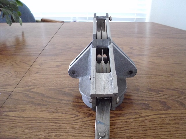

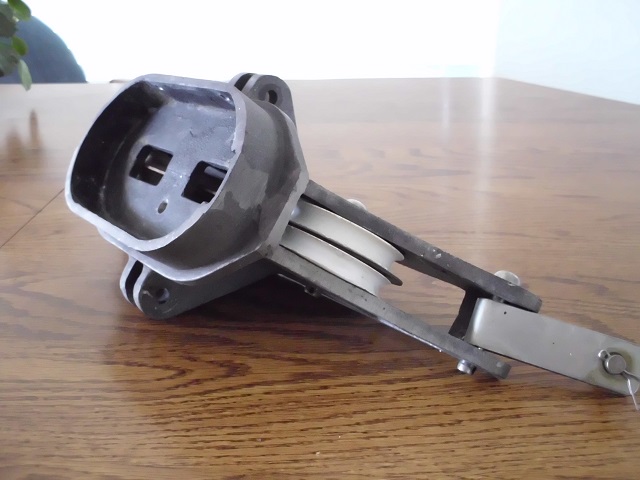

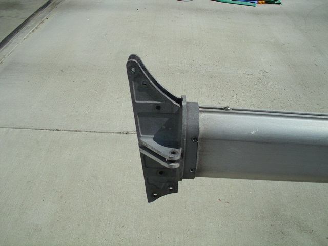

I have attached some pictures to show the original and current configuration of the mast head. There is additional mounts that will be reinstalled for the antenna and anchor light, but they are not in the pictures.
