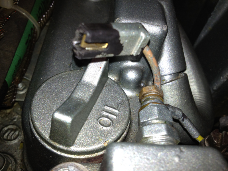

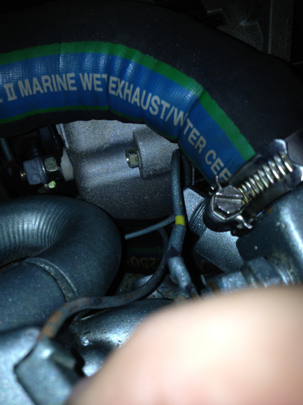

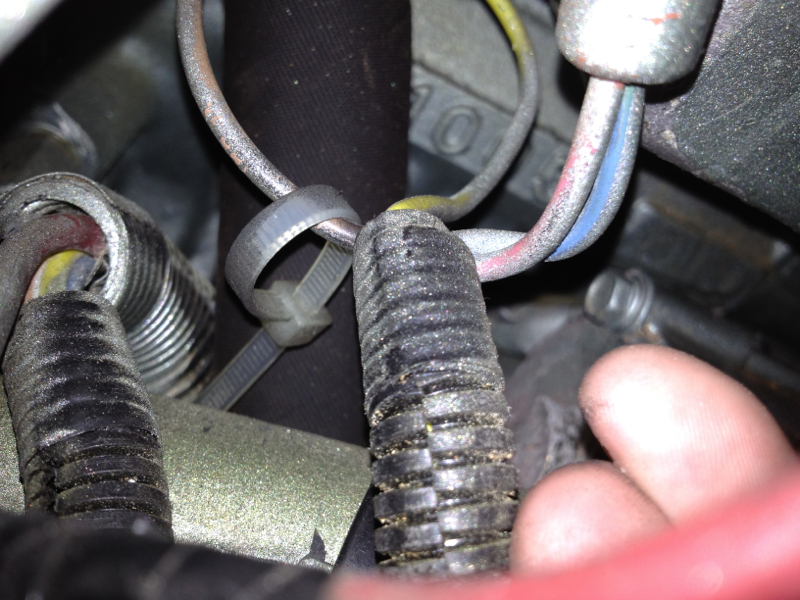

1. There's this wire that has been laying on top of the engine (Universal M25XPB in a Catalina 310) since I bought her. It's pictured below. The engine and instruments/gauges work fine but curiosity has got the best of me. It must be for something but I cannot find anything it connects to. It is orange or brown in color and comes out of a harness. The other wires that come from the harness are pink and lt blue (to alternator) and yellow (to water temp sender). Looking at the DC diagram for the engine and the boat itself I cannot figure this one out. Any suggestions? Pics are below.

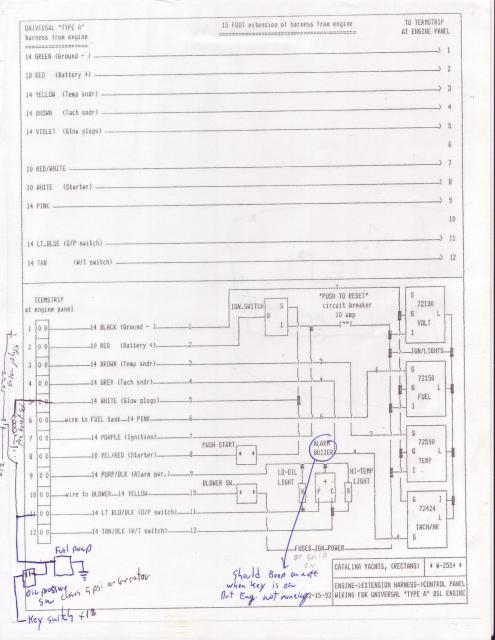

If it is orange it could be the old wire from the alternator to the ammeter (#4 on the diagram) that has since been rewired to eliminate the excessively long run between the alternator and the battery.

I know the wire you're referring to, it connects to the stud for the coolant temp sensor right next to it in your first pic, (slides on at a 90deg. angle on the top of the stud). The sensor appears to already have a wire on it, may be the ground wire. I also believe that the alarm (which is really a 24 volt alarm running at 12v, poorly chosen for the application), should produce a solid on sound with low or no oil pressure (as when the engine is cold and the key switch is first turned on), or produce a pulsing sound when it is over temp. Because the alarm is working at under voltage already if your battery voltage is low, it will cause the alarm to be weak and intermittent.

Yeah. It was lying right next to the sensor but there is no place to connect it. Maybe the connection broke off. I have found that most of the wire connectors on this engine (e.g. Oil sending switch) are extremely delicate. The yellow wire (which is on the sensor) is definitely correct according to the manual. Everything runs fine but it's one of those things that will be constantly on my mind!

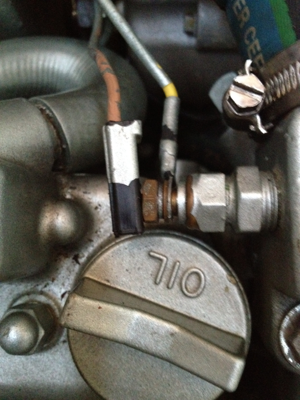

No, it is not broken off, just slide it on at a 90deg angle to the top of stud. We had a great raft up on the Chessy this weekend with (4) 310s, and one of the other 310s also had it disconnected, but did not notice any alarm problems? I reconnected it for him...poor design.

Like that?? Looking at the terminal on the wire, that's the only way it would work.

It is called out as the" Water Temperature Alarm" on the M25XPB break drawing for the fresh water cooling.

In reviewing the schematic this is a hi temp switch that shorts to ground when a threshold temp is reached and sounds the alarm. So with it disconnected it should just not be able to sound the alarm if over temp, which would not be the reason you are chirping. Can't imagine it could prevent the engine from cranking.

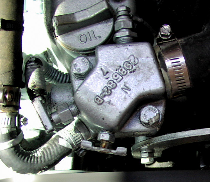

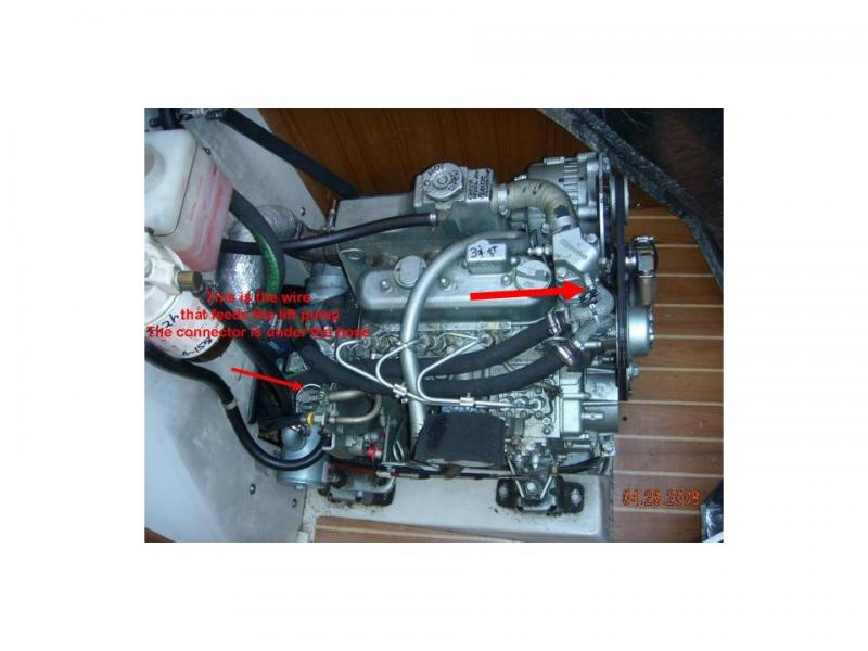

I found a pic of my engine. I had you have it connected to the wrong sensor. It actually connects to the one on the other side of the housing see pic.
Sorry for mis-leading you, I became confused between the two just looking at the pics.

Feb 6, 1998
11,772
Hey Jack,
Bingo, but it goes on the opposite side of the t-stat housing..Here's a pic...
