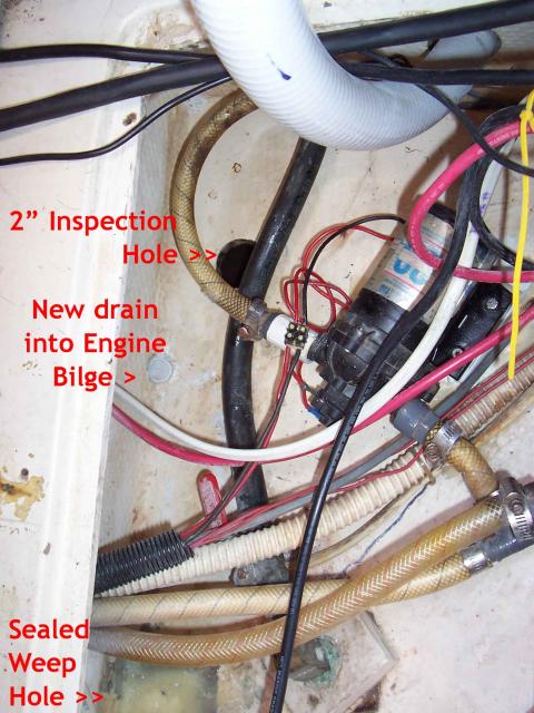

During our recent haulout, we pulled the water pump from its spot under the horizontal locker cover inside the starboard lazarette, rebedded and re-attached with a new base.
At this point we noticed a tiny bit of WET at the very aft corner of this space. Apparently there is another level under this one, where there is a small space that seems like it was designed to be sealed. On our hull, the fiberglass seems to not have met all the way up with the aft seam and bulkhead, resulting in a tiny weep hole, where a tiny bit of water would slosh aft intermittently.
We drilled a 2 inch hole into this trapped compartment, only to find it full of old trapped fresh water -- one of our bolts on the hinge of the lazarette would leak in a few drops if it rained heavily -- and apprarently these drops had gathered and could not get out. :doh:
I sealed the tiny gap at the aft end of the water pump level, and vacuumed out the water from the hole we drilled, and we've been drying the inside of this small compartment with a hair dryer on a low setting.

The space inside this area is completely dry at this point, except for a thin film of pasty dry slime on the "roof". I have poured about 4 cups of polyester resin & catalyzer in the hole, over 3 days (yes, to avoid any heat related issues) and it is building up nicely inside. Still seems like I have about 3 inches to go to reach the roof. Think War & Peace in large priint hardback type space. It does not drain anywhere, as it seems that it was intended to be sealed.
I have put a drain in place in the level/space below the main floor/sole of the laz -- the space that holds the fresh water pressure pump and seacock for the head. This now drains into the bilge.

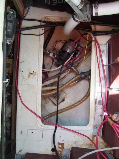

I'll try and get one later...easy to get to...open (stbd) laz...look straight down...remove wooden floorboards/locker cover...look straight down...the area which levels out from the hull is the top of a trapped compartment below. Roughly triangular flat base, comes off the hull to stbd, and abut's the engine compartment wall to port. Abut's to the head bulkhead forward. When you pull the floorboard/locker cover and look below, inside that space, look all the way aft and make sure that flat "sole" does in fact seal all the way aft to the perpendicular face of the supporting wall for that space. If you have a weep hole just before it touches the aft wall, then you may have the same situation.

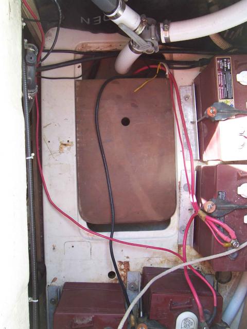

Got pictures of compartment under Starboard Lazerette
There is another floorboard that goes beside the one pictured but since I haven't finished with all the electric cable clean up...it's not in, but hopefully these should make it clear anyway.
