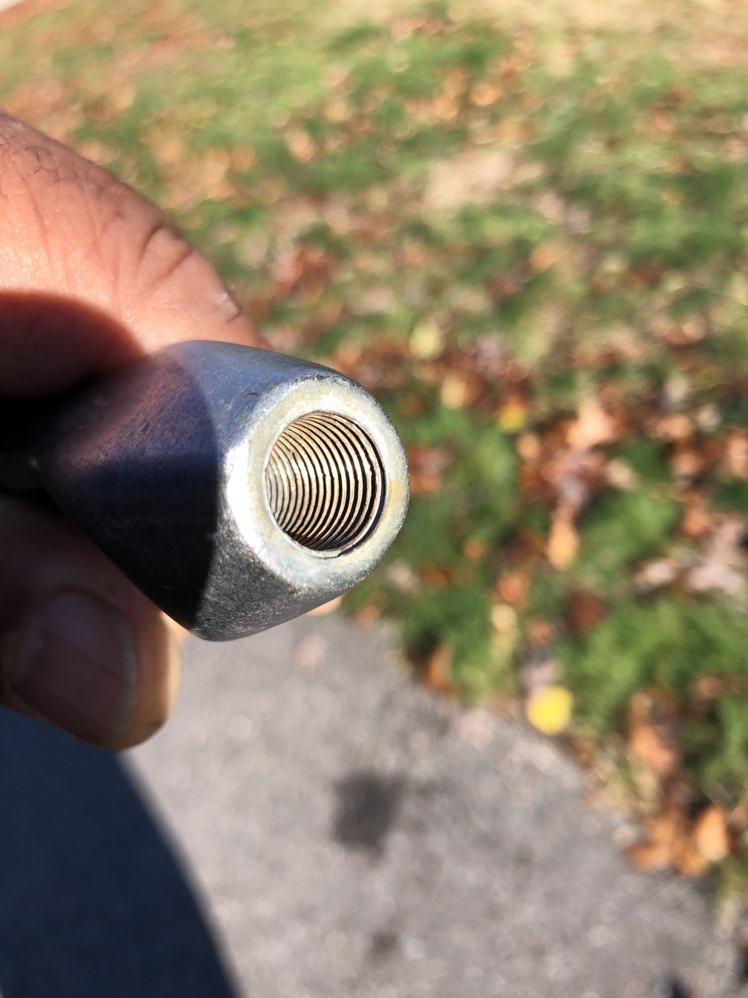

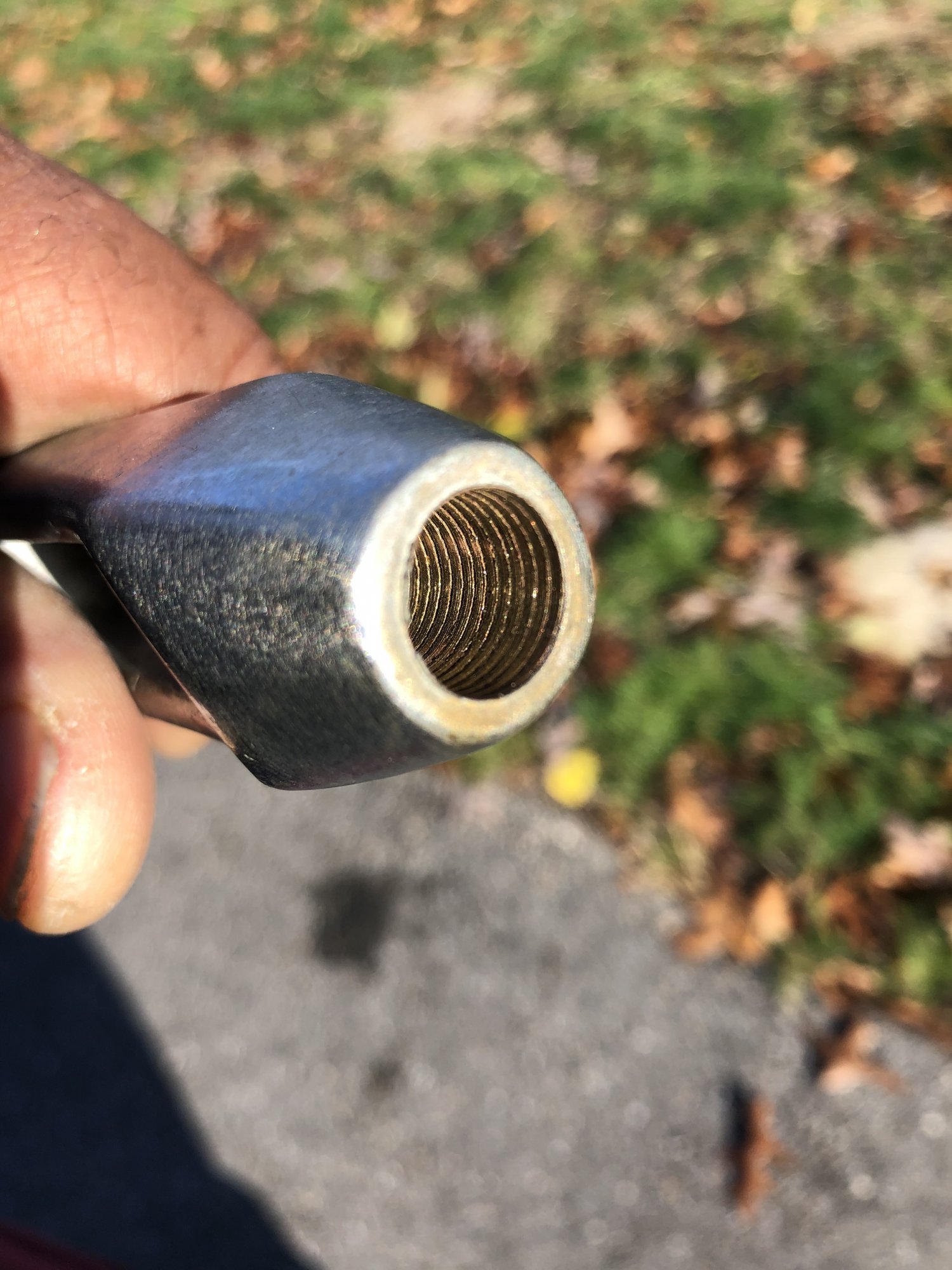

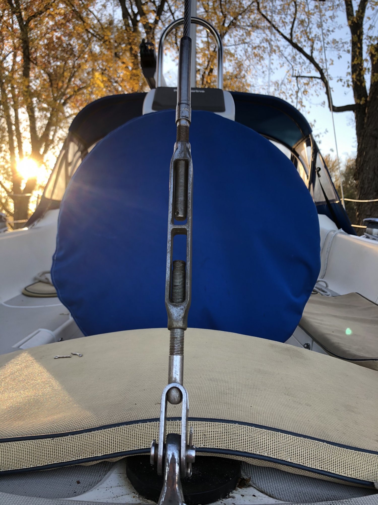

Thank you for all the responses, collectively your responses are making me a better, more knowledgeable sailor. Continuing on with this thread, I will try to answer all questions posed. First, we have owned Faster Horses (FH) for 7 years now and although I maintain a current relationship with the PO, we have not had the discussion as to the age of said rigging, I am sure to have that conversation soon. The first time this incident happened, luckily enough we were on the Conn. river on our way to our summer mooring. I have attached more photos with the hopes of settling down those of you in disagreement and providing a clearer picture. The replacement turnbuckle in the picture is what the yard mechanic had on hand. I have no idea who the manufacturer of either of the 2 failed turnbuckles are, and I would like to know how to determine who makes a good one. Since we have owned FH, we have unstepped the mast only twice and have had the rig tuned 3 times, the first time we did it ourselves but since have had a rigger come to the boat while she was on our mooring twice. When FH is hauled, it is necessary to release the backstay or forestay, depending on the position of the travel lift. I know that there are some marinas that have travel lifts that can accommodate vessels without having to disconnect a stay, ours is just not one of those. Our plan is to have the rig inspected, however, we will probably wait till the spring and have the mast unstepped in order to do so.
