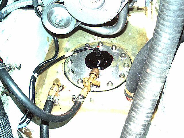

Stu,
I installed Wema fuel and water gauges in our tanks back in 98 or so. They have been working just fine ever since. The senders are a tube that slips into the tank and can be changed easy.
Fuel tank sender in photo, in the fuel tank clean out port;
I did have one (1) water tank (I have 2) sender hang up at full once. But as soon as I his a bit of rough water on a sail it jumped back to working just fine.
Greg
