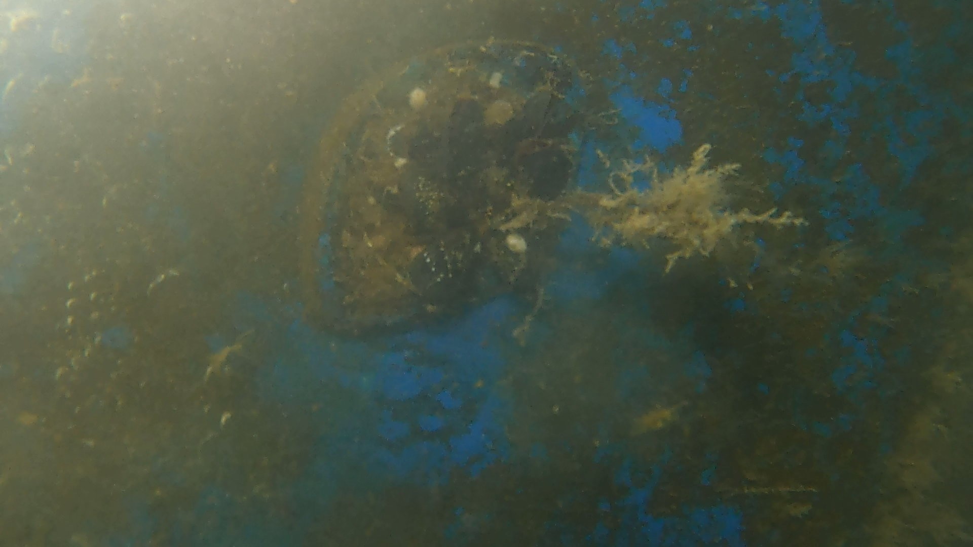

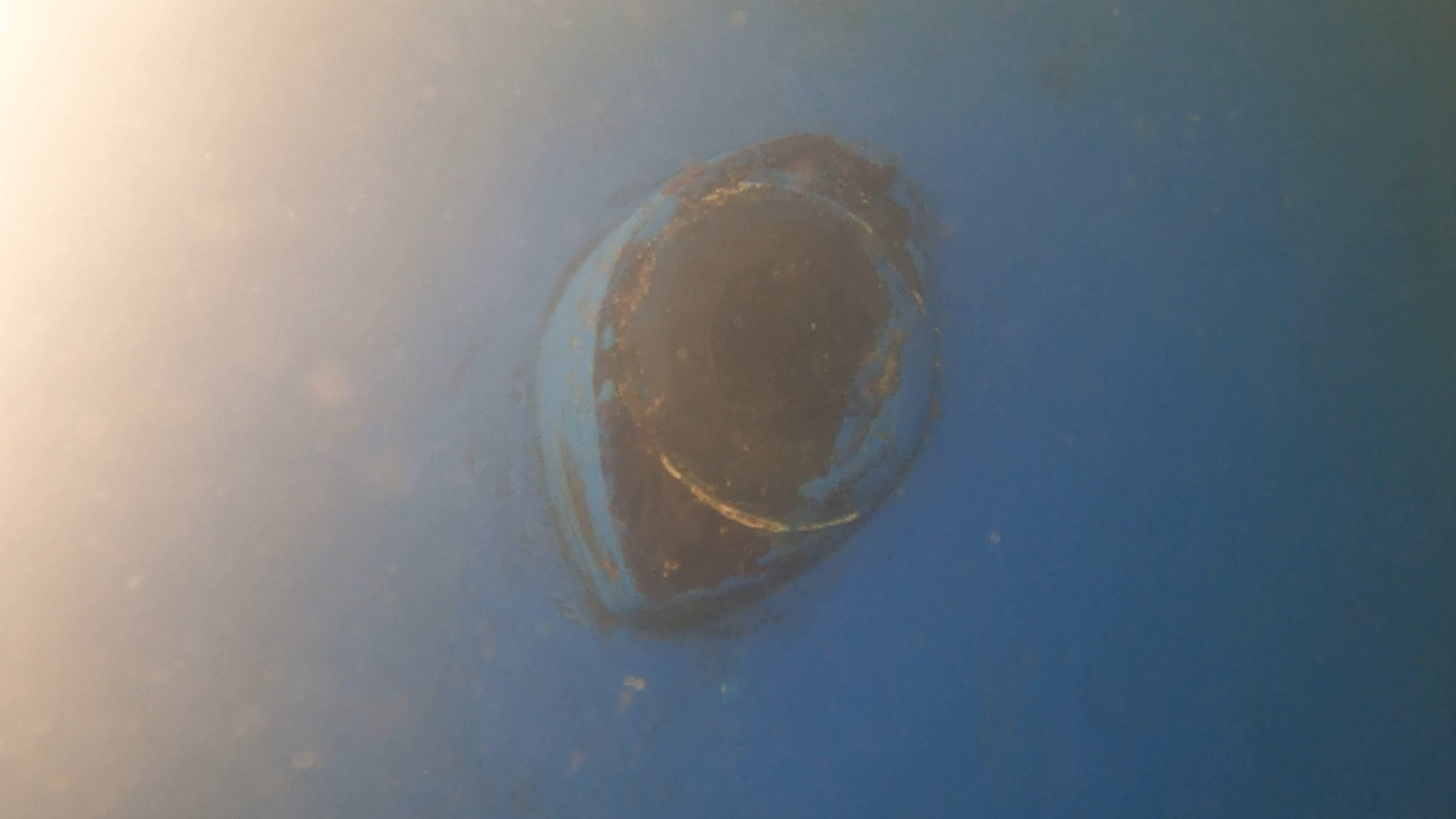

What paint do you use? I use Pettit Trinidad which is a hard paint. The first couple of years, the slime blocker keeps it completely clean although I still dive the boat every 6-months for zinc and running gear cleaning. The next 6-7 years see a gradual increase in the amount of slime that will aquiter but most of it washes off if I am sailing a lot and it always comes off with just a single swip with my favorite hull cleaning tool which is a blue scotch brite pad on a D handle. It is about4x6 and easy to hold with dive glove. I repaint when I begin to see any type of hard growth which is always mussels that get covered with barnacles but that doesn't happen until year 8-9. I have always had some small areas on the lead of the keel that liked to grow hard stuff but that is kept mostly at bay with twice yearly cleaning. My last haulout, it stripped the keel and refaired it and that fixed most of that issue.
I have never tried an ablative because my marina will not allow diving on a boat if you make a paint fog in the water. The Trinidad does not come off when scrubbing it. I get a cloud of brown scum but no blue paint die.

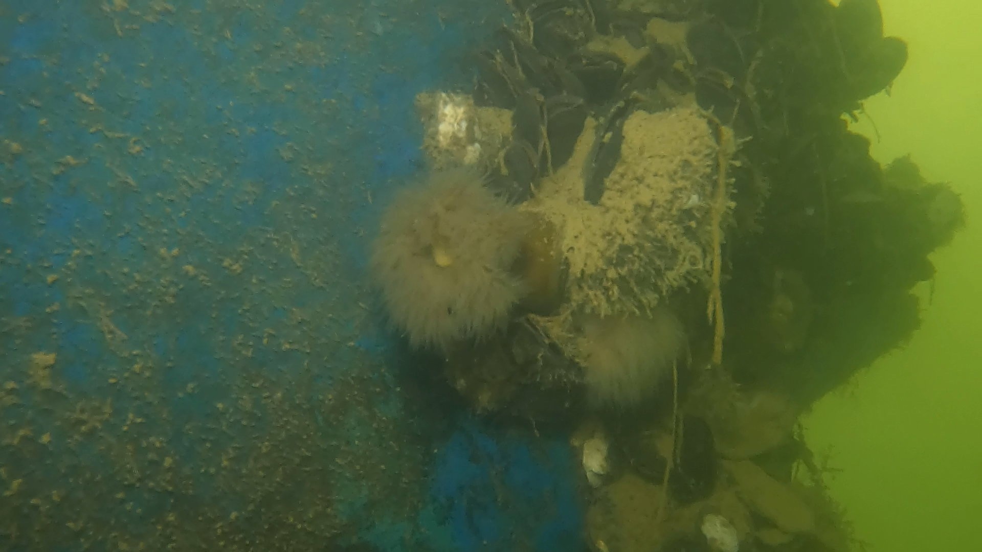

Last year was to total washout for sailing to to life. As a result, Papillon went a full year between dives. The boat was last painted in October of 2022. This was November of 2025 with 12 months of growth.
This is about as bad as the fiberglass hull it gets after 12 months. I am ashamed to say that I only got Papillon out of her slip twice in 2025, once in may and another day on late June.

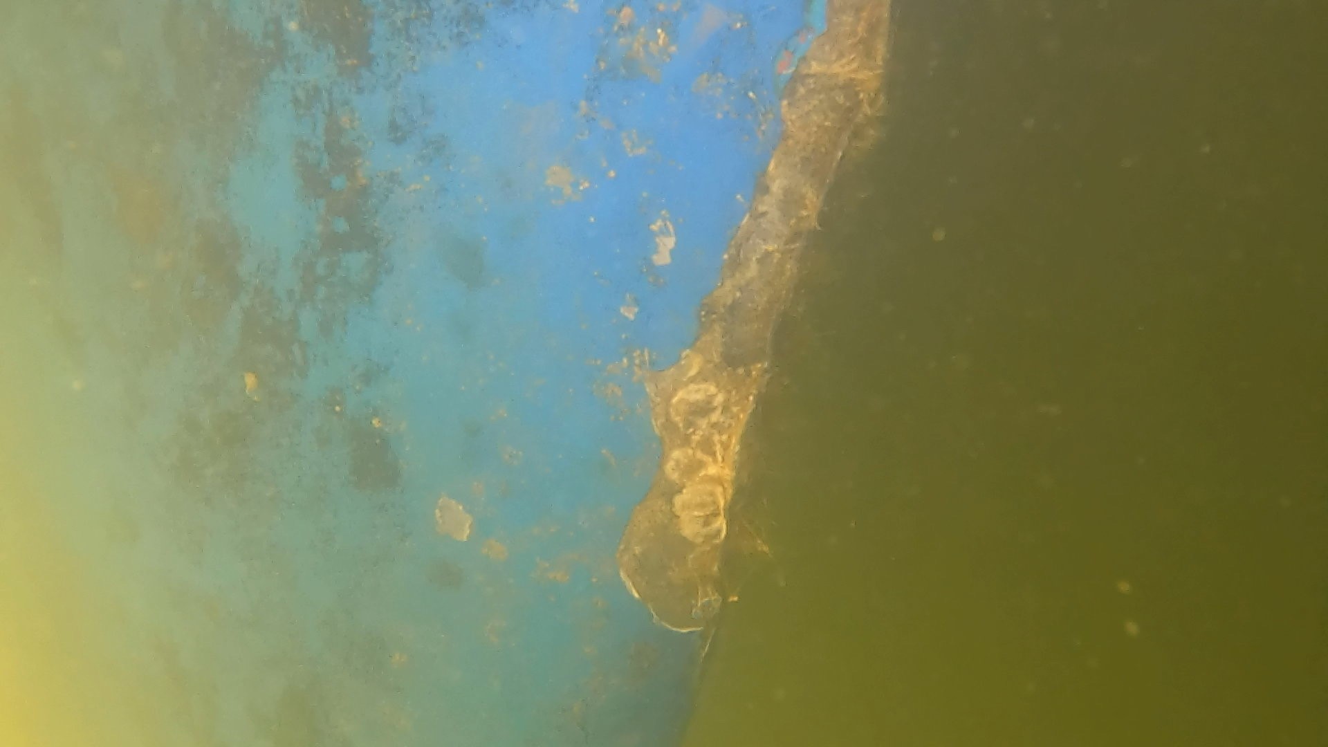

This is a location where the paint has chipped off the leading edge of the keel and you can see what happens when there is not paint.

It is not the paint, it is the water that causes a lot of growth. The Chesapeake is much warmer than the waters in the PNW and is very nutrient rich. Ideal conditions for growing all kinds of unwanted plants and animals.
