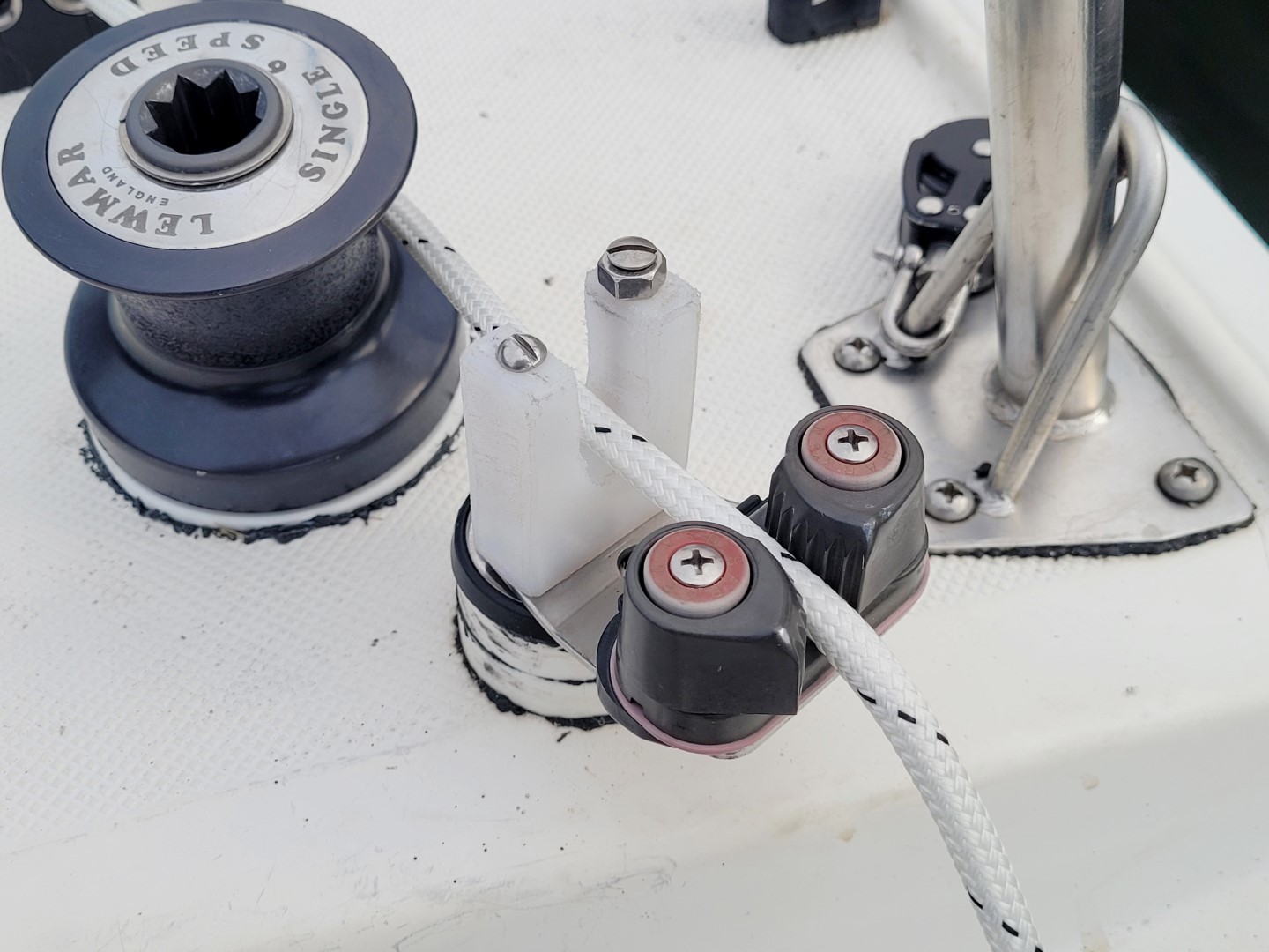

My solution for winch override. Yours?

...This arrangement definitely has its pro's and con's. When single-handing today I had no problem uncleating and clearing the winch while tacking. There's plenty of room to grab and free that line. True, though, that it's a more fluid motion without the capture cap and fairlead at the cleat. It's a process. Always one more thing to balance.
My Stiletto 27 had a 2:1 tackle on the jib and no winch. In a breeze you had to pinch up to tighten the sheet, and above 10 knots you switched down to a smaller jib. Some owners added winches, which included building a substantial platform, as there is no combing or bulkhead in the area.
As I understand it, you reach between the cam cleat and the winch to remove/add wraps? I can see that. Something to remember, on your boat and `00% on larger boats, is that you NEVER want you fingers that close to a winch, in that location, in that position. Should you loose your balance and the wind gusts you could find your fingers drawn into the winch, smashed under the sheet. On a larger boat that would be a trip to the ED. It never occurred to anyone on this thread that you would actually reach into that space. Ingrained habit to avoid. I would not do that on my F-24, I've been sailing a lot ot boats for a lot of years. Be careful. Better yet, loose just the fairlead. The rest is good. I'd move the cleat lower, I think, and probably farther away, but play with it.
Thanks for the advice. I am actively working on a way to have the flexibility of the swivelling cleats without the necessity of reaching into the "danger zone".
I like the idea. My solution was on the bulkhead, but I can see the merit. You cannot re-cleat the bulkhead position without walking over there. On the other hand, you can't cleat under high load without pulling the sheet toward you, which you can't if there is no purchase. In lighter winds, 2:1 jib sheets would be handy.
I had an idea while I was composing my previous message. If instead of a closed fairlead I had an open-topped guide (essential two posts) and I took the keeper off the cleat, then the sheet could be uncleated and the winch cleared in one motion (you know, like normal people do). The only downside is that if a jib sheet got away from me the next stop point would be the block, but that would be acceptable, and I might even utilize some tie-down loops that are currently installed on the bulkhead.
Food for Thought: Why are you looking for swiveling solution? Something fixed coming off the winch is simpler, and more predictable for location when reaching to ease.
I'm not really "looking" for a swivelling solution. It's already there. The swivelling cleats make single-handing much easier as they can be tensioned (in light breezes) from a broader angle - pretty much anywhere in the cockpit. Not so with the standard arrangement.
The location of the sheets vary by maybe a few inches. I have yet to reach for one and miss it.

If this evolves to a next-generation, please share it. I think it is interesting.
My thought, is that ideally, it would be a little farther from the winch and have only a single open top fairlead. I really like to be able to change wraps quickly.
In fact, you can ease the bulkhead mount cam cleat from any angle as well. But you do have to walk over to it to re-cleat. If there is a good breeze you will need to do that anyway, but in light winds it is an extra thing. Obviously, I think, in light winds a 2:1 sheet, like a dinghy or Stiletto27, would be better.
I will be glad to share any changes to the current cleat arrangement.
I could maybe get the cleat an inch or so further from the winch, but I see no advantage to be derived. Clearing the winch is easy - after popping the sheet, I just take it loosely between the forefinger and thumb and pull up. I've sailed this rig single-handed more than 300 times and at no point have my fingers even been drawn toward, much less into, the winch. That said, I don't take the potential danger lightly, especially for my crewmembers. Also, I play drums in a hobby band, and keeping my fingers attached to my hand is a priority.
Looking at photos of the 2:1 jib sheet set-up I think I will pass. It's a pretty complicated arrangement to begin with, and having a rig that doubles the amount of sheet that needs to be handled and does not work across the broad range of lake winds, which can change significantly, in mere seconds is not a viable solution for me. Thanks for introducing me to the concept, all the same.

OK, I think I have this little issue with the swivelling cleats sorted out. The lighting was a little flat when I took this photo, so let me explain. The keeper at the cam cleat has been removed. The fairlead nearest the winch has been removed and has been replaced with a U-shaped plastic block. This allows the sheet to pull free of the cleat assembly in one single motion without getting one's fingers anywhere near the winch and allows the swivel cleat to function properly.
It worked fine in sea trials yesterday. Not surprisingly, the process of releasing the sheet and clearing the winch happens much more quickly that with the other winch which has not yet been modified. It does require a modicum of attention to be sure the sheet is in the U, but that did not prove problematic. Thanks to those who nudged me into coming up with a safer and quicker way to release a loaded jib sheet. Thanks to me for not giving up on my swivelling cleats. ;)
My plan is to have a friend machine a couple of these U-shaped peices out of aluminum.

Yes captain. That does look like an improvement.

Progress!
I would play with the height of the poles and the location of the camcleat before commiting. But for your boat, I think you are onto something. A rare application where a fairlead before an open top cleat is needed. Usually, an open top cleat is enough and is simpler.

Thanks for the comments and again to all who nudged me gently to address the downside to the former arrangement. As a married man I should know that just because something is not a problem to me that does not mean it is not a problem. ;)
I'll post any further changes or observations.

I like it! I think it is an elegant application and I'm a little surprised the sailing hardware makers haven't already made a part like this. In fact, looking at the angle the sheet comes off the winch in thinwater's application (Post 7), which I don't really like, it looks like a good application for improving that angle!

Yeah, I suppose that is open to a number of interpretations. It's just that I have been surprised on more than one occasion to find myself the victim of my wife's ire for things I thought would be fine. Live and learn. In the case of my cleat arrangement, I had gotten so used to it so did not see a problem until the good folks here and my racing crew said otherwise.
