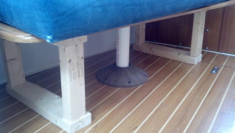

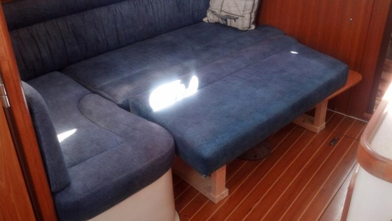

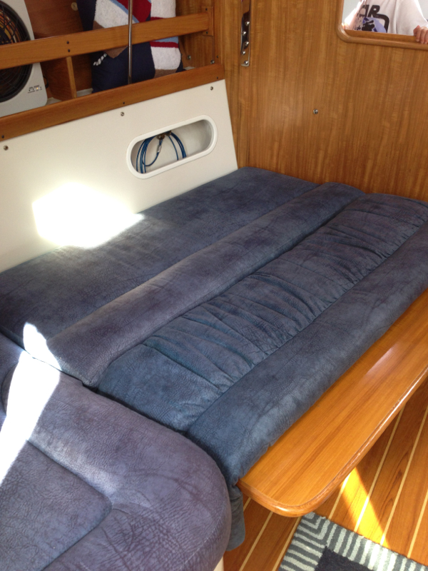

This is my simple solution to convert the table to a sleeping birth on my 2001 Catalina 310. Materials cost $10. I orginally did this for my 6 year old daughter but I think an adult would fit here easily as well. I am 5'11" and was able to stretch my legs.

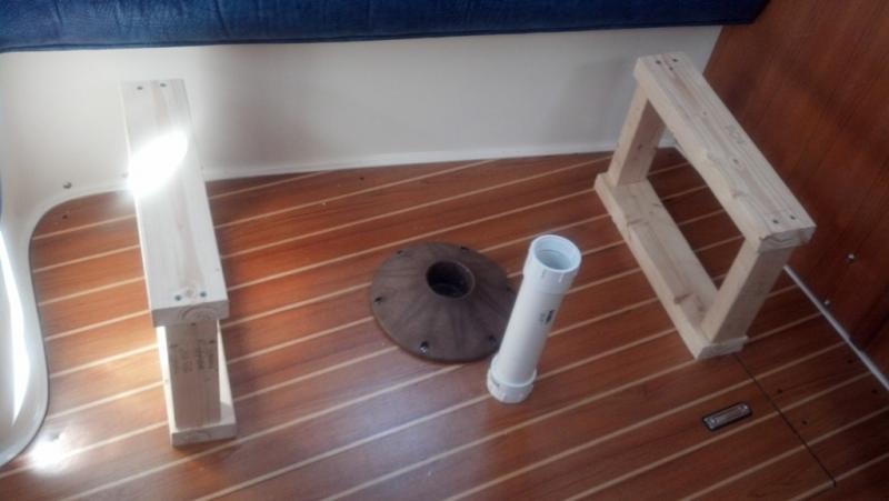

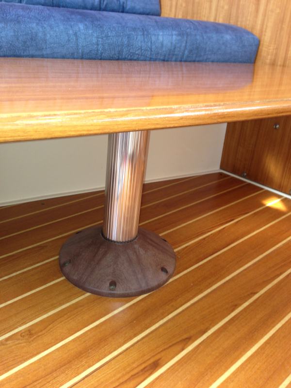

This is my prototype. I will be finishing the wood box legs (rattle can paint) and put a small rubber cover or anti-skid mat on top of the legs so there is no creaking from the table. It is VERY strong and well supported.
The post is 2" PVC with end caps that I found and fit well.
