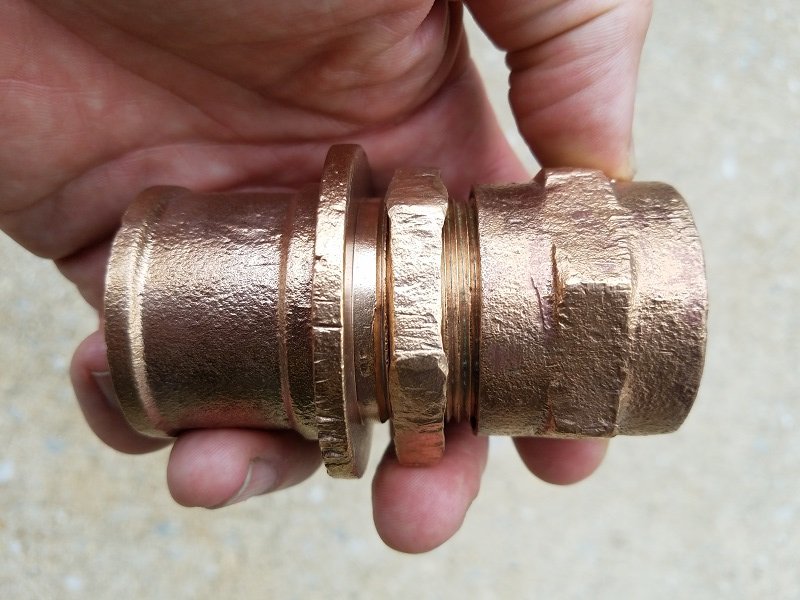

My old stuffing box is shining like a new penny. I think that's a bad thing.

Isn't the stuffing box made of either brass or bronze? I'm no expert on galvanic corrosion, if it looks like it's copper, doesn't that mean that the alloy (zinc?) completely gone? Thanks for input.

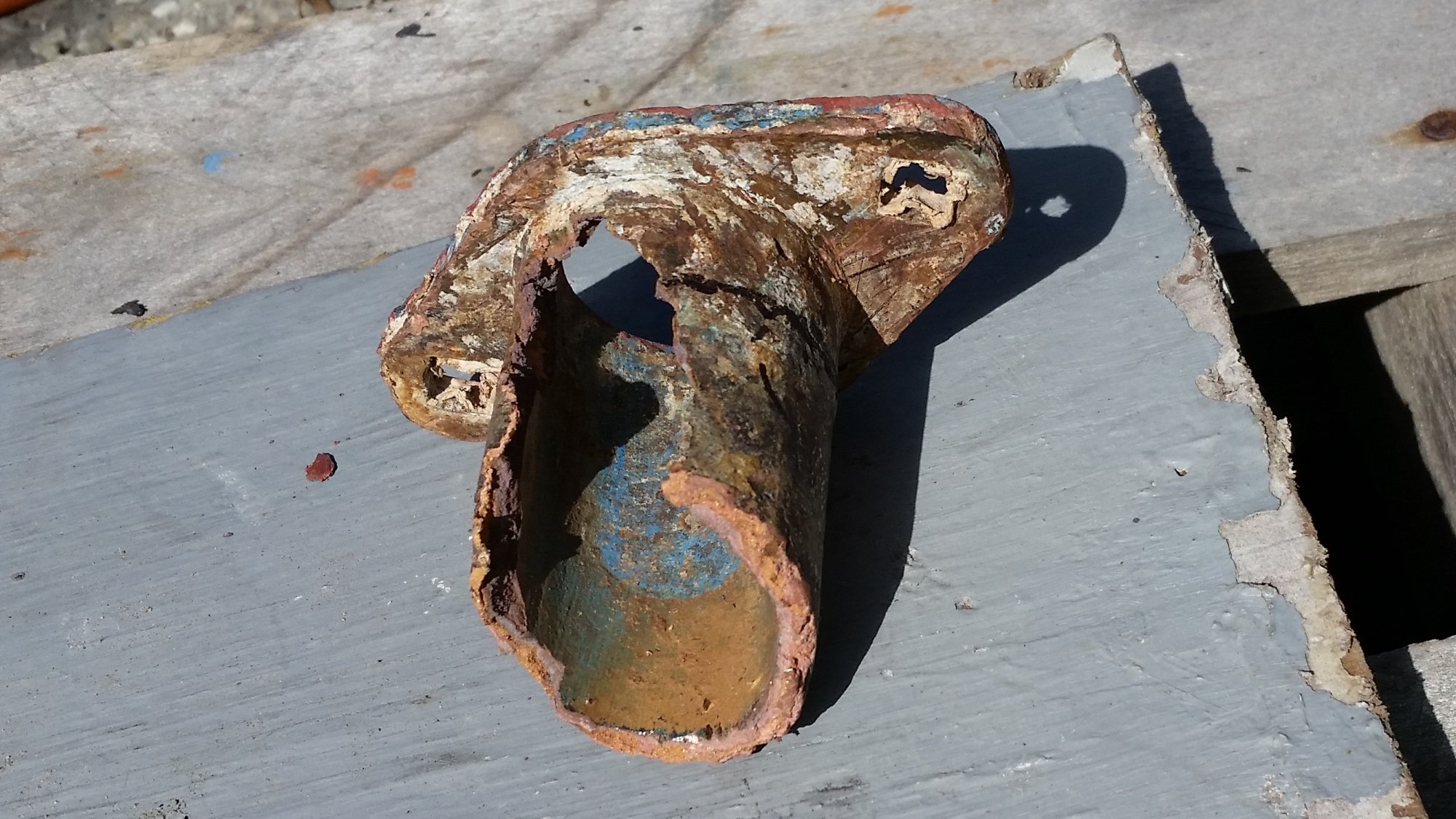

A loss of zinc in a bronze fitting will look like this shaft log. Note the pink coloring that is a tell-tell sign of loss of zinc. Your cutlass bearing looks great to me.

IH82BL8, Your pic does not show a loss of zinc, but an application of gold Krylon paint!
But if the stuffing box was soaked in sulfuric acid,
I suppose the results would be similar :laugh:
14,186
It was soaked in sulfuric acid.
It's not new, I removed it and cleaned it up.
In case anyone is curious, the boat is out of the water :).
The stuffing box is bronze. Why did you soak it in acid? Within a few days after it is installed it will tarnish again. In salt water it will develop a green patina.

Try vinegar next time. You won't need a respirator. It'll do the same thing, a bit safer to boot. Put your disassembled heat exchanger tube assembly in there too and all your bronze parts.

Tried vinegar, didn't make any difference. I cleaned it because, when I take something apart, I clean it before I put it back together. It was well tarnished and patina'ed. It looked like a giant booger. I'm planning to sell the boat in the Spring and I didn't want the visible condition of the stuffing box to give a prospective buyer cause for concern.

I, personally, think the green patina is the correct look for all things bronze and copper. It's a natural protective coating. People even have developed "pickling solutions" to precipitate the patina without having to wait for father time to do his work.
Take a look at bronze statues, and other bronze works of art.
