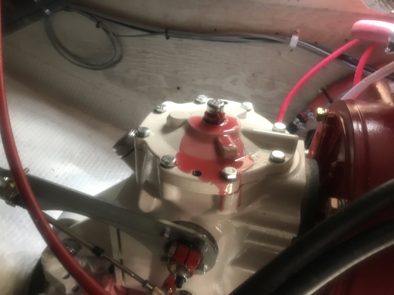

The latest from Italy. I was informed that there is no way with the latest top plate design that ATF can be blown out of the breather vent. I was asked to verify that the dipstick was installed correctly. I gave them a very detailed description of how I insert the dipstick and read it. I was asked to make sure the ATF level is below the max mark on the dipstick. (yawn). I was also asked to to clean and dry the top plate of the sail drive and spread talcum powder to show that there is ATF leaking out. I don't think they get it..see pic. this is about 5 seconds worth of leaking after 1/2 hr engine run..
