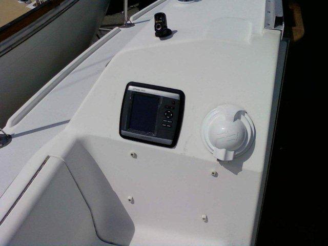

here is where I mounted the plotter on my boat. This pic was from the spring before she was launched, hence the empty spinlock
Fourpoints, that looks awesome! Is that a GPSMAP 421 Chartplotter? Do they come with gaskets or a lip for mounting into the fiberglass? And how will they fare being left out exposed to direct sunlight? Is that an issue? Do people cover or remove them? Please tell me more.

Gpsmap 540s, sounder is epoxy bedded to shoot through the Hull under the v berth.
That's the waterproof flush mount kit from Garmin ($20 at the defender spring sale). The unit is waterproof to something like 3 meters underwater, so rain and spray are of no concern. It also came with a cover that stays on the unit whenever it is not in use so it doesn't get UV abused. The kit has a tight rubber gasket, and I have yet to notice any water that has leaked through, but even if it did, behind that bulkhead is access space from the fender / line locker in the cockpit so it wouldn't matter if it got a few drops in there now and then.
BTW, with the flushmount kit the chartplotter cannot be removed without access from behind to release the latches, so it is safer from theft than using the regular brackets.

The problem with those bulkhead mounts is you're always asking someone to move so you can see the display, unless, of course, you're singlehanding.
Apr 8, 2010
1,606
Frers 33 41426 Westport, CT
Yeah, that sometimes happens, but unless you are navigating an anchorage, you don't normally need to be looking at the plotter all the time, just a quick glance every few minutes to confirm your still traveling on the correct COG, and check your speed...
That small inconvenience of asking someone to lean forward or back so I can see the screen is A) worth not taking up any cockpit space and B) necessary when you have a tiller, and no wheel post to mount things to.
Granted you can do things like mount in on a swing arm in the companionway, or make a new bottom slat with the plotter installed in it, and sail with the plotter in the bottom of the companionway. I liked neither of those options, and found none better, so the bulkhead mount was my choice, and I'm glad I did.
