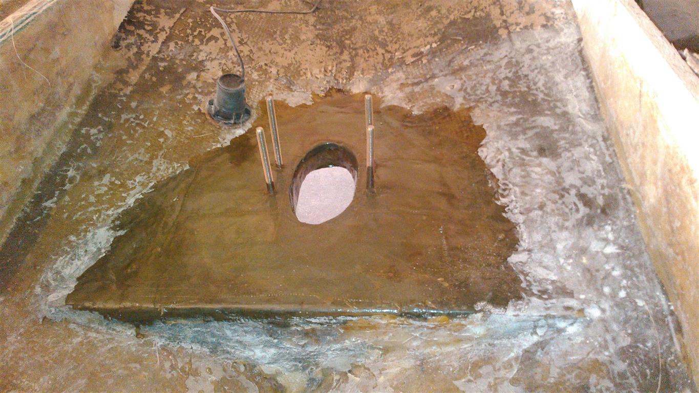

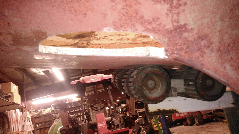

Well there is no turning back now. I did figure out how to isolate everything. The motor from the unit was easy just a rubber bumper connection in between the two hubs. The unit itself will have a rubber gasket 3/4" thick and rubber spacers between the attach bolts. The secondary seal similar to what "Main sail" shows will be some what the same. The lower unit will be free to move, but very little. Enough I think to take care of the problem. All the questions and answers worked out well because it made me rethink the install and this method will be much easier. I just cut off a piece of the upper part of the lower unit and will weld on a 1/4" thick piece of aluminum to bolt to the base. Now if I have to service the lower unit, it just unbolts like normal. I am making the base now and will epoxy it to the hull. I still have to find the aluminum and order the motor.

I have the bed finished. Tomorrow I will look for some aluminum. It will be a few weeks before I can get the motor, but I should be able to get the drive mounted sooner.

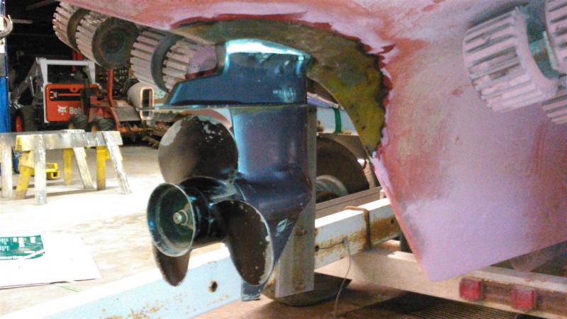

The sail drive is in the water and operational. It works great. Simple controller and controls. Ran it for 1/2 hr to 45 min ran the batteries to about 80%. Took two hrs to charge them back up with a Honda generator. I do not have the solar panels purchased yet. It is so nice to just hit a switch and go rather than starting an engine. I do have some fine tuning to do.

Well I pulled the boat today to check things out. I was stuck in the weeds for a week because my anchor broke loose in these ND winds. We had 35 to 40 mph winds for a week. What broke me loose was a shift in the wind direction. even after being stuck in the sand for a week the sail drive looks great. starting to look like it belongs there. I have been doing some testing and at less than 1/2 throttle I can go 4 mph. there is a definite setting where the prop starts to slip and create turbulence. At that point it really moves the boat. I did not have my phone out so I do not know how fast I was going. I have to do a little more work before I put her back in.
