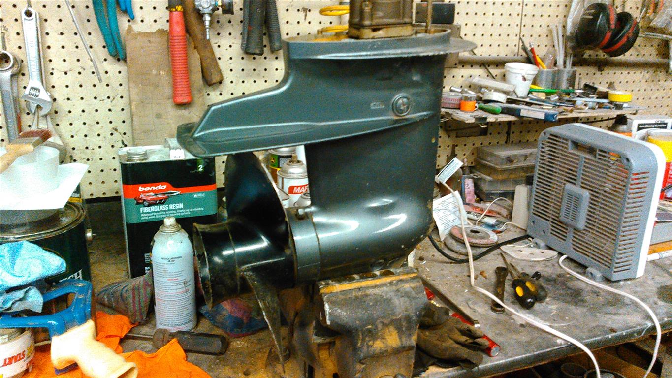

The weekend started out pretty good. I just put a rack and pinion in my wife's car so I thought I would test drive it to Bismark 100 miles away. I was looking to go to an outboard engine shop that specializes in rebuilds. I was going to by a lower unit from him for my sail drive. when I got there the shop was closed with a note that said they were at the boat show another 100 miles away. A quick phone call and he told me he would not be back, but I was welcome to go through his pile of scrap and take what I wanted. He also mentioned a Yamaha complete outboard that he was not going to use and I could have that. SO I DID. All for free. I think I can sell some of the good parts off the top end on ebay to pay for gas. The only holes in the boat will be four small bolt holes and the small hole for the shaft. I will have to build a platform to rest it on, but that should not be a big deal. I already have the motor and controller picked out, Total cost of the project should be less than $1,500.00 with 4 marine batteries. A generator to charge the batteries on longer runs and also for house supply when needed. I am going all 120 vlt for the house side and 48 for the motor.

Pulley on the shaft, pulley on the motor, belt to connect them. If that is what you are asking. The shaft is not pictured because it was too long and I could not get the unit close enough to the hull.

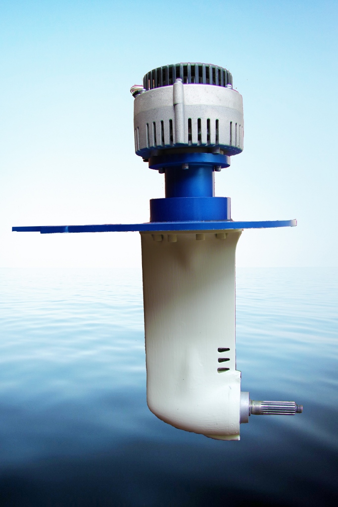

http://saildrive.com/ same thing only I am attaching an electric motor instead of a vibrating diesel.
Nov 8, 2010
11,386
Again sorry, but you're not understanding how these work.
Look at the pictures. The sail drive lower unit is NOT attached to the hull. It is isolated via a rubber gasket, and is a part of the upper unit. and is is allowed to vibrate with the drive source.
I have a saildrive on one of my boats, and if you push the lower unit the motor moves.
If you bond the lower unit to the hull (with bolts) it will have to deal with the vibration and the harmonics.

I have a request in at VoltSport (the above picture showing a retro fit). They are mounting it direct to the fiberglass no isolation at all. I still think I will use the 3/4" rubber mounted to the hull and the Drive mounted to that. It will make forming the attach point rather easy. Very close to how Yanmar is doing it, using rubber instead of Fiberglass.
