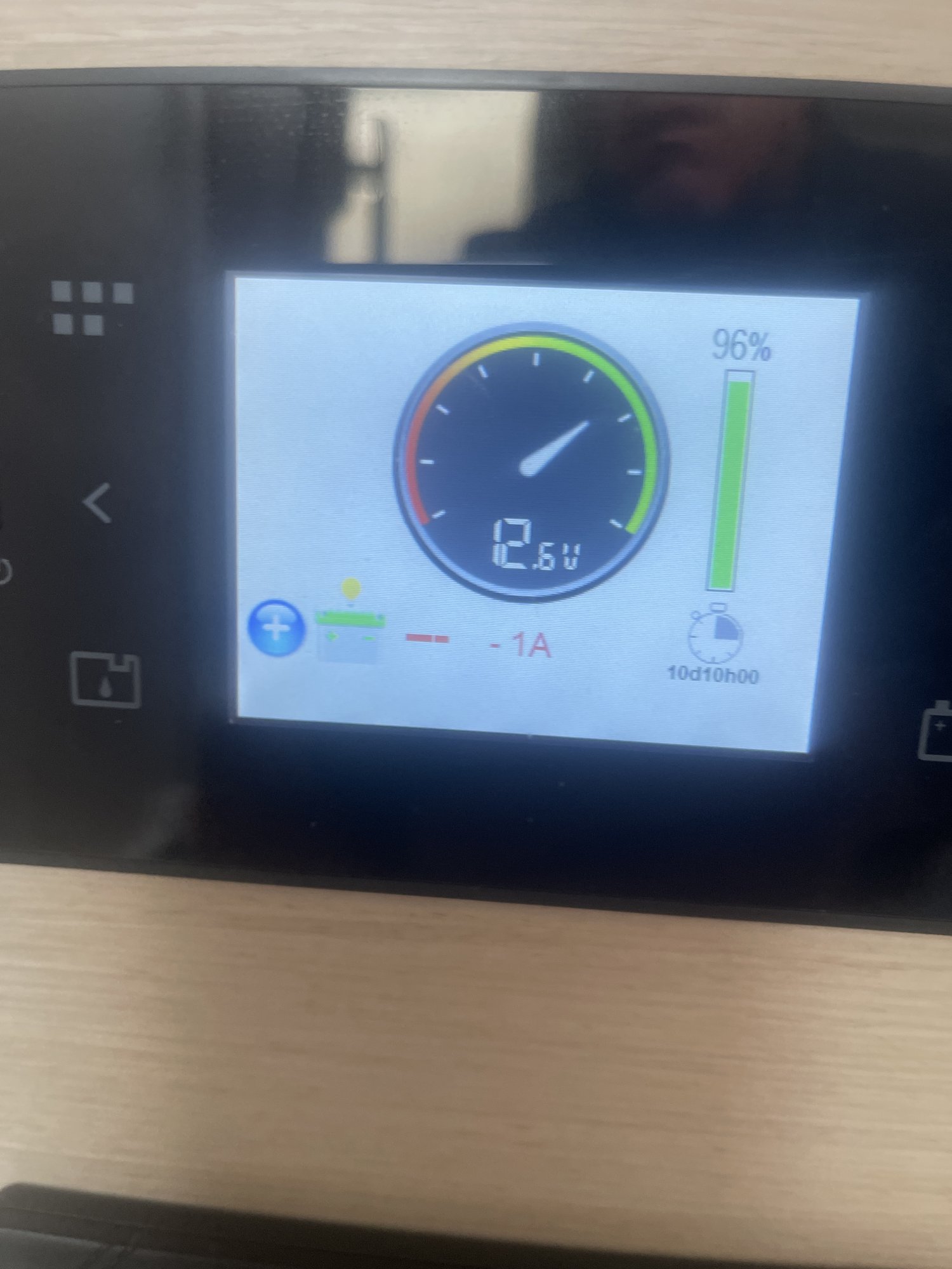

interestingly I did a little test and the battery bank was at 64% 1 o’clock and I turned off the bank switch. Turned it on at 6:30 and it still read 64%. I gave it a short 1 hr test with no loads turned on at all, just the parasitic loads, and after an hour it was still right at 64%. Not conclusive, but doesn’t look like it’s draining fast definitely with bank isolation switch open (which I expect but that’s a good thing to prove) and at least for an hour with system just like I left it, it’s not draining super quick at least.

With your short test of 1 hour I wouldn't expect the battery capacity to reduce much, if anything measurable. With a small parasitic load of even 1 amp you would only draw 1 Amp hours out of the battery, which might not even show up on the % capacity display depending on what its accuracy and resolution are. Time is not your friend in a parasitic load with no charging source. You might even have a bad "new" battery (it happens) that is self discharging slowly and adding to the problem. The experts will check all this and Monday will tell the tale.

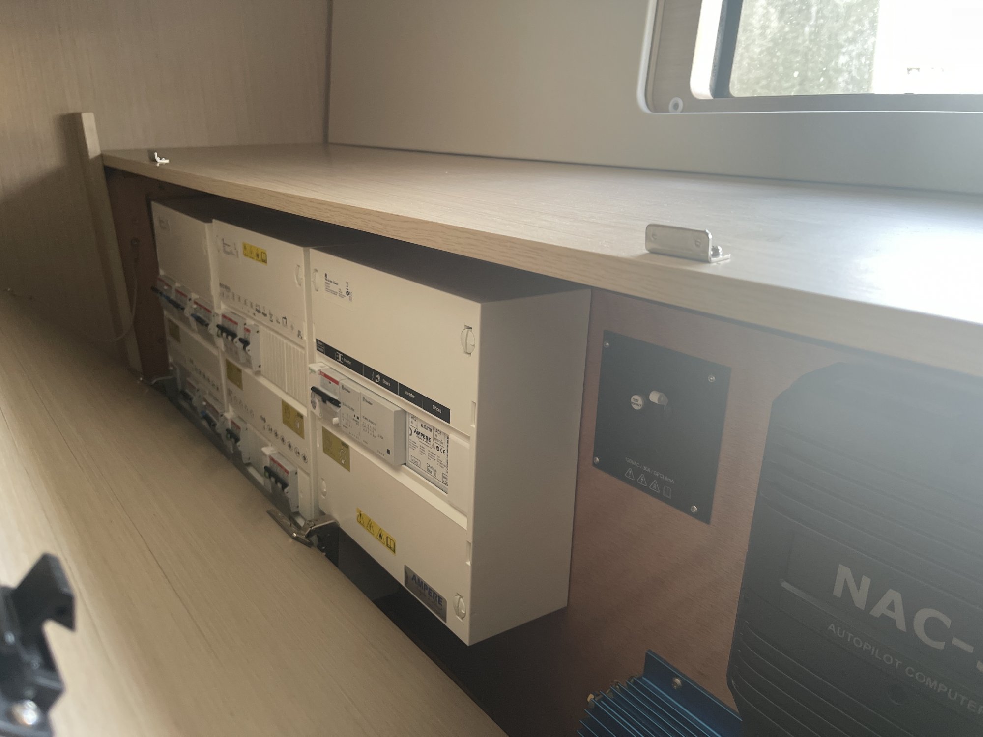

WOW - that is a complex looking system! To the OP, I would not suggest nor would I encourage that you open panels on a brand new boat and certainly not to attempt to work on live 120V circuits. I see a 30A GFCI 6ma in the black box panel closest to the right side of the picture.
On the first beige panel closest to the 30A GFCI there is a 3 gang breaker below what looks like an I beam. I'm guessing that is the French symbol for the shore power cutoff. I don't think this is the breaker I was referring to because if my memory serves me right the breaker I am referring to is supposed to be within 1 ft of where the shore power enters the boat. Maybe someone with the ABYC standards in their hands could weigh in on that.
Based on your manual, it would appear that the voltage is getting through that breaker I am referring to (close to the where shore power enters the boat) so even if you can't find the breaker, it would not seem to be a contributor to the issue(s) you are dealing with.

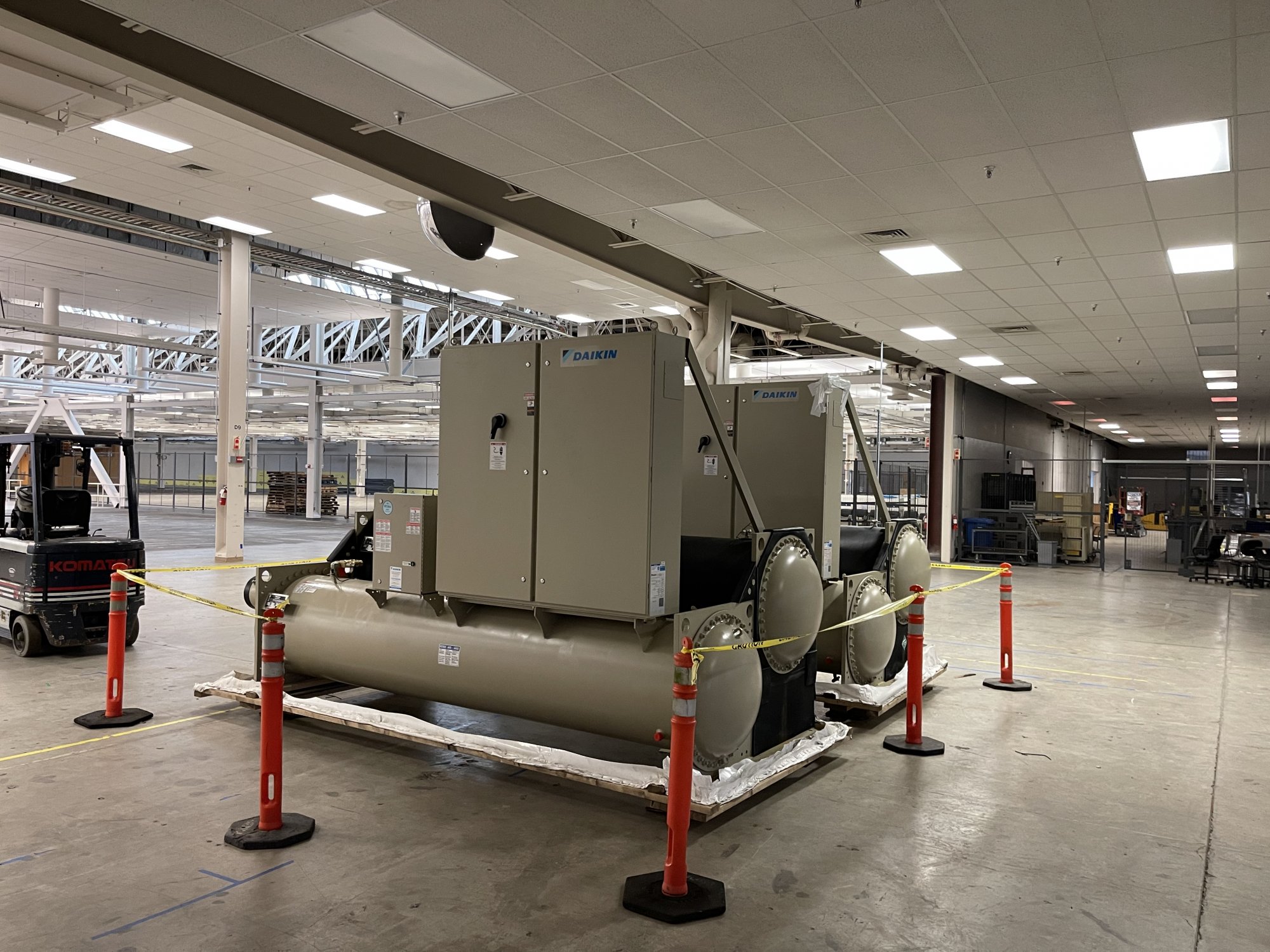

Looks like a Chiller at an industrial facility of some sort. Probably rated at 700 tons.
