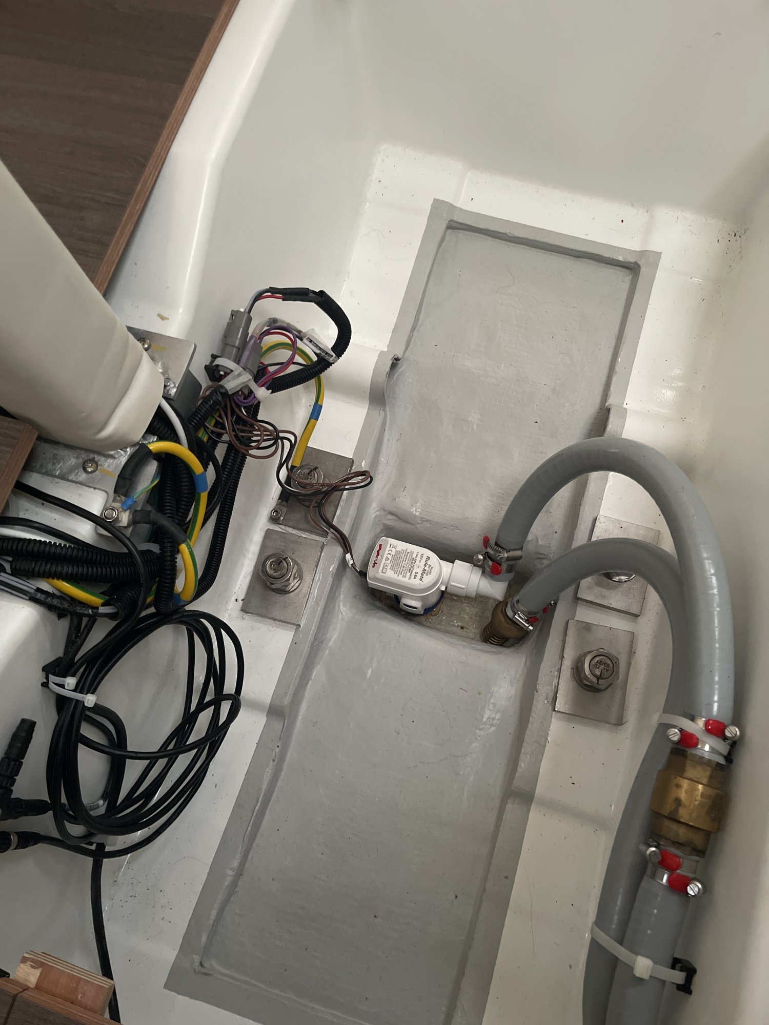

Have you looked in your bilge for water and/or do you have a bilge pump counter? If you have a slow leak that is allowing water into your bilge from any source (fresh or salt) your bilge pump will cycle and over a two week period could drain your battery. Your bilge pump should be powered directly from the batteries and not effected by the switch positions, including the the "battery switch". If you have a Low Voltage cutoff switch, I would guess that the bilge pump doesn't go through this switch either.
That is why I have a "bilge pump counter" since I have my boat on a mooring. I want to know if my bilge pump is cycling indicating a leak. Everytime the bilge pump starts it registers on a counter. 0 over two weeks is ideal (and what I've been able to achieve chasing leaks). A few is probably okay from a safety and battery standpoint. Hundreds IS NOT :yikes:
I'd bet on an unkown leak and the bilge pump cycling. But that is just a guess. Bilge pump counters are cheap insurance IMHO.

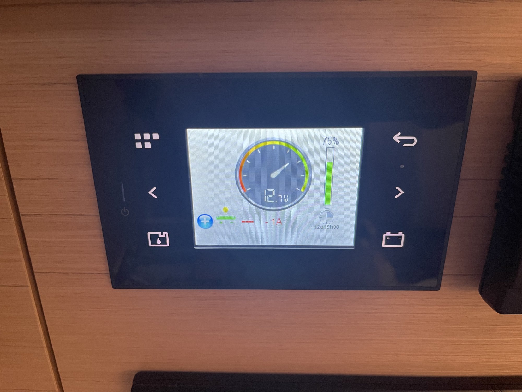

Thanks so much for all the tips. The manual helped me. I still don’t know what ran the batteries down but I found that the shore power and generator have a transfer switch to line up one or the other or both to the 120v house wiring which also powers the house bank charger. There’s a manual handle to switch it from center not connected position to shore power one way and generator the other. It won’t connect with the powered relay switch with house batteries all dead. I powered down everything and manually moved it to shore power and plugged in shore power. Then I closed the house bank battery switch and battery charger powered up and it’s been charging all day. and systems are working. It’s got a touch display that shows voltage and percentage charge of the 4 house bank agm 100 batteries and at about 20% I tried switching the relay transfer switch back to remote operation and have it work normal but it wouldn’t connect shore power to boat like it normally does.
I switched back and let it charge rest of day and now when it got to all 4 batteries about 75% I tried it again. Now I’m ticked I just didn’t leave it all night, because not only did it not connect through relay operated transfer switch, now when I turn the switch to shore power manually the charger doesn’t energize.

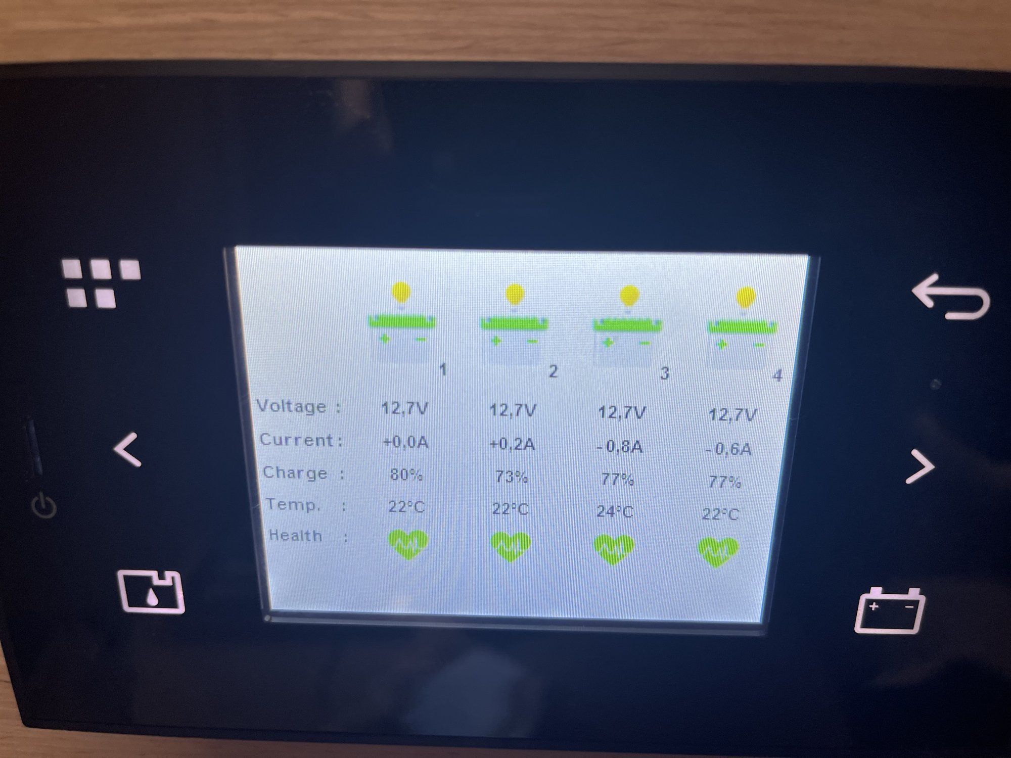

The controller display has a battery health screen it’s showing all batteries same voltage to one decimal place 12.7 -two have positive fractional amps flowing the other two fractional negative. The house bank screen says the bank is flowing 1 amp to system. I’ve got all the switches off again- gotta get ice for my beer again tonight- so this is basically condition it was in when it went dead. Having the 120v shore power unable to power up the charger now either with the powered relay transfer or the manual switch is simulating what happened while I didn’t have it plugged in, all the 12v panel push button switches off and no known devices powered. Bilges are bone dry.
Talked to dealer service manager early in day and he did get Benneteau on phone to get me that advice about the manual transfer switching. But now with this seemingly new issue of the transfer not happening even manually I won’t be able to bounce that off them until Monday.

No the house batteries weren’t getting charged when I ran the motor. I had my meter on the bank and it stayed at 4.4 volts, that was before I got the shore power manually switched to run system and charger. So maybe the alternator charger controller must also need 12v on housebank to charge house bank with alternator, that’s seems unfortunate- just when you need the engine to charge house batteries most - run low at sea- the engine alternator can’t charge them? Controller (the one I photographed the display of in my previous post definitely powers down when house bank battery switch is opened.
