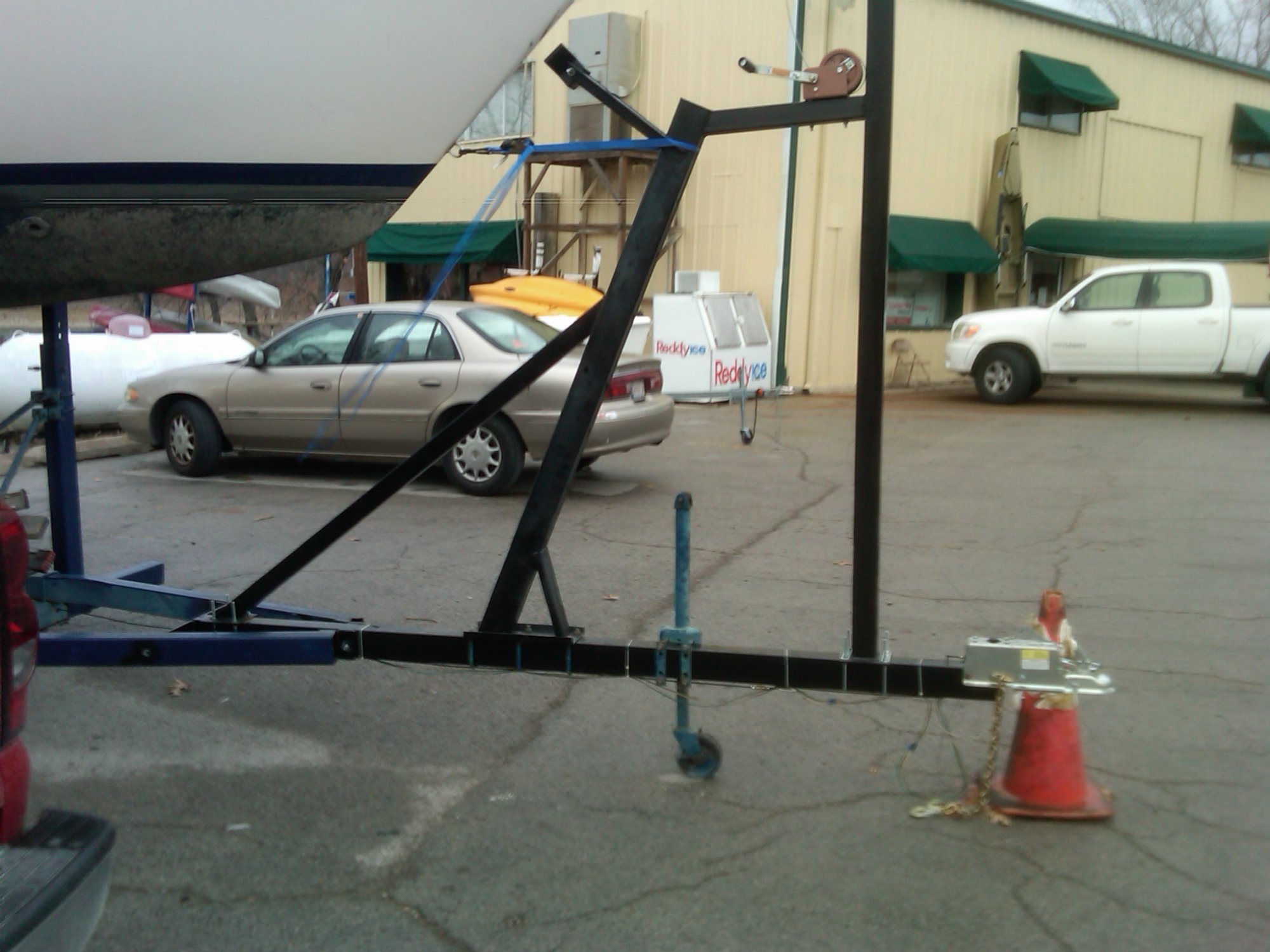

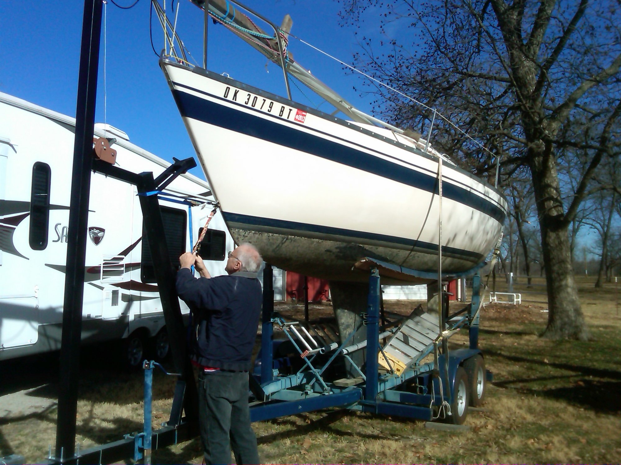

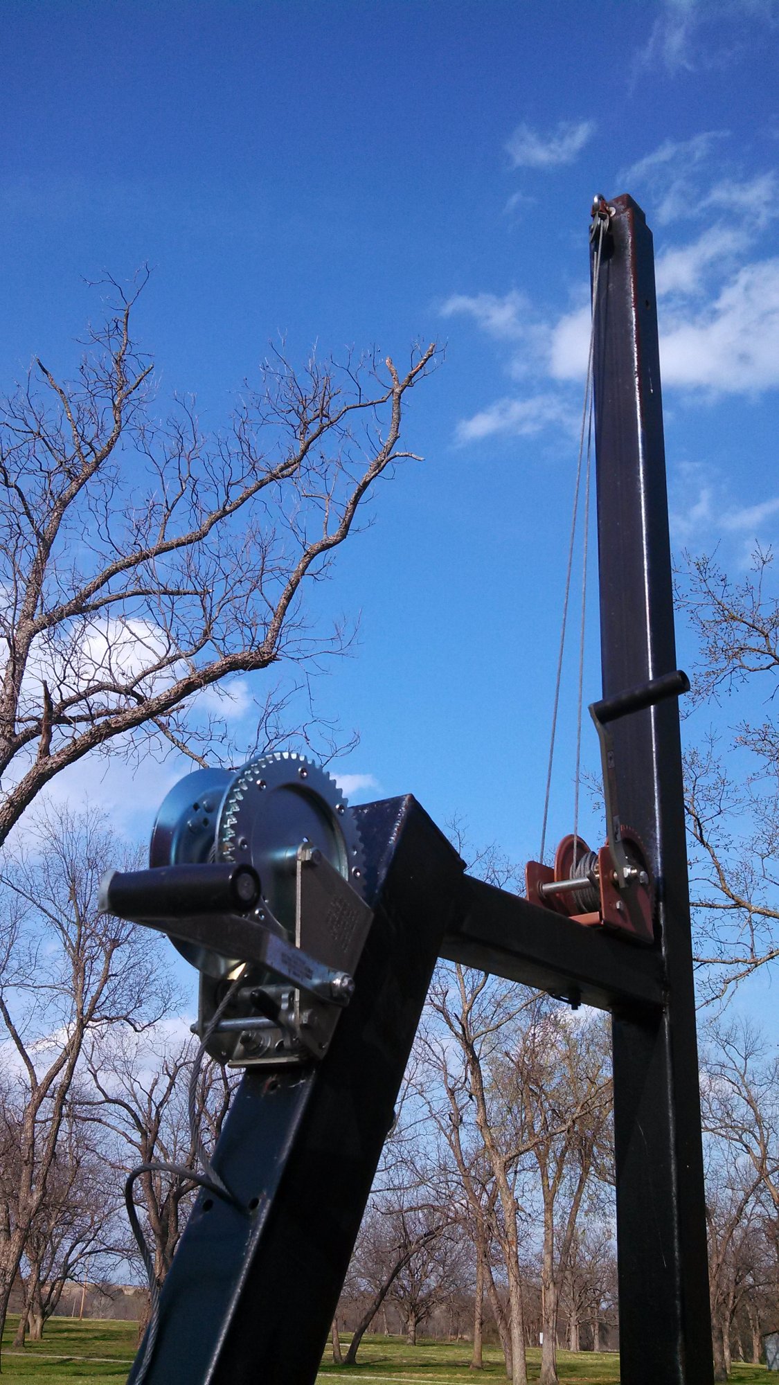

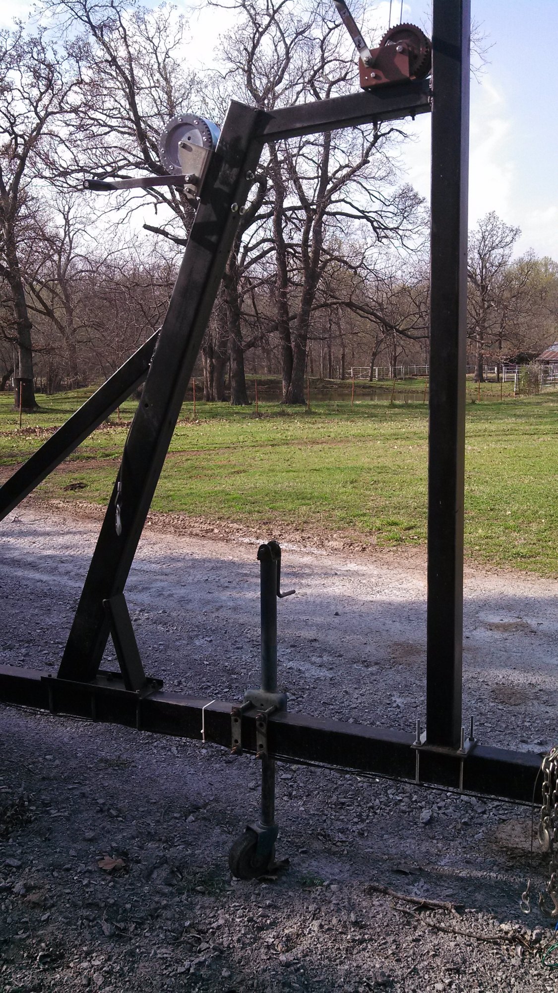

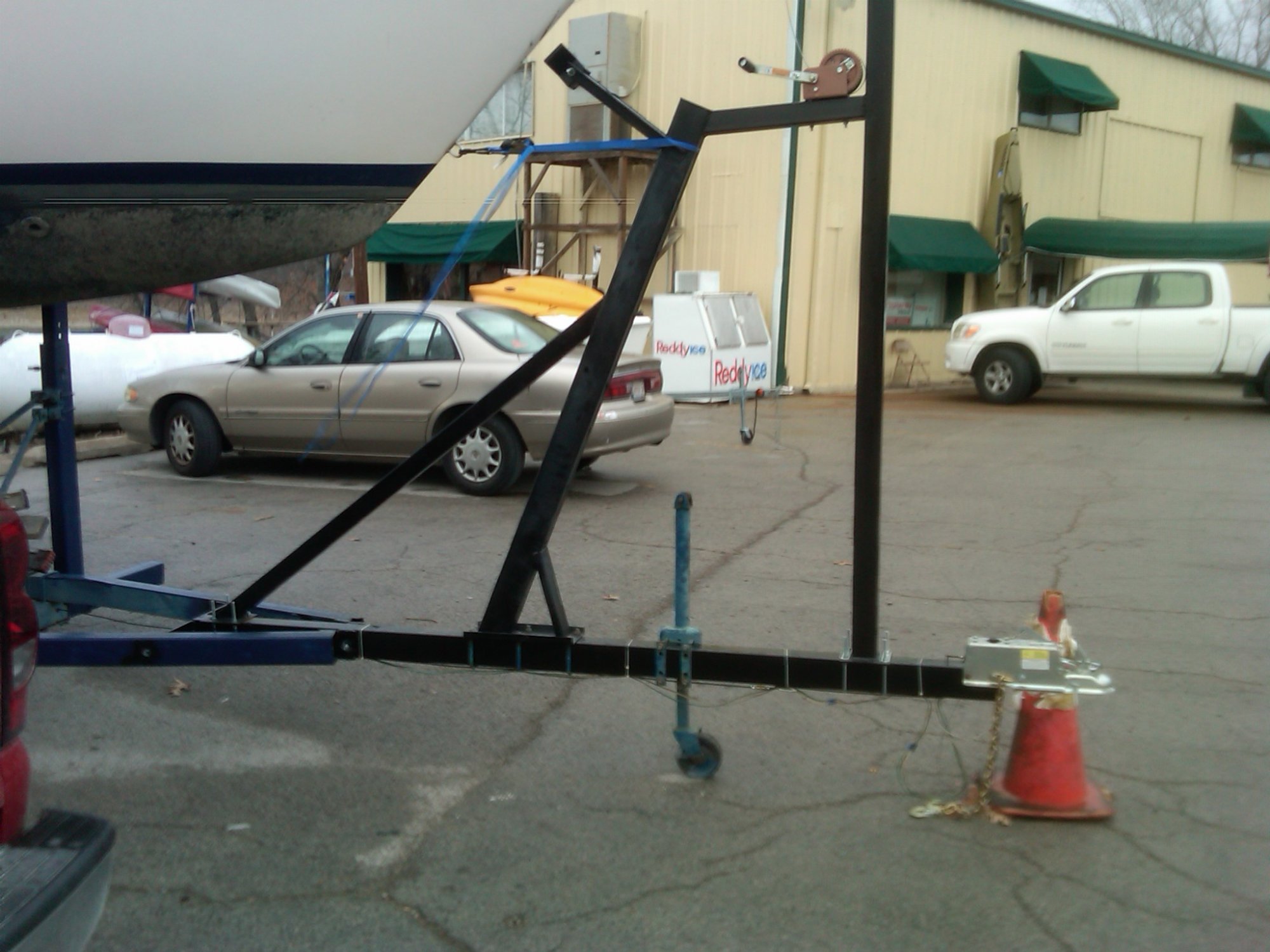

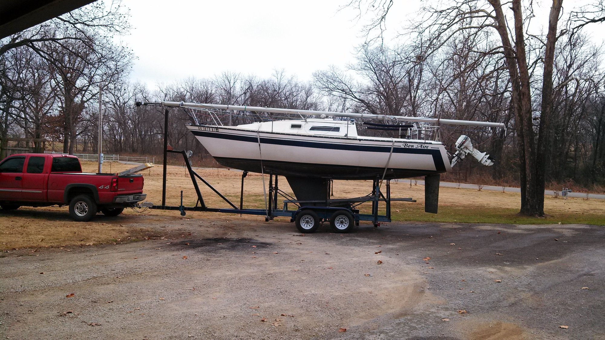

I took a different approach and built a extendable crane on the front of my trailer. The boat is a San Juan 7.7m. The trailer needed a new tongue so I replaced it with a longer one that gave me room for the crane. When extended it's probably 8ft above the deck.
I don't have any pictures of it in use.
That’s slick but I want something I can stow away in the boat incase I need to get off a busy boat ramp quick and set on the water or take it down to get under a bridge.
