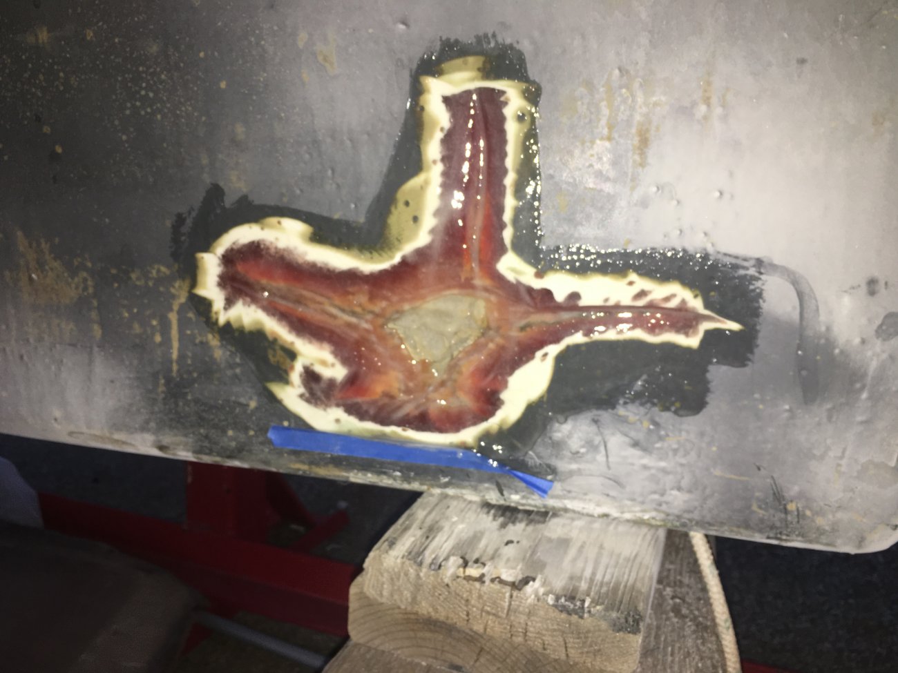

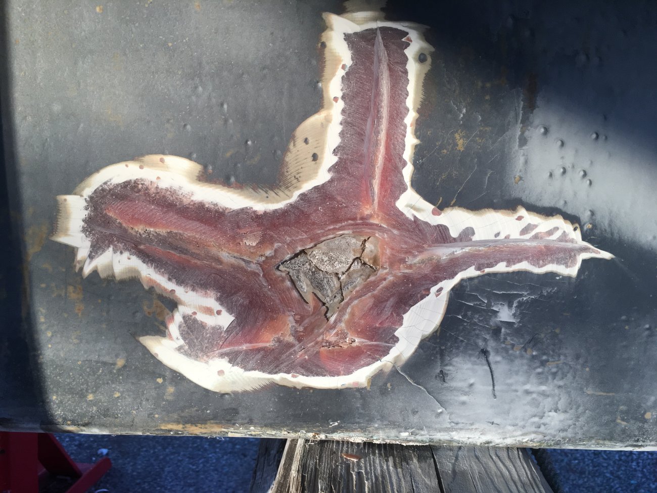

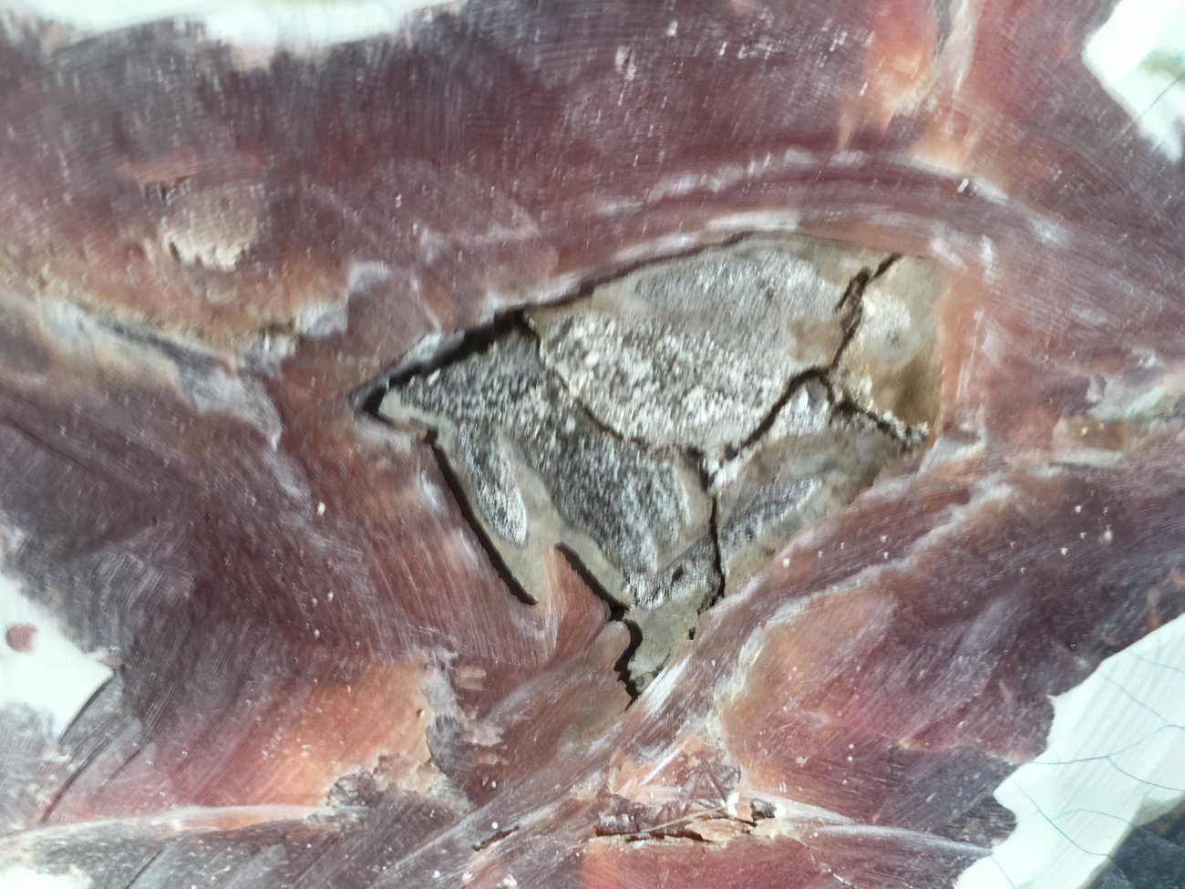

I got a chance to grind into the keel today. The cracks are deep. As you can see they go through the outer fiberglass shell and into what appears to be another type of resin. This inner part felt cool and slightly damp. Last time I checked the bilge was dry. I did not check it today.
At the advice of a yard staff member I stopped at this point to get some more advice. I assume I should keep grinding to see how far the rabbit hole goes? There's clearly two types of resin and cloth used in the keel. Any advice on what materials to fill this back in with? The last pic is some thickened resin we put over it to temporarily keep rain water out

Looks like you ground thru the outer shell of the keel into the cavity where the lead plates and filler material is.
Remember the O’day 25 does not have a typical encapsulated solid lead keel where you can grind down to solid lead and re fiberglass it.
The O’day keel started as a shell that had lead placed in it, then a filler material poured in to secure the lead.
You didn’t mention seeing any water dripping out of the area so I doubt there is an active leak.
If it was my boat I would lay up one large patch over the whole area and go sailing. If the cracks reappear later then drill some holes in the fall so maybe it will dry out over the winter. Then patch the holes in the spring.

The West System Manual (available on the West System Site) has good information on applying a patch. The Boatworks Today youtube channel has some videos on patching.
I would grind it out until the cracks were gone, since some of them appear deep. If it gets to the point where it looks like the lead pieces are going to fall out, then glue them back in with some thickened epoxy.
