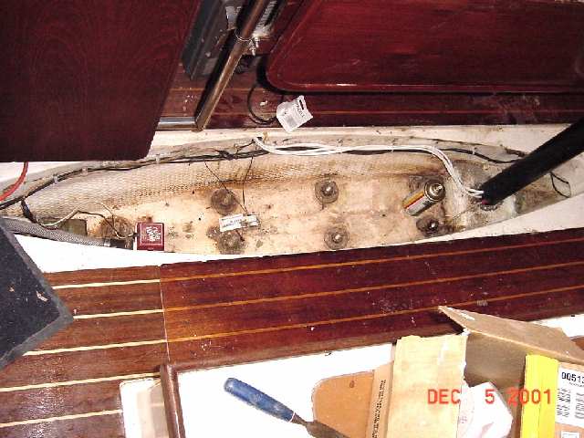

Wow!!! please let us know what you find out about this. I have a 79 h33 and my keel bolts look new on top anyway. I have never given any thought to a keel problem on this boat. Do you have a shoal or deep keel? Maybe JC could comment on any know occurences of problems. If it fell of while you were under way you would have known it even if you were motoring so it must be under the boat. I would get that boat out of the water ASAP

Stephen with a history of no
Anodes used I'll bet the bolts have disintegrated somewhere that they had contact with water. This should be a lesson for us all to rap the tops of our keel bolts on older boats every couple of years and if there is any indication of a problem to drop the keel and check it. I know its a hard job because I did mine last year. It was not something I want to do again right off but with a boat that’s 24 years old I figured it was time. Everything was like new on mine by the way. I’ll try to find the some places that can recast you a keel and get back to you. Like I said before I saw somewhere the name of a place in Canada that does this and they may be cheaper because of the exchange. You might look around and see what you can find for old lead, keels or what have you. You may be able to reduce the cost quite a bit if you furnish you own material. Richard

The H33 keel is about 4400 pounds. To lose it lowers the waterline several inches at once. No way to be in this boat and lose the keel and not be very very sure of it, most particularly if the boat was heeling significantly for it would immediately capsize. How about posting a picture of your boat floating at the dock. Also, pulling one of those 9 or 10 3/4" bolts out as shown in the photo should be pretty easy even in the water and the hole easily plugged. It would be very helpful to see a photograph of the fracture surface of any such removed bolt stub. About the only way I can think up a mechanism for this keel to just fall off would be if all of the bolts were so over torqued as to be sheared off leaving the keel with just the sealant to hold it up.
