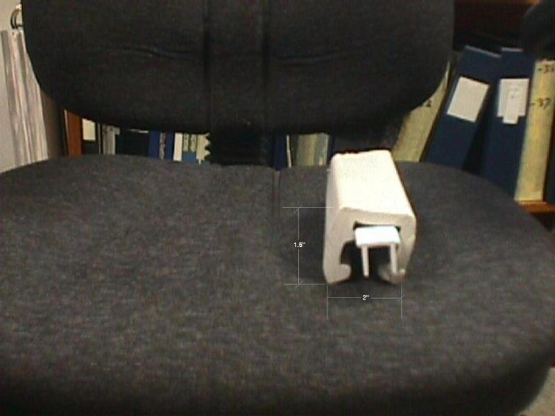

Also attached is a pic from Hunter showing the two pieces of the rub-rail assembly.

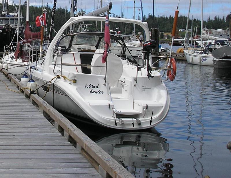

Pervious owners, put some silicone where you put arrow on the second pictures
should I suspect some leak or is impossible to have some water leak where you show me!

As shown in my previous cross section of the rub rail, the small bead of silicone won't keep water (either rain or sea water) from getting behind the rail. Rain and or sea water will enter the rail further away and run down under the silicone.
- Get rid of the silicone.
- Take a look inside the hull through the starboard side hatch and see if there are any leaks.
- Is the deck/hull seam covered in fiberglass from port to starboard ?
- Place a small stack of newspapers along the seam to see if there are any leaks.
- If there is a leak, dry everything out and paint with several coats of epoxy resin (best) or fiberglass resin (good). Don't bother with cloth. This will seal faaaaaaaaaaaar better than a small bead of silicone.
