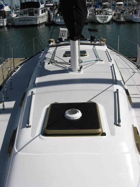

If the look on the attached photos is something you would consider, I'll dig further into getting sourcing and installation info. My 1980 Hunter 36 also had original teak hand rails when I bought it. They needed to be removed when I painted the cabin top. I decided that I did not want sand/varnish every year. So I replaced as shown. This was an economical modification.

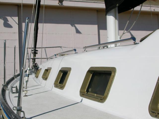

Stainless Rails
A prior owner removed the teak rails on Lady Lillie, and installed 2 23 inch stainless rails toward the aft end of the cabin. They have integrated bolts like the 12 inch rails shown at this website:
http://www.boatersland.com/afi74012.html
The mounting requires drill/fill/drill to keep the new holes from wetting the wood core of the cabin roof. They are fastened inside the cabin with fender washers,, and nuts that cover the end of the bolts.
This provides a great, secure hold between the cockpit and the shrouds. Since the shrouds attach outboard through the toe rail, they provide the ideal hand-hold while going by the mast. We don't miss the rails forward of the forward lower stays.
The big advantage of this approach is that the cabin roof ahead of the grab rails, and inside the stays becomes a great seat forward for the crew. (No rail to torture your bottom.)
This is a great feature of our boat!
