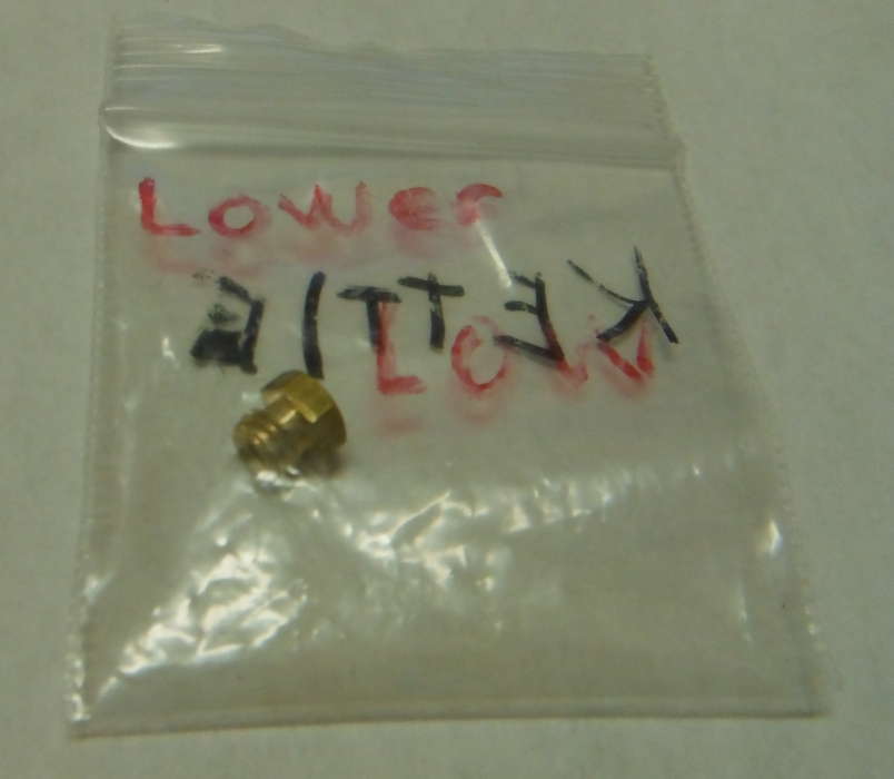

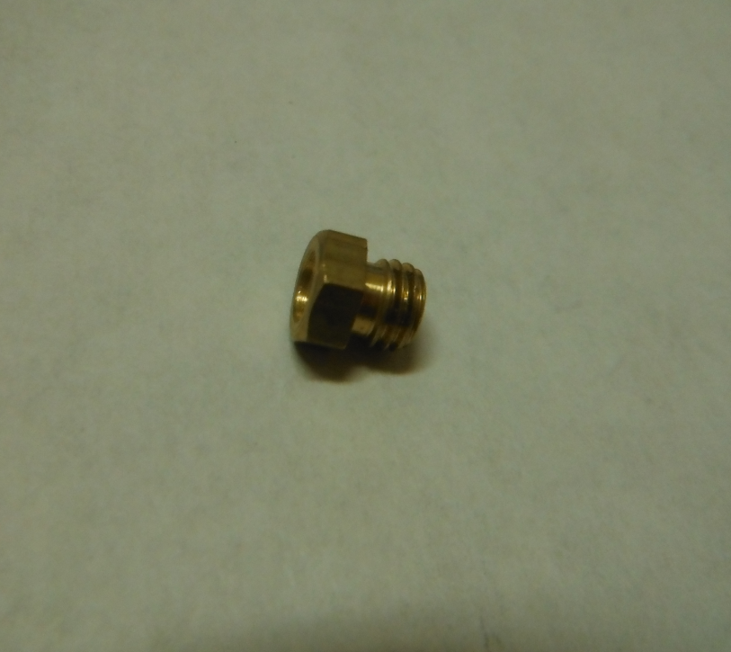

Had a package from Magma arrive last night. Low flow aperture for the regulator.
This could be the ticket!

We purchased a lower flow regulator for our Magma. It is way easier to cook with now. We even bake pizza on the grill.

Wow - had no idea that this was a thing. Both our Magmas (one single wall and one double wall) have been blowtorches. TT customer service and they sent the smallest screw in regulator orifaces but still very difficult to manage the flame. Pizza - no way possible. No mention of low volume regulators.
Gonna check this out. THANKS! :clap:
