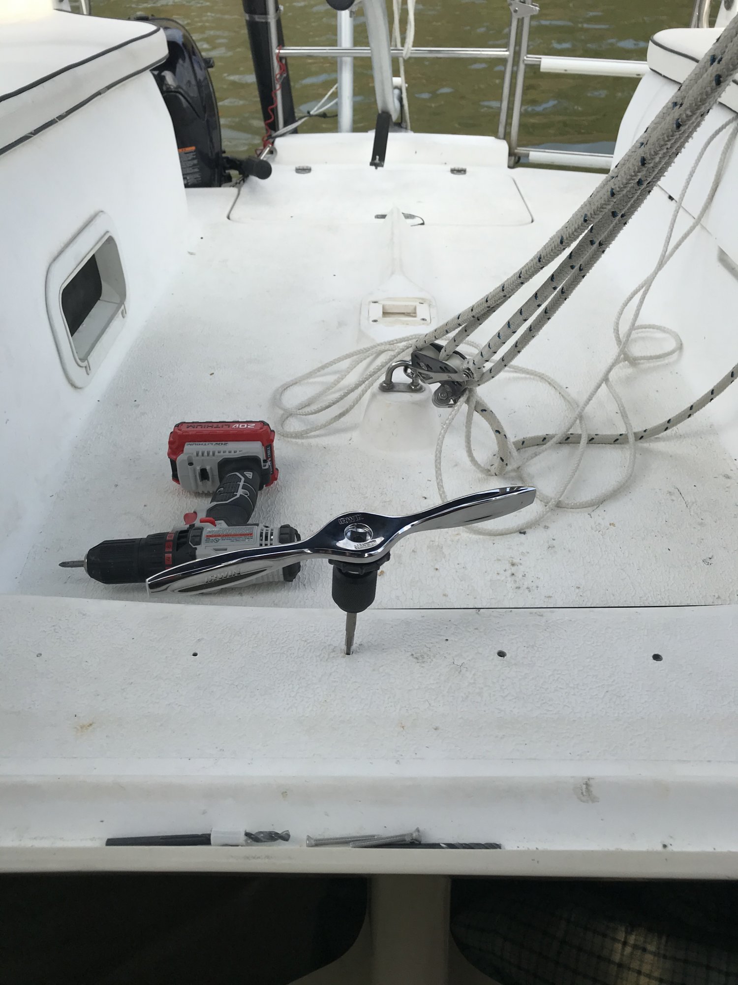

Ouch, 5200 will make it near impossible to remove those screws. I would never use 5200 for a sealing application like that. 4200 maybe.
My thoughts too. Sooner or later that track will need to come off.
13,035
Yeah... 5200.... is what I used because my tube of 4200 was empty. It may turn out to be a learning experience.:facepalm:
14,188
This poses an interesting ethical problem. Do you remove the traveler, clean it and rebed it with 4200? Or leave it alone, hope you never have to remove the traveller and let the next owner deal with it? If you go down the leave it alone route, do you inform potential buyers?
I think I saw this on an episode of The Good Place. ;)
13,035
Okay okay... now just to be clear... I did not bed it with 5200. I bedded it with butyl tape. I only put a dab of 5200 down the bolt hole. My thinking was that it will dry hard and act like threads. I should (I hope) be able back the bolt out. I would have used 4200 but my tube of that got used up when I installed my new deck organizer the week before. Now that I think on it more, I maybe should have rubbed some soap or oil on the bolt before I sent it down the hole so the 5200 could not bind to the metal. Just to put everyone's (and my) mind at ease, I will try to torque one of the bolts next time I'm at the boat. :thumbup:
