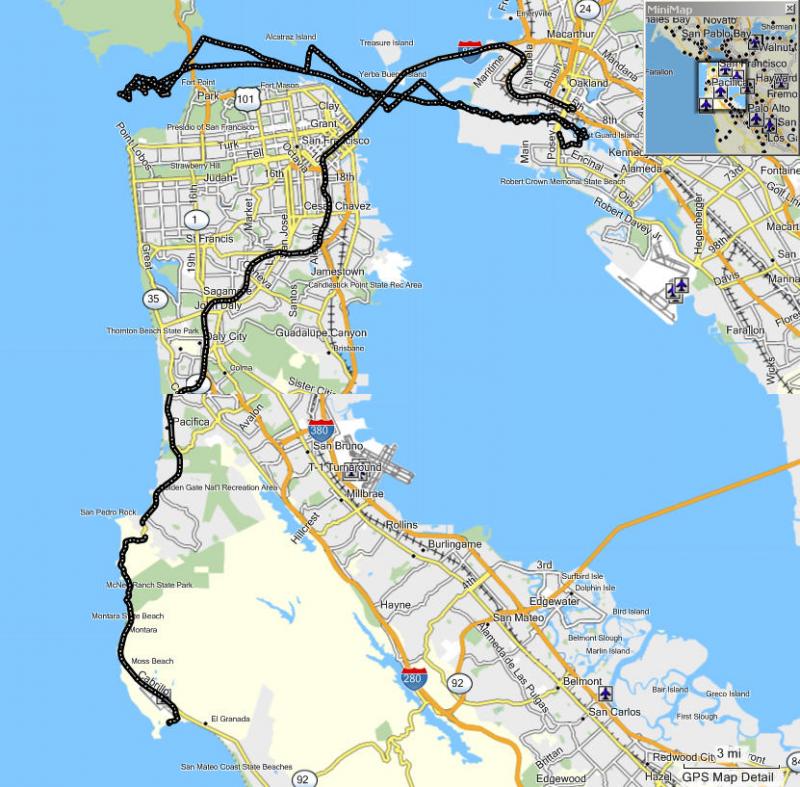

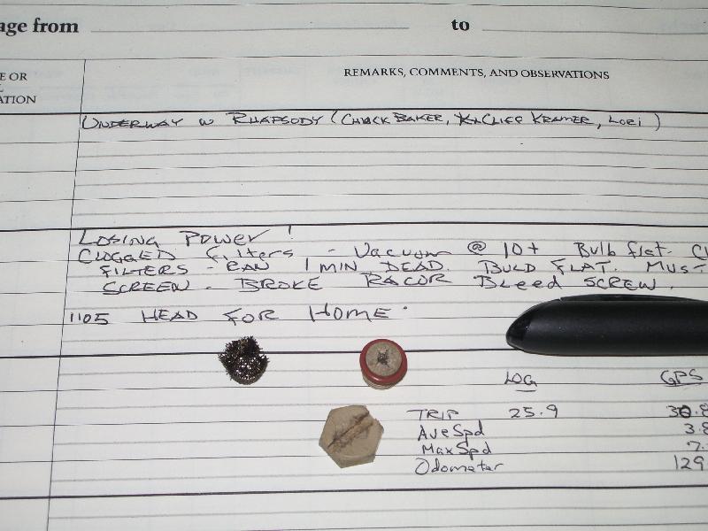

Been there done that in the same spot! I don't know if this applies to you, but my fuel pickup tube had a small screen crammed about an inch up from the end that clogged when we were sailing to Half Moon Bay in Sept. 2010. I wasn't able to figure that out while bobbing around just past the bridge although I had a couple of clues that later should have alerted me to the real problem. Instead I changed the filters and snapped off the plastic bleed screw on my Racor. That ended the trip and we had to gybe about a hundred times back to the Oakland Estuary against the ebb. See attached pictures for the screen and the gps track including how we finally got to Half Moon Bay to meet up with the rest of the fleet. Might be worth checking the fuel pickup tube.

Ah, then my screen was an "improvement" to the design!:cussing:

65 mph hard to weather all the way!;) Good luck with the fuel situation. A vacuum gauge is a good diagnostic tool to have in line. That will tell you if the source of the problem is a clog.
I have always wondered about the theory that crud in bottom of the tank gets sucked up as the fuel level drops. All the fuel pickups I know of draw from the bottom anyway, so crud, if present, should be a problem always. Air in the system sounds more plausible at that point, especially considering where you were in that washing machine area. Again, a vacuum gauge would help determine that.
Allan
