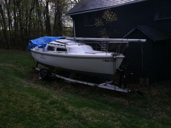

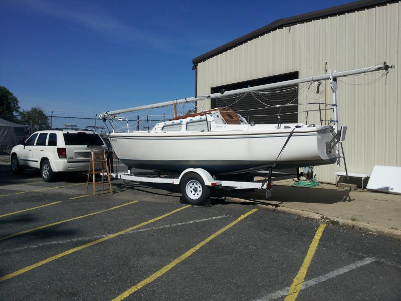

Hello again everyone, my days at work have ran into the night the past few days so no further progress has been made, but tomorrow the mast goes up and the old plywood comes out and I will be ordering the teak hatch boards from d&r marine since I cant find any other hatches for her. I was wondering if anyone had a photo or something of what the 1974 oday 20's rigging (masthead I believe) looks like when its all set up and the base of the mast when its in the tabernacle since I don't really know what would be missing lol thanks to anyone who can respond, and check back in tomorrow for more picture and status updates!
