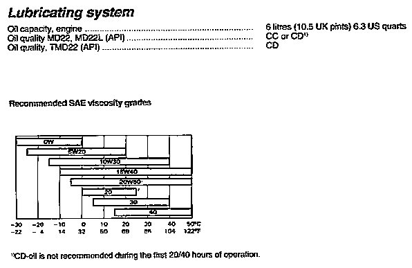

Oil weight??
Rich,
I have the same engine you have and I noticed that you use 30wt?? I was going to change my oil this past weekend and noticed that Marine Parts Express sent me the wrong filters, (have reordered) my question to you as I know you have had your boat for a while 1997, have you always used 30 wt?? which is what i used on my old boat a 1993 37.5 with a yanmar,(had for 16 yr's no engine problems) sold it and bought a 97 40.5,
but i think the engine manual ( if you want to call it that) specified 15/30 wt?? I think?? Any comments??

I have always used straight 30W weight oil that is diesel rated. According to the Owners Manual for the MD22 and the Instruction Manual for the 22 Series, both have the attached oil weight chart. The 10W-30 and 30W are both good up to 104 degrees F, but the 10W-30 is good down to about 0 F while the 30W is recommended down to about 41 F. I stop boating long before it hits 41 F and I think that a straight 30W is a more stable oil than a 10W-30. The explanation that I have heard 30-40 years ago (maybe it doesn't still apply) is that a 10W-30 oil is really 10W oil with additives to keep it as thick as 30W when it is hot. They used to say if the additives broke down, all you had was straight 10W oil. That is why I use the straight 30W.
For my Westerbeke genset the recommendation is 30W, 10W-30, or 15W-40 above 68 F, and 10W-30 or 15W-40 between 41-68 F. I guess I should have been using 10W-30 or 15W-40 in that engine but I have still always used the straight 30W in my genset as well.

101
Hunter 40.5 New Bern NC
Thanks Rich,
I'm going to stick to 30 wt. as well.
