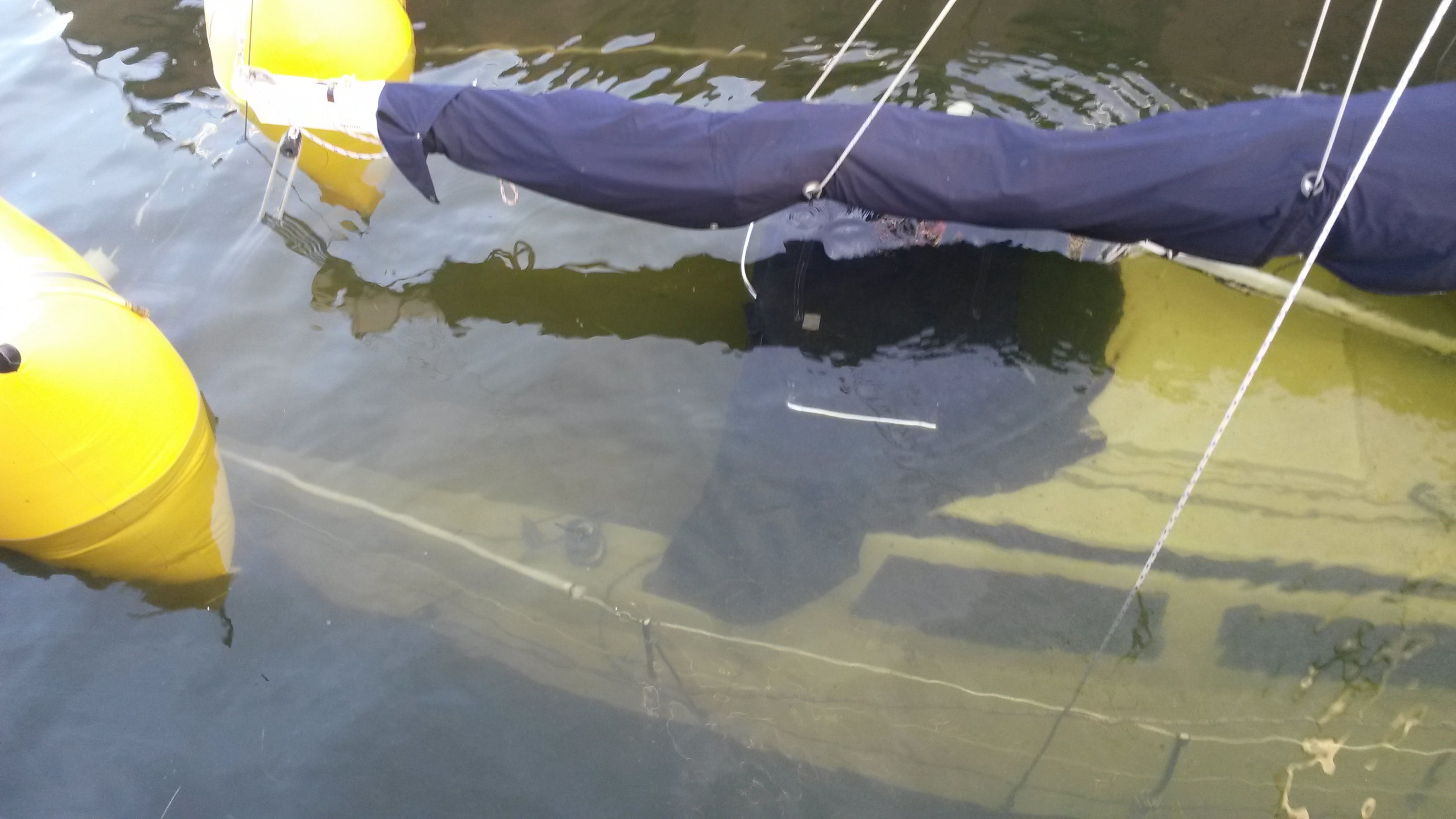

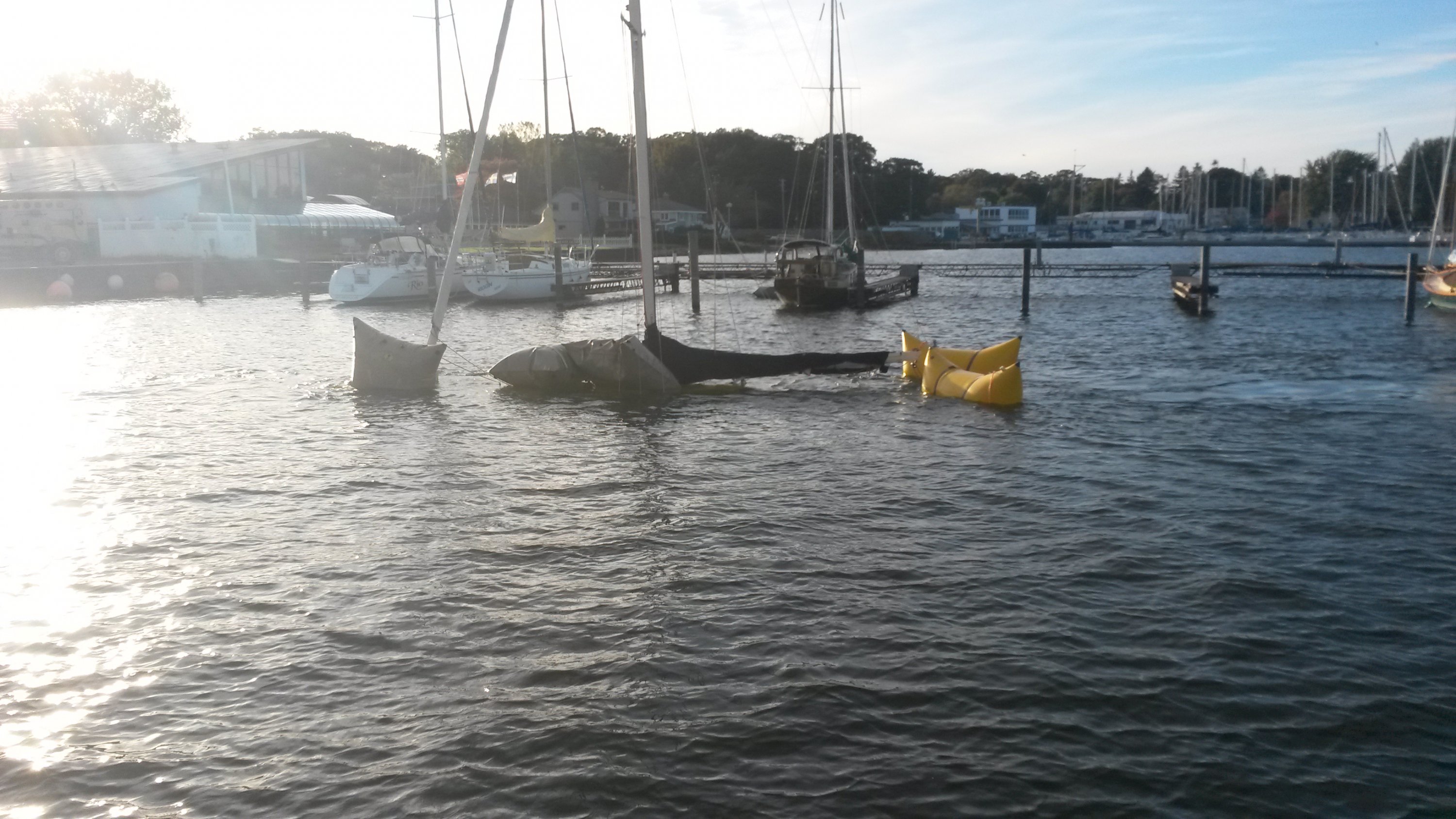

My boat sank today

We are at blufton moorings in front of torresen marina....apprently ours is the third boat in three years to sink in the mooring field

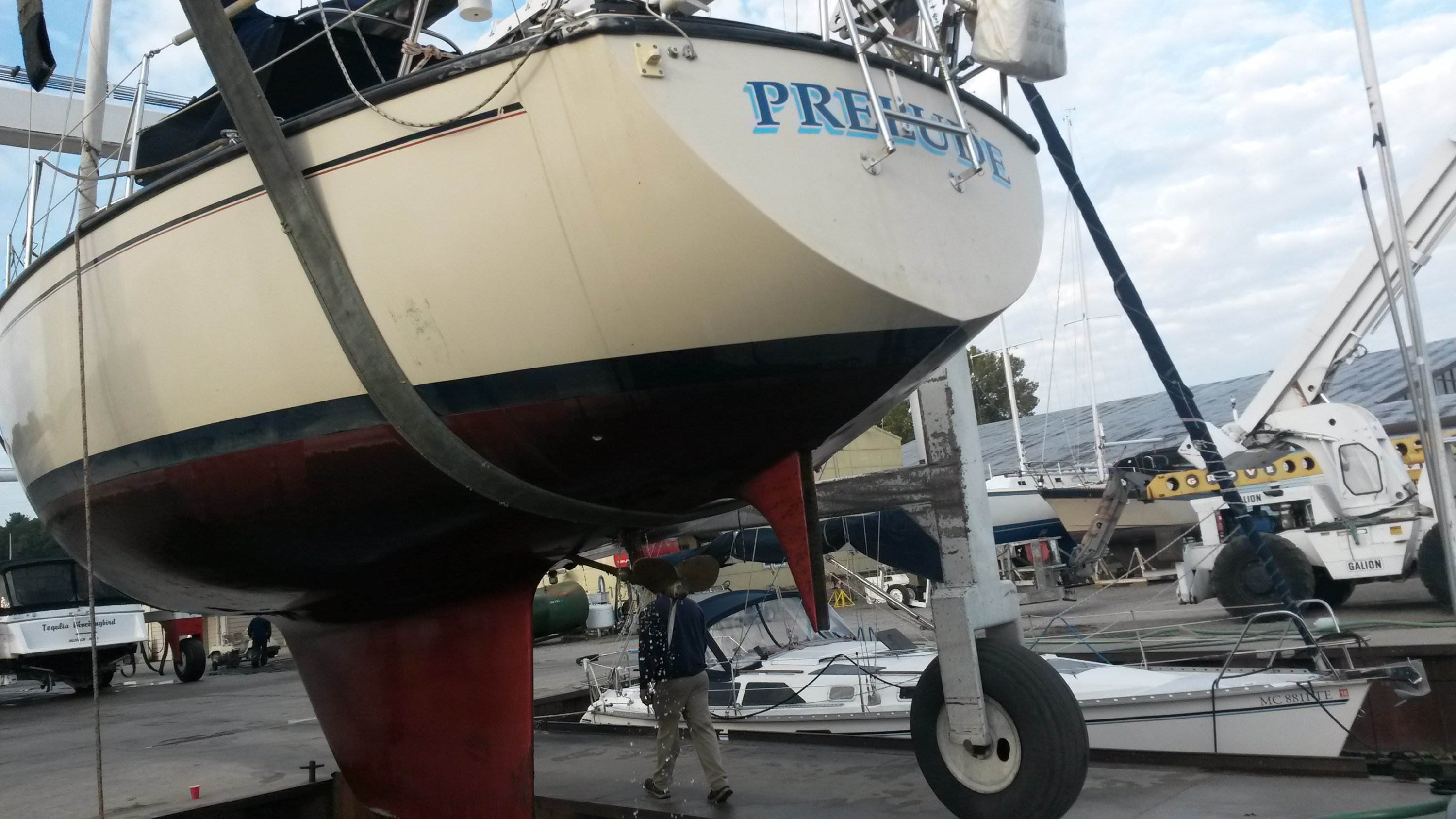

So the boats out of the water....and the newly repaired rudder is missing. The rudder was dropped out and repaired in june of this year prior to launching. The invetigator/surveyor for the insurance company says that the rudder was only held in by a single press fitted pin. So the thoery right nkw is that the pin worked its way out some how and then the rudder dropped out of the boat. S2 9.2's were not designed with a fiberglass tube that went above the water line that would have prevented the sinking. In the event that the rudder was removed. We are currently waiting for torresen marina to give the insurance company a repair cost quote, once the quote is recieved they will decide what they are going to do. Im going to try and post some pictures of the boat, as it was when it was recovered...also a friend of mine has started a go fund me page for my wife and i will post the link below
10,249
Diver should be able to find the rudder pretty quickly..
You can probably install a tube on the rudder shaft ..
Tiller steered? Not familiar with S2 rudder stuff, but it seems like a through bolt would be more appropriate than a pressed pin in that location. on wheel steered boats, the quadrant would be through bolted ..
Sorry to hear of the loss.. Repair shop should be liable to at least help with repairs..
www.gofundme.com/8e63rmp4?pc=fb_cr_g.
my rudder has a bronze tiller arm that has a set screw in it that seats in a drilled dimple and key and keyway and is safety wired so it can not back out ...along with that the steering quadrant has 4 3/8 bolts that clamp the two halves together with a key and keyway i find it hard to have only a press pin being all that is holding the rudder in ....i think something was not done correctly/ or left off in the repair job....liability in my mind is for the repair people ....you may need to get a second opinion after all is said and done ...who provided the surveyor ? the repair yard i hope not you need and unbiased source here ....keep us posted to the findings and outcome plz...one other thing do you have tiller steering or wheel
Feb 6, 1998
11,772
Sorry to hear that. I would expect your insurer to go after the repair facilities insurance. The rudder should not have fallen out..

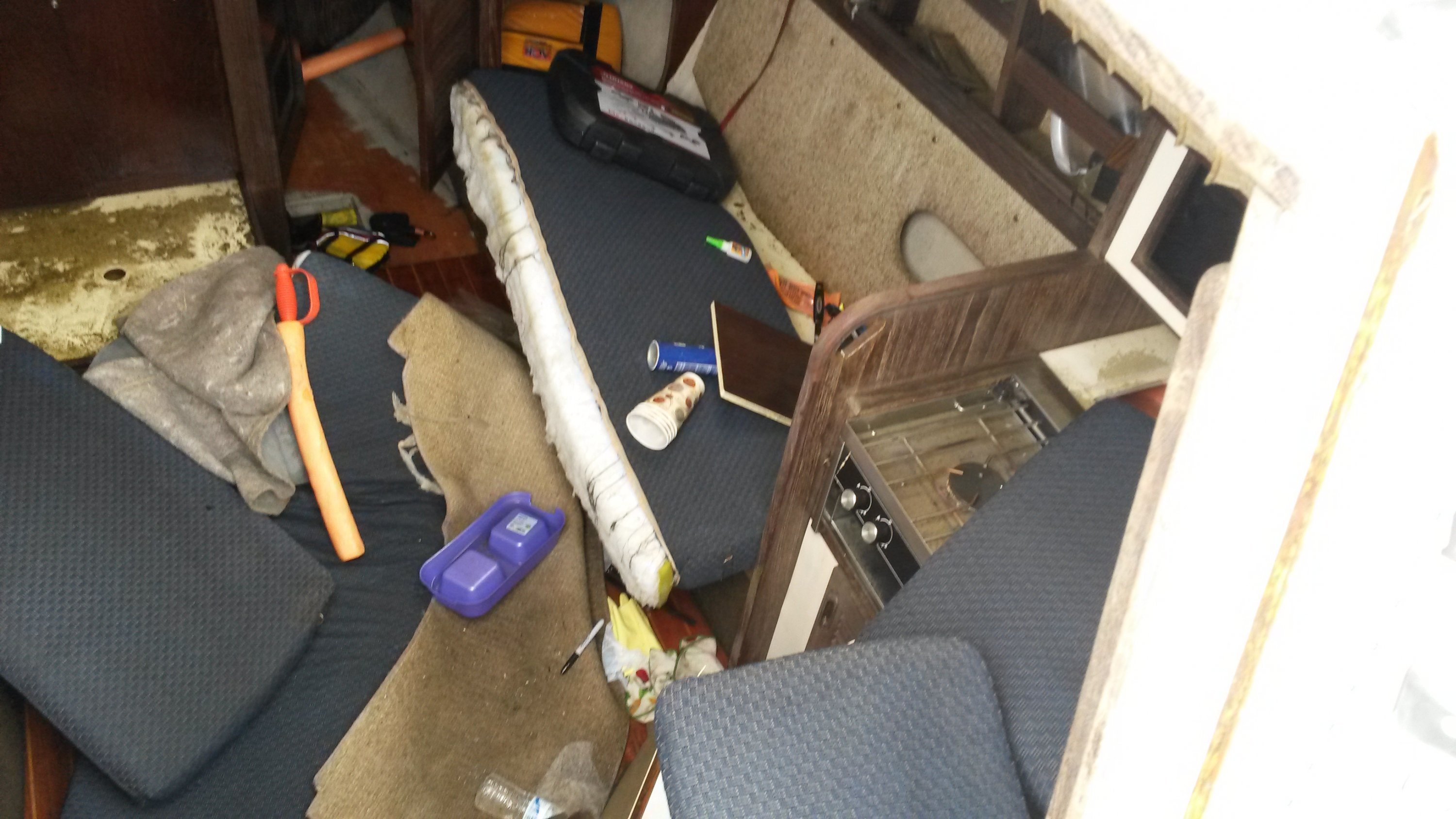

I don't know how to be any clearer but please, please, please DO NOT repair this boat. It is totaled and the deck repairs alone (every bit of core removed and replaced) will far exceed the value of the vessel and we've not even replaced 100% of the electrical system.. Take the insurance money and find a new boat.. Anyone who tells you that a boat that sunk, like yours, is repairable for the insured value is feeding you a pile of bovine dung...
As some folks know I'm not one to back away from a challenge but take Mainsail's advise. Not only will the deck core be soaked but the cabin top, settees, cockpit floor and cabin sole cores are highly suspect. Even I wouldn't consider this as a viable restoration project. Couple that with the electrical, and engine issues including every electronic gadget you have and I would hazard a guess the total loss value will be far less than the ultimate restoration cost. After that consider how long it will take to fully restore and you could be without a boat for years. Good luck and sorry for your loss.
