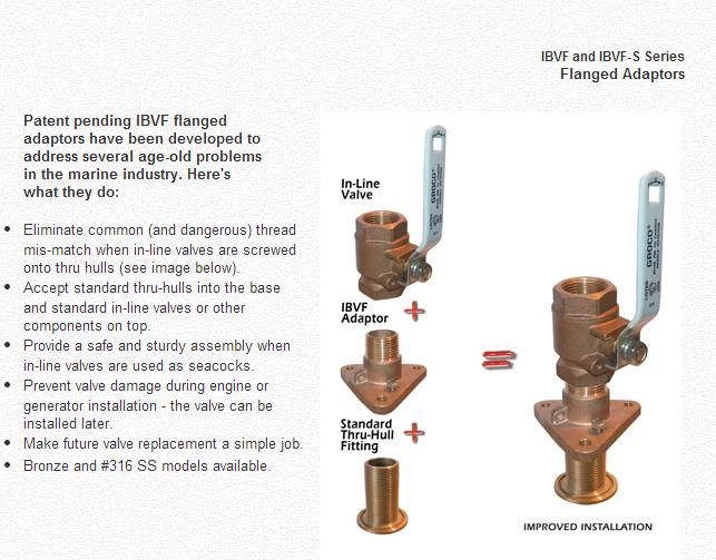

From one Michigander to another----this sucks. Sorry to hear this. It truly is one of my biggest fears only due to having 3 thru hulls. I am just curious, did you change the thru hulls or have somebody else do it? How were they installed, true seacock or a flange adaptor? Just curious because next week I am on vacation and replacing all 3 of mine with Groco back plates, flange adaptor, ball cock valves and Apollo 90 barbed fittings.

The thruhull for the head i believe is what you are calling a flanged adapter it is not a true seacock...the valve was closed when we left the boat....the other thruhull that was below the water line was the water intake for the engine, it was just replaced in late june early july by staff at the marina where we purchased the boat....we have a manual flush jabsco head.
I'd like to see a picture of that "flanged adapter." Both the intake and any discharge thru-hull for the toilet--in fact EVERY below waterline hole in the boat--should have a "true" seacock on it. The make/model of the toilet has nothing to do with that.
Sep 28, 2008
922
Canadian Sailcraft CS27 Victoria B.C.
There is nothing wrong with a bronze flanged adaptor and ball valve. This is what they are:
