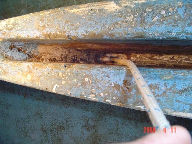

Hmm now that I think of it when replacing the cable and getting my eyeball looking up into the tube it had a slot that yes the cable has a small sheave and I guess thats where it lives when the board is up.
I also should note to others with this set up that right above the sheave where the cable crimp is is the spot where the cable fails cause the board moves while sailing and thats where the cable gets the most fatigue.
The last time I replaced the cable (spring 2009) I installed a foot extra so this spring I'm going to cut 6 inches off at the keel end and redo it with a new sheave and crimp and thats when I'll take some better photos cause this subject has come up many times
