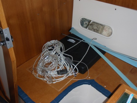

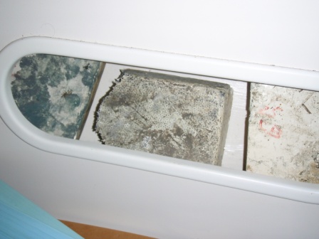

Lead ballast - Port side
Hello Witzend:
I visited the yard yesterday to check on the winter cover, etc. We had high winds with gusts to 80 knots here on Friday.
While I was there I took pictures of the lead ballast described in my earlier post.
Dec 25, 2008
1,580
catalina 310 Elk River
Are these lead blocks just lying loose? If so just remove them, to help level your boat.
Not sure why they would be there in the first place?
Jul 16, 2006
92
-Catalina C310 RNSYS
Yes, the blocks are loose in the cubby hole. However, they would not be easy to remove. I have always thought they were placed there during the newbuild by Catalina. Perhaps I am wrong but I thought they put every new boat in a tank to assess the trim and list and added ballast accordingly (I read this in a magazine but perhaps it was for a different manufacturer).
To be honest, I have never had any concern about the boat listing to port. It was DoctorSail that originally posted concerns with list to port.
I am in the process of replacing the water heater which is located to starboard of the centerline. Originally, I was going to go with a six gallon heater instead of the OEM installed 20 gallon heater but decided to go with the latter. The difference would have been approximately 120 pounds less causing the boat to list more to port.
In the spring after I launch the boat I will look at how she sits in the water. Perhaps I have a port list and never noticed it.
