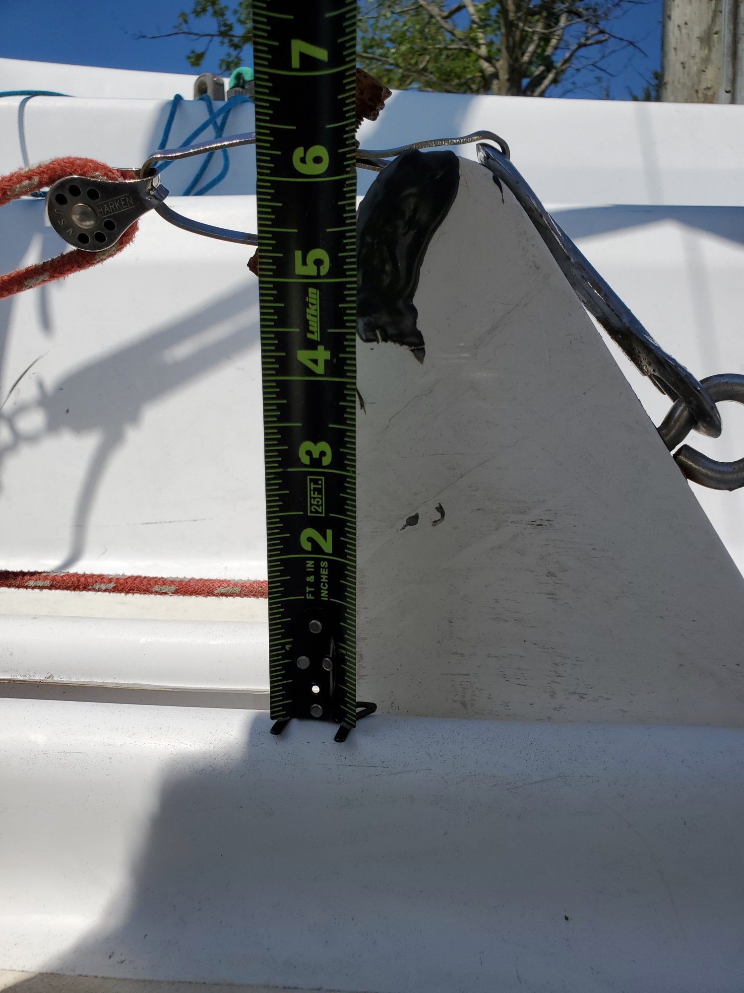

The lifting point on the centerboard gave way - seems to have torn out. It was patched up, but not restored. See the JB weld in the attached picture. The previous owner added a great big eye bolt to lift the centerboard...
The stainless straps from the factory allow for a block and probably better distribution of forces.
I could drill a hole and mount the same straps further back, but I am afraid of them tearing out again. Would you do so after reinforcing the centerboard? I want to go back to something resembling the original strap system.
I have considered other ways of attaching a sturdy lifting point -
- sandwiching the centerboard with 2 to 3mm stainless plates (could also go with glass and epoxy) and drilling a mounting hole behind the original hole (behind the JB-weld).
- adding a 2 to 3mm stainless strap that wraps around the narrow dimension, from the pictured eyebolt, to the opposite side and drilling a mounting hole behind the JB-weld.
- attaching one half of a stainless steel strap hinge to the centerboard for use as an anchor point.
