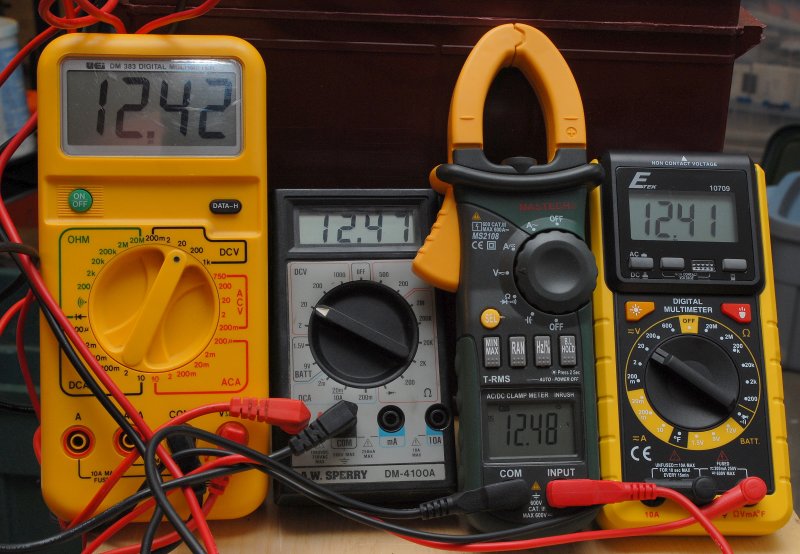

Accuracy????
A slew of cheap meters all connected to the same exact battery.. Hmmm.....

Jeeze Mainsail you are like a man with 2 watches, never sure what time it is:D
I would say that if you need absolute measurements, for power consumption calculations etc, spend the money, if you are troubleshooting, and all you are looking for is the difference between readings, get a cheapo, as far as finding lost tools the day after you buy a replacement, it always works that way. :doh:

BTW thanks for reminding me that I need to get one of my my Fluke's back from my dad.. I think he's had it now for about 8 months?? I bet he remembers when it was the other way around, me borrowing tools from him..
On a meter that does not run out to the hundredths, like a Link 10 or Xantrex XBM, that represents the difference between 12.4 and 12.5 volts. If looking for a milliamp voltage leak, as I was the other day with Tim R., that can be a decent difference.

The real question is what is the actual voltage of the battery in question? 12.415 volts, or 12.475 volts... or something in-between???
My point exactly... The Mastech and A.W. Sperry are usually the closest to my Fluke, but not quite (Fluke is NIST calibrated), and the Mastech and Fluke occasionally agree out to the hundredths.. In defense of the UEI it has been dropped to many times to count. As for the other meter, reading 12.41, the Etek, well.... you get what you pay for.
EDIT: My Mastech has literally fallen apart over the last year. It will no longer zero, the clamp jams, the light died and its calibration has drifted. So much for a cheap "DC clamp"...

Significant digets
Way back when dinosaurs roamed the earth and I went to high school we learned about a curious thing called the number of significant digits. MOST engineering only uses 3 significant digits so I'd say they are all in good agreement with 2 reading over the third digit and 2 reading below it after rounding.
That 0.02 volts could easily be the connection of the probe and not the meter proper Try going to a lower voltage scale to shift the significant digits to the right. Course you are still measuring 12 something so that is always going to eat up 2 of the digits.

there are other factors to consider in connecting a voltmeter...
Main Sail's picture points it out....
a - there is the lead length and connection to consider. Lead lengths can matter. Higher end voltmeters will have a "zero adjust" to let you "factor in" the connection length of wire and end connector type... the "Sharp pokey" type probe will not be as accurate as the more sophisticated clip or 4 wire type attachment.
b - each position on a DVM can have a different "zero point"... I have goofed before where I would "zero" with one setting - and then change to another... only to find out that is was off being "zeroed"...
c - the DVMs themselves will vary on the last part of the precision... if you want 3 digits of accuracy - then get a 4 digit meter..
d - temperature and aging do matter... so occasionally compare against a known reference if it matters...
with a lot of electronics now, the extra precision is very achievable... but - like the analog meters - you still have to consider the system you are measuring and how you connect.
It could also be that leakage will diddle your readings.. so isolating the device under test is a good thing... if necessary....
