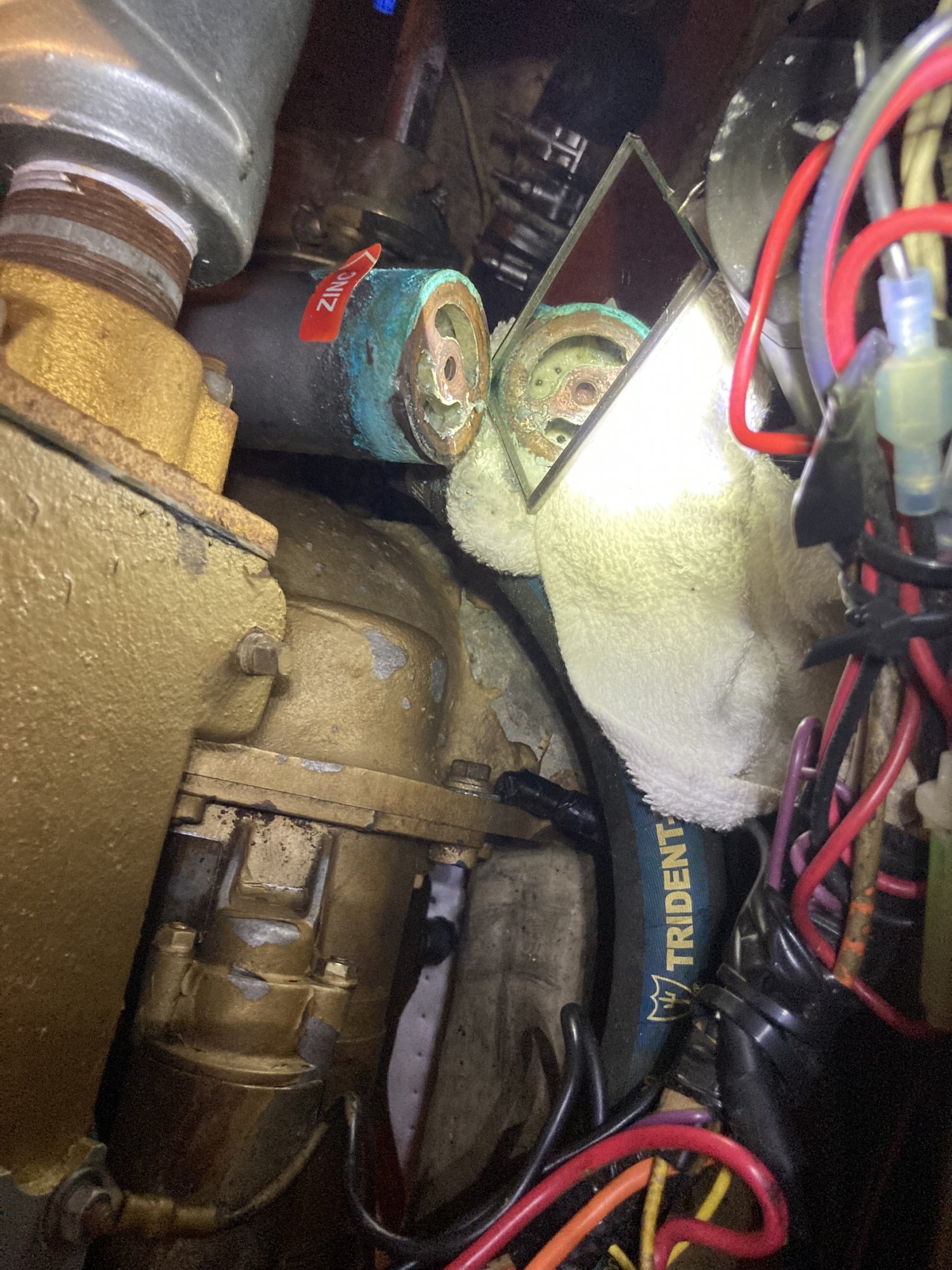

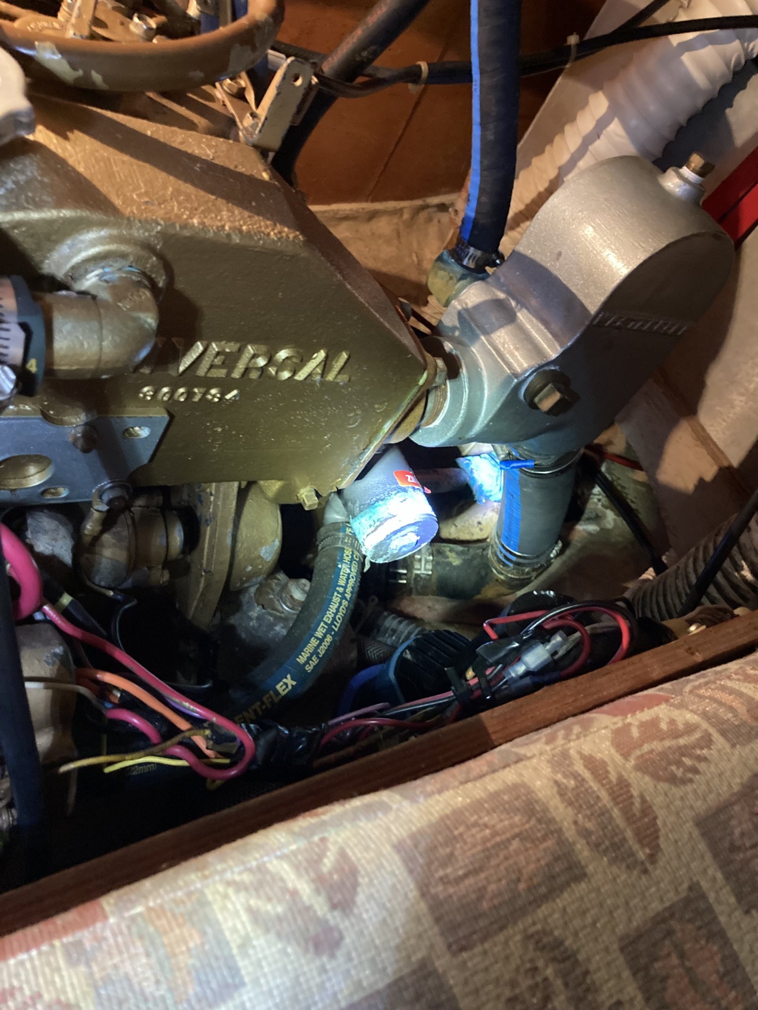

I installed new Mr. Cool hx in October of 2021. Universal M18.
In 92 engine hours, the tubes are already constricted with calcification, and the engine temp is trending up. Also the exterior case has bubbled some.
See pics. The one showing the calcified tubes is via mirror, so it might look optically confusing.
Zinc is kept fresh.

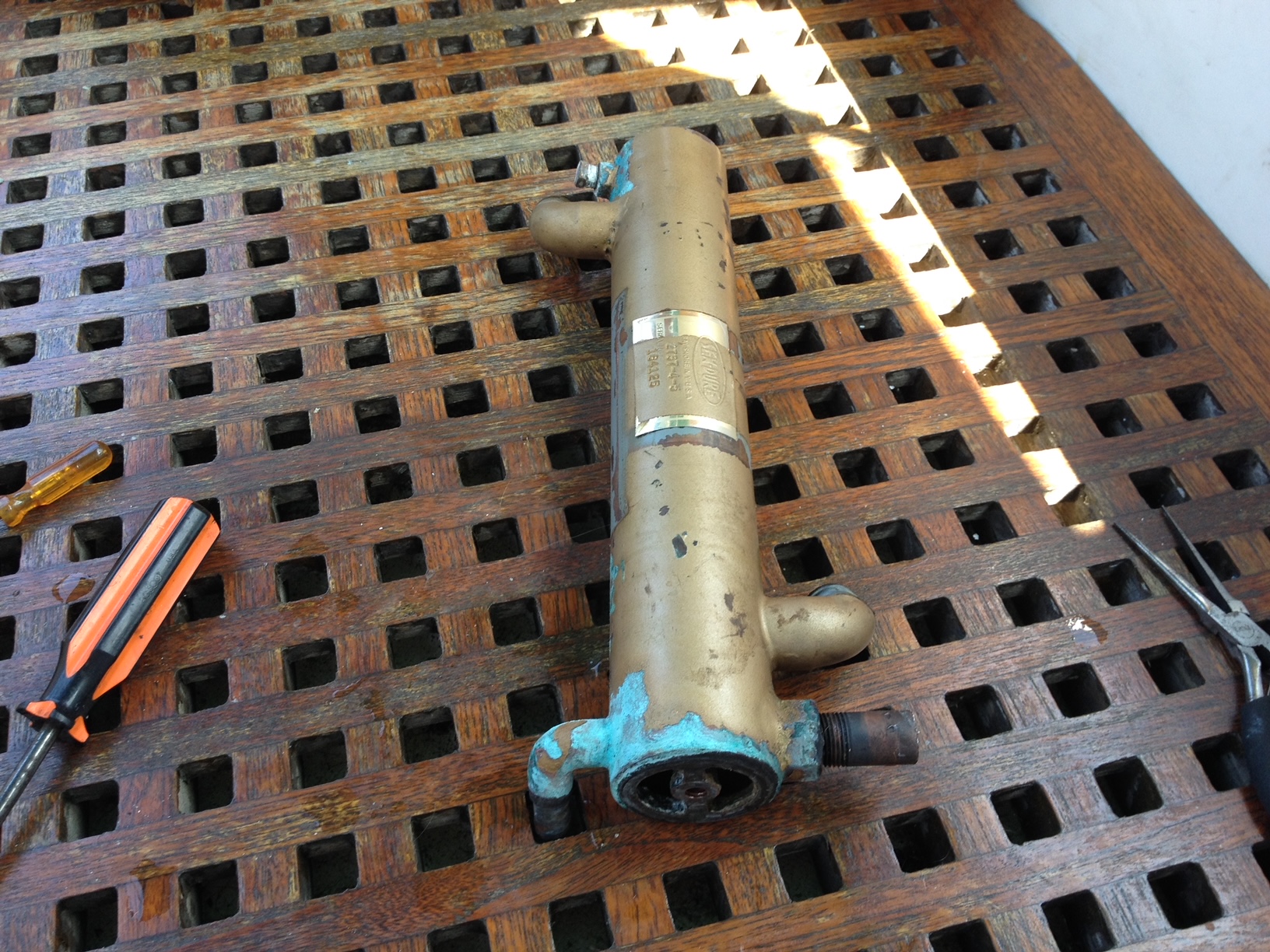

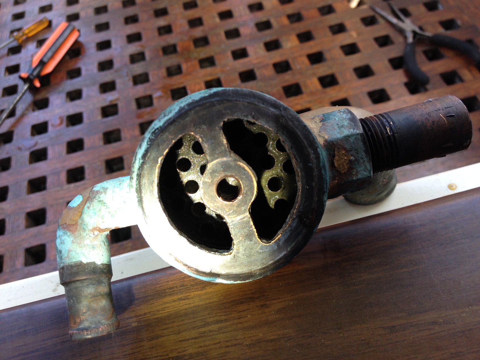

I have also included pics of the original 1984 Sen-Dure HX (gold color). The tubes were clear when I removed it for replacement. Even after 1,487 original hours.
I replaced it for several reasons. It was a 4 hour job. And cost $300
So how does the Sen-Dure last 37 years and 1,487 engine hours, and the MrCool lasts 3 years and 92 engine hours?

Any ideas? Are the tubes smaller?
