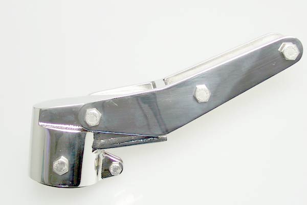

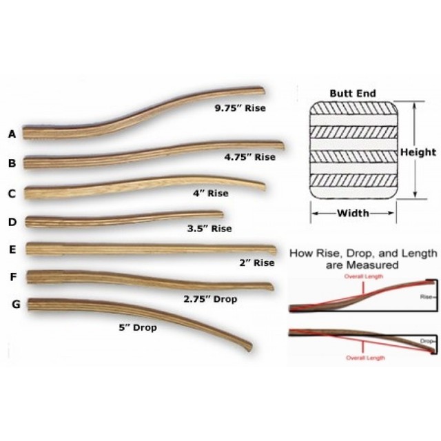

Sails...….. no....
Tiller handle..... maybe, not likely... Catalina 27 has 6 in. drop. Item G in chart.
Catalina 22 has 4" rise item C in chart.
The difference is the tiller head (bracket)...….. a new tiller head from CatDirect $599.
