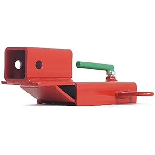

My O'Day 25 plus dual axle trailer is somewhere in the range of 5500-7000lbs. I have access to a propane and an electric forklift. I was wondering if a typical forklift would work to move the trailer into place within the lot if I used something like this? Total distance to maneuver would be 500-1000' with very mild slopes in the asphalt.
Titan Attachments Clamp On Forklift Hitch Receiver Pallet Fork Trailer Towing Adapter 2 Insert

I’ve driven a number of forklifts so have little doubt that the machine is capable.
Hard to tell from the photo but I would be careful when you first start to move the machine backwards - trailer forward. The strain is all on the chain and the friction bolt holding the device on the end of the fork. If they slip or fail you might have the trailer rolling with no control :yikes:

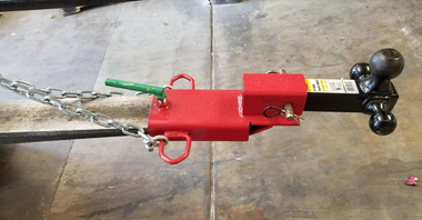

Moved lots of trailers with bobcats configured with forks in that very setup. Most trailers in use with boats loaded.

I want to add that your limiting factor there will be only using one fork to do the work. This will lower the load you are able to support with the forks. It would be better to get a hitch that fits on both forks-that will also allow you to align the boat with the centerline of the pit.
I'll assume the bolt has virtually no effect on side to side movement when moving 5000+ pounds, I'll either use chain or some large ratchet straps to keep it in place
My boat is stored at a shop that does this as well. I assumed a Bobcat was much more powerful than a forklift
I don't know if I'm an expert, but I have been an OSHA certified corporate lift truck instructor (train the trainer for my company) for years and I have participated in several lift truck accident investigations.
I'm also seeing this style of attachment. Might make things more stable since the weight would be closer to the forklift. Thoughts?

As a former dealer I moved trailerable sailboats by tractor//forklift using the same set up and chained up as shown. I have done that as well moving larger boats on trailers up to 34 feet. The only caution, do not turn the trailer too sharp particularly with a load or the beads or wire can separate
I've only owned single axle trailers in the past. I love the fact that I can get super sharp angles while turning. I remember the first time I moved this one I looked back and to my surprise the tire looked like the bead was about to pop off the rim. Thanks for the confidence and words of wisdom!

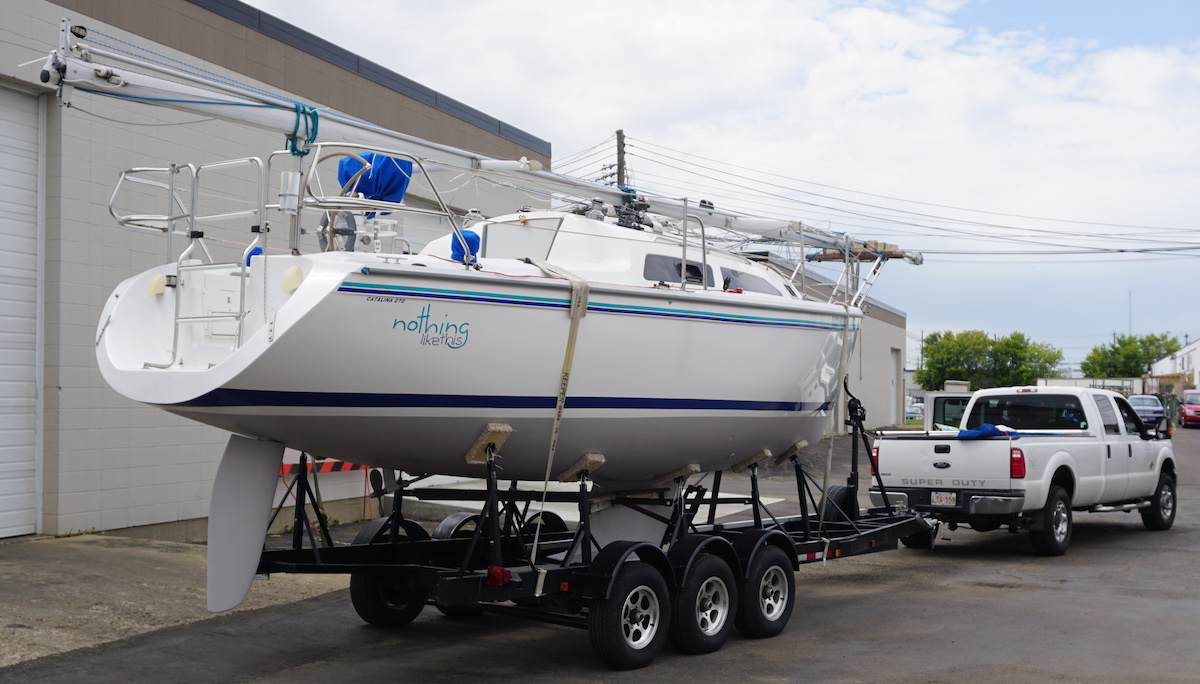

The only difference between single and multiple axle installations is the amount of attention that needs to be as the axle count goes up.Three axles is not a huge deal, you just have to think about it a lot more.
Nice looking boat Meriachee! How does it require more attention? I assume turns must be done a bit wider with more axles
