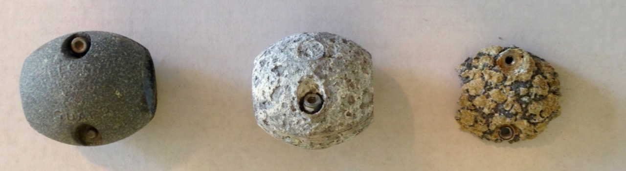

You'll need to replace the zincs with sacrificial anodes that will work in freshwater, i.e., aluminum or magnesium. Here's a photo of 2 anodes from a freshwater boat, zinc, aluminum, and magnesium from left to right. The zinc and aluminum are after 1 season, the magnesium after 2 seasons.
They all started the same size, for a 1" prop shaft. Remember the operative word in sacrificial anode is sacrifice. If it isn't eroding, then its not working.
Is that a standard spacing of the attachment screws?
Yes. The anode size is determined by the shaft size. These mount on the prop shaft. A good source is Boatzincs.com
