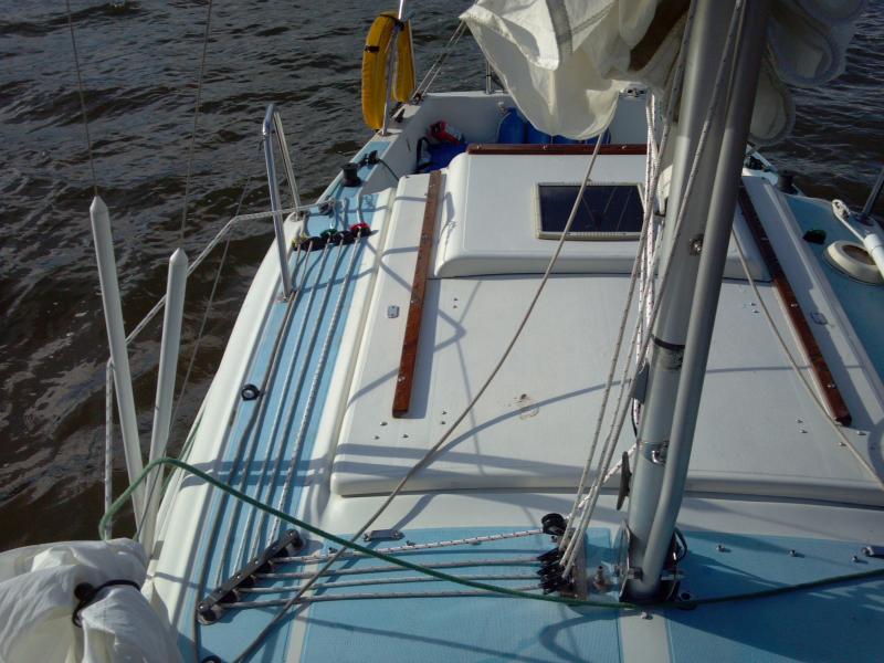

It's becoming a little daunting at my age to go to the mast and raise the main when the winds blowing and the boat is pitching. The non-self-tailing winch on the mast means that the Admiral is there to do the tailing, as we are both holding on for dear life, while the auto pilot is trying to keep us headed into the wind. There has got to be a better way.
Have any of you O,Day owners routed the halyard to the cockpit? If so, how did you get through or over the coaming? Once through the coaming there is plenty of room under the dodger for a clutch and winch. Not sure where or how is the best way to attach a block to lead the line aft.
Another option would be to replace the mast winch with a self-tailing one.
Or I could just have a stainless steel support structure installed at the base of the mast. The support structure would be a safe place to lean against and hold on to while at the mast.
