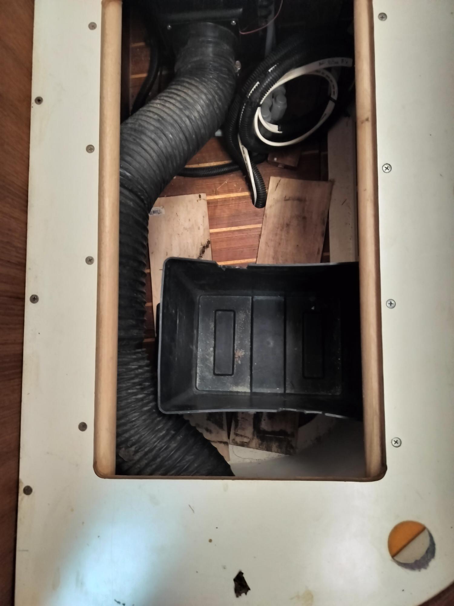

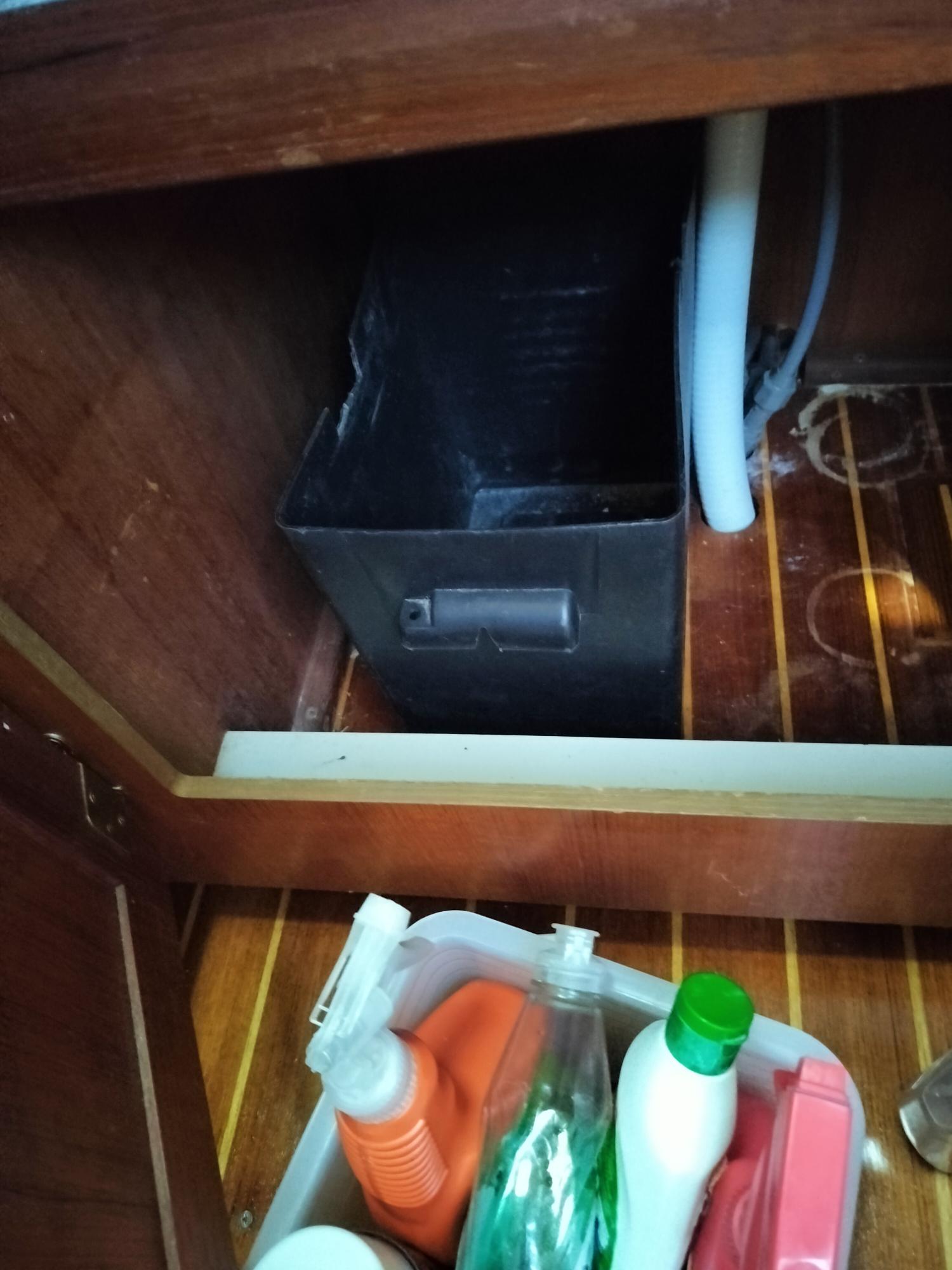

I've identified two other possible locations.
One is under the Port Settee. Problem is that directly under the proposed battery location is a sole piece that has to slide out to access the large center bilge
Right on the centerline so that is good but will make accessing that portion of the bilge difficult.
The other is under the galley sink. The sole there is fixed and I can attach secure anchor points for the 2 batteries. I will have to move the white drain line for the sink but that will not be too difficult. Just off center to the port. Only about 6 to 8 foot one way to the panel. Current battery to panel is over 20 feet one way.
Any thoughts?
dLj
Mar 23, 2017
5,256
I think putting in the bilge hollow would be possible but somewhat difficult. In fact, the starter battery is located on a fiberglass platform in the keel hollow (bilge) at the top of the third (aft most) portion of the very large and deep bilge that is formed by the keel hollow.. @Rick D do you have any info on how to contact the guy or where you saw the info? @dLj the keel hollow, which forms the bilge is about 4 feet deep by 1.5 feet wide by probably 8 or more feet long. It is a very big bilge holding about 360 to 400 gallons. Putting it there doesn't occupy otherwise valuable storage space. If I get that much water in the boat and my bilge pump won't keep up with it I'm probably in big trouble anyway.
Any thoughts?
I'd highly recommend reading the top three reports from 2024 here:
