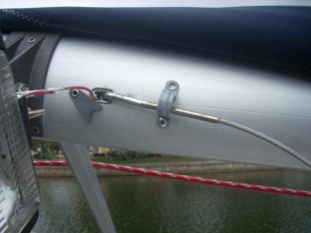

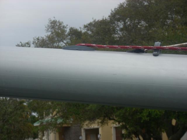

Each version seems to be slightly unique as the boat matured in its design but it's easy once you get it figured out for your model. We were stepping ours weekly at one point and got where it was a cinch. Be safe and take your time. It'll be the mistakes you make where you'll learn the best and remember the most. Hopefully they won't be too expensive but everybody has 'em.
One main tip from me would be to check the T fittings(if your ver. has them) on the top of the all stays at the mast to make sure they're seated right while raising the rig. I ended my stress by adding a pvc 2hole guide strap pop riveted near the head on each of mine. End of potential catastrophe.
Mike and Kelli
