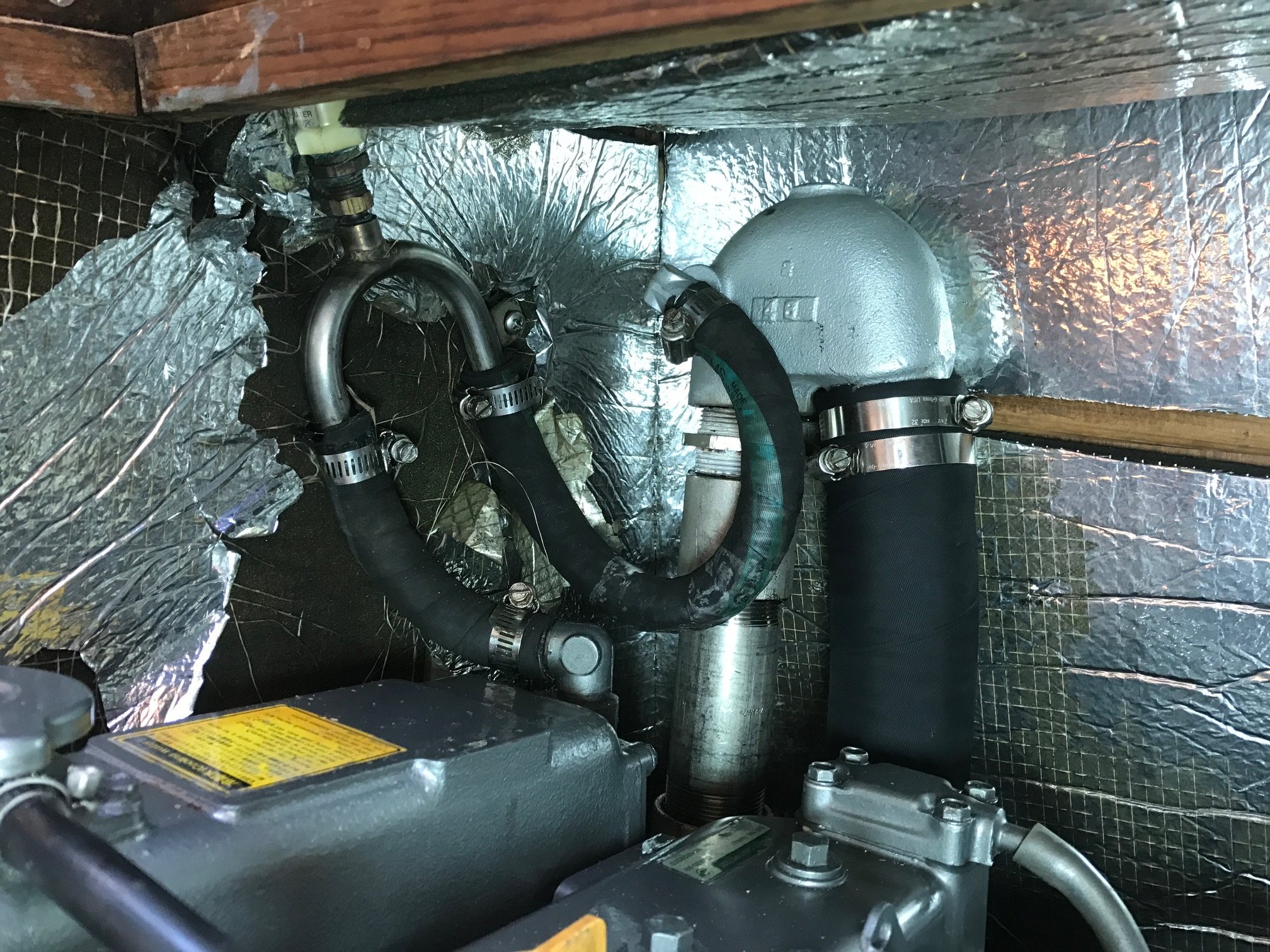

Just reinstalled my 23 year old engine after having a rebuild -the connecting rod was bent fairly severely- the engine guy believes that water got into the cylinder from being syphoned back in when the boat was heeled over. As such he added an extension onto the mixing elbow he is also recommending moving the vented loop higher especially since there seems to be a big dip in the hose from the loop into the elbow (See pics). I can move the vent but it will involve some surgery so before doing that I am looking for other opinions and no I haven't yet checked that the current loop is working.

I'd raise the loop any way you can. If the back siphon was through the raw water intake(which I assume it was), only raising the vented loop will prevent it re-occurring. Get it as close to the middle of the boat as possible too.
If the sea water entered the engine from back flooding through the exhaust, the extended riser should solve that.

There are really two parts to this some of which your photo does not show.
We cannot see the path from the mixing elbow to the waterlock muffler nor from the waterlock to the exhaust hose outlet. The path from the waterlock to the exhaust hose outlet (overboard) fitting needs to rise as high as possible (inside the boat) before descending to the exhaust outlet. To protect even more you can put a flapped fitting on the exterior of the outlet fitting or even fit a seacock (ball valve) at the outlet fitting which you keep closed except when running the motor. These things prevent water from backfilling the exhaust hose, flooding the waterlock, and overflowing back via the mixing elbow and then to the exhaust ports of the cylinder head.
The other section - the path from the cylider head to the waterlock via the mixing elbow (the elbow is the top of the loop in this section) - rises about as high as possible according to your picture. The higher the elbow above the waterlock, the more water the waterlock can hold before back flowing via the mixing elbow back into the cylinder head exhaust ports.
The siphon-break loop protects the waterlock from overflow on cold water side of the circuit. So the same rules apply. The loop needs to be as high as possible such that the top of the loop is as high above the boat waterline as possible. But you can also close the cooling water intake valve (except when the motor is in use) and that will certainly defeat any threat of a siphon or even heel induced direct flow.
The very best arrangement - but not always possible - is to make the rearmost exhaust hose section rise less than the mixing elbow. That way if the waterlock became flooded (like when the siphon break air valve becomes clogged) the floodwater in the waterlock spills into the exhaust hose and overboard instead of back flowing into the motor.

I may be wrong, but if the check valve on the so called "high point" vent is functioning, what I see will work. The vent should be above the static water line of your boat.
A siphoning back to the engine would be a rare event. Normally the high point is all that is needed.
The second there is negative pressure on the check valve, air is sucked in. No siphon.
I assume your water pump stops when the engine stops. and it is the standard flex vane pump.
I have never seen the reason for the vent break, if you have a seal loop in the muffler.
If I was in 10+ fore/aft seas I could see sloshing more that siphoning.

Stu's drawing is an example of an inherently dangerous design. There should be a riser at the mixing elbow elevating the mixing elbow as high as possible - just exactly the way nveater has already done.

When I read 'siphoned back in', I assumed you meant raw water siphoned from the raw water intake. If the seawater back flooded through the exhaust, then raising the vented loop won't help.
Perhaps the loop is high enough above the waterline, already?
And raising the riser would help the back flooding problem, but only to a point(adding volume capacity). You should eliminate that problem if it exists.
Your prevention from back flooding should be in the height of the exhaust outlet in the stern and a high loop just before it exits. Can you explain how the exhaust outlet and hose is set up? Obviously, you want to prevent a re-occurrence. :)

It is crucial that the air vent in the vented loop be checked to make sure it is not plugged.. In my opinion, the raised mixing ell makes the possibility of back flooding worse because a small amount of heel will cause the water to flow from the heat exchanger, over the loop, and into the exhaust hose, filling the muffler then backing into the engine.. A bunch of 335's work fine with no riser on the mixing ell.. I would kinda put that back to original condition and keep the vented loop as high as possible and make sure the exhaust hose has a high loop back at the transom. From the drawings submitted, you can see that the location of the mixing ell can (and should) be a good bit lower than the vented loop.
The mechanic also should have insulated the riser since it will be very hot and could cause some damage.. If ya look at the level of water.. The water in the mixing ell will be just above the exhaust hose clamps (internal casting wall) which is only an inch or two below the high spot on the little vented loop.. With the boat heeled over it wouldn't take a lot of pressure from forward movement to have the water go into the exhaust and back-fill into the cylinders..

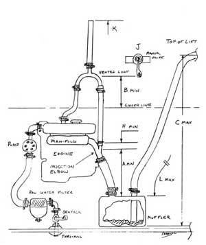

This is from my Hunter manual which includes the PLAN view (looking down) and the ELEVATION view.
@kloudie1 note the elevation view "Loop" prevents healed forward motion "water pressure" blow back, on my boat. That loop also provides the seal loop for the exhaust and causes the "burping" effect of engine exhaust, as the engine exhaust pressure "burbs out" the riser quench water.

So I have raised the vented loop- its now at the top of the companionway stairs about 33" above the static water line. I replaced the old vent with a new one- I did find the old one blocked after I took it apart- and I confirmed that my system looks like the Hunter plan shown in JamesG's post- Thanks for all the input that's why
