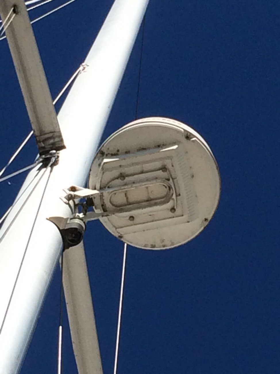

I want to purchase a new RayMarine Quantum 2 radar to replace my old analog Autohelm radar (see pic). I am wondering though if I can use the old mast mounting hardware with the new radar dome? Seems like this hardware is pretty standard/generic stuff? Have any of you done the same and kept the old mounting hardware? It sure would make things easier if I didn't have to plug old holes and drill new ones in the mast. Thanks.

You should be able to find bolt patterns for both radars online to compare. That mount will work, even if you need new holes.
You can get power from old harness, and is the new Quantum wireless?? If so no wire pull necessary.
The stern pole / mast mount is an old debate, trade offs on each position.

Yes the Quantum can run wireless which is why I chose it besides I do not have the room to squeeze in any more cables to my helm, (plus I am lazy). I will use the Quantum with my Axiom MFD which I installed last year. Since I already have the mount on the mast I will try and use it as well as the power cable from the old radar. In the manual there is something about making sure the wifi signal (dome on mast to MFD at helm) will be strong enough but of course there is an app you can use to check for that! I think I should be OK? So sounds simple. A couple of times up and down the mast (only half way!) All I have to do now is purchase the new radar and get started.
