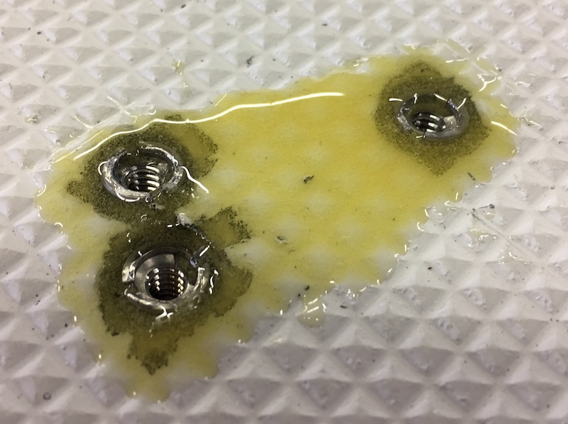

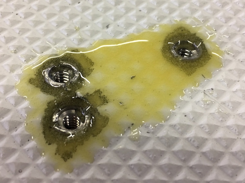

If you have wood between the cabin top and the liner, there is almost certainly a void in there, and one would suspect that the closer you get to the curve, the larger the void.
My opinion, the end game would be to fill the void(s) and maybe put in a stainless threaded insert. I used this method to great effect for a foot block on the Stb side aft where there was no access below. Holes were drilled, the area was wetted out (this was solid 'glass) tapped, and the inserts were threaded in, with the gap filed with Gflex toughened. You see the final product here. Then using 10-24 bolts, the block was attached. Strong, removable and solid as all get out.
